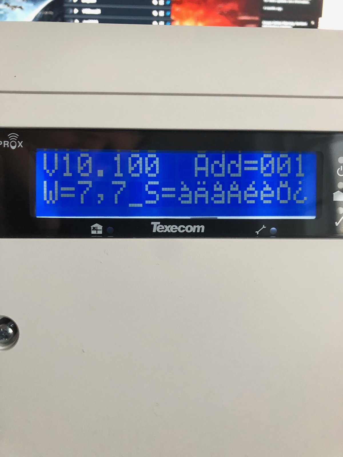

for some reason my panel is not loading, shows v10.100 Add=001 w-7,7_s been like this for hours

well when the keypad displays the version of the keypad and address, it suggest that it has power but there is an issue with T and R connections, is the correct cable on correctly.
show a picture of where its plugged in, its clear from the picture there doesn't appear to be a fault with the front cover, so suspect cable/ connection.
this was a cable issue, replaced and now fine, thanks.
