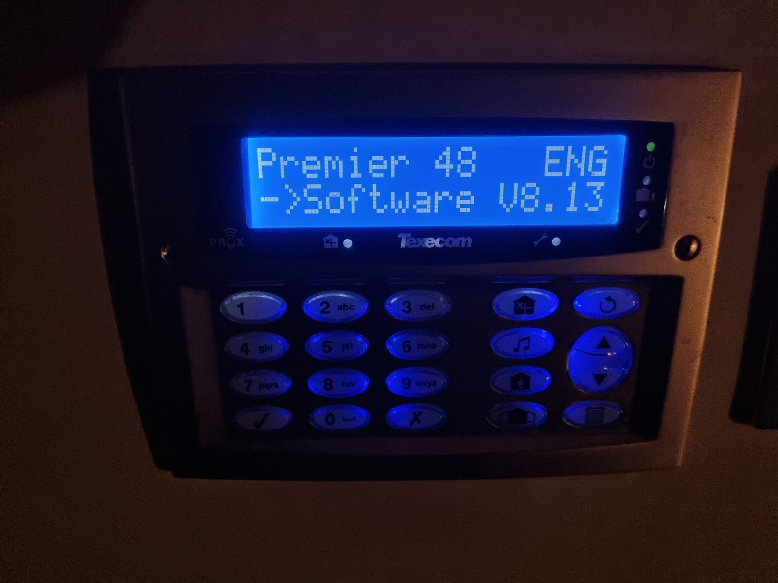

I have a Texecom Premier 48 alarm system that was fitted in 2011. The keypad shows firmware v8.13.

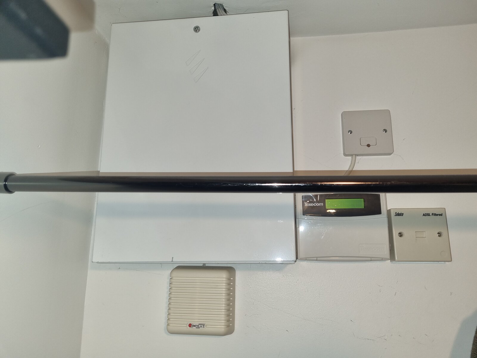

Looking up the 8xp, I can see it's an external box as per the pic. I don't have such a box so assumed it was a circuit that sits inside the case, a pic of my alarm attached.

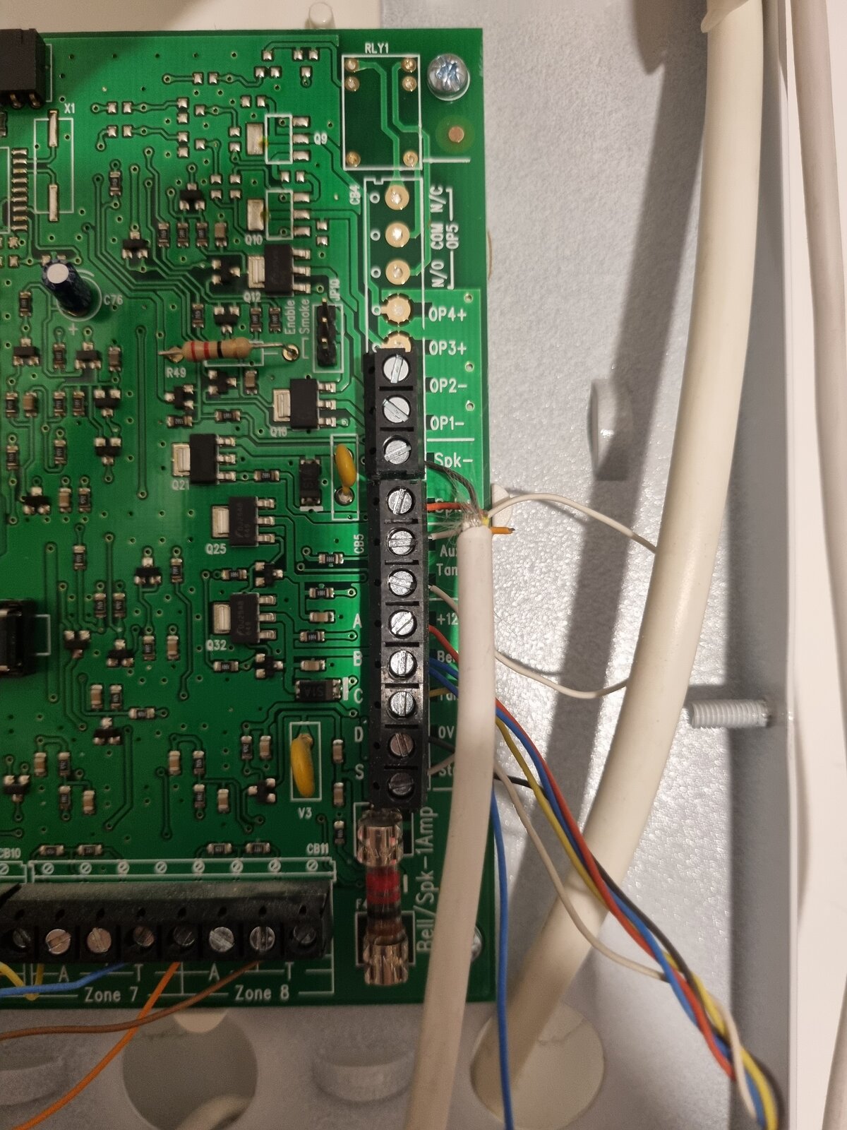

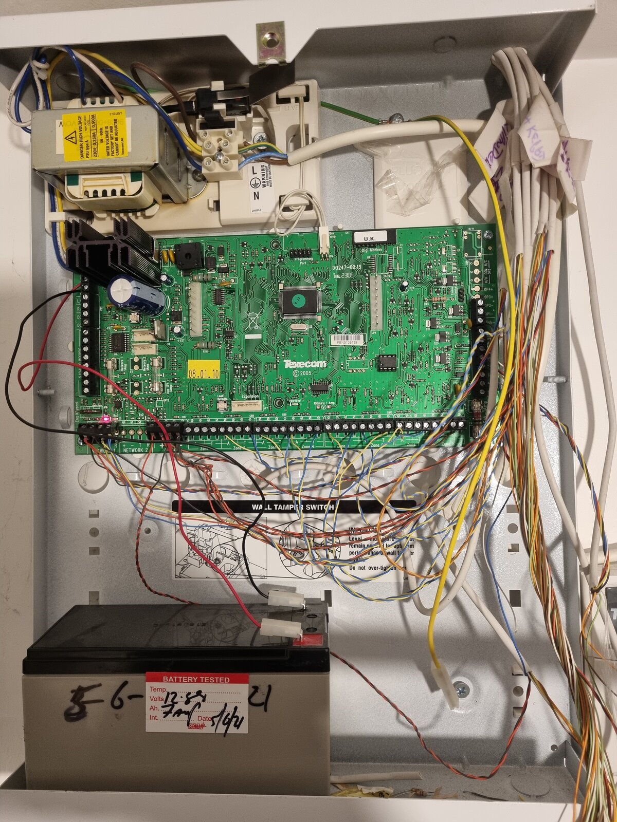

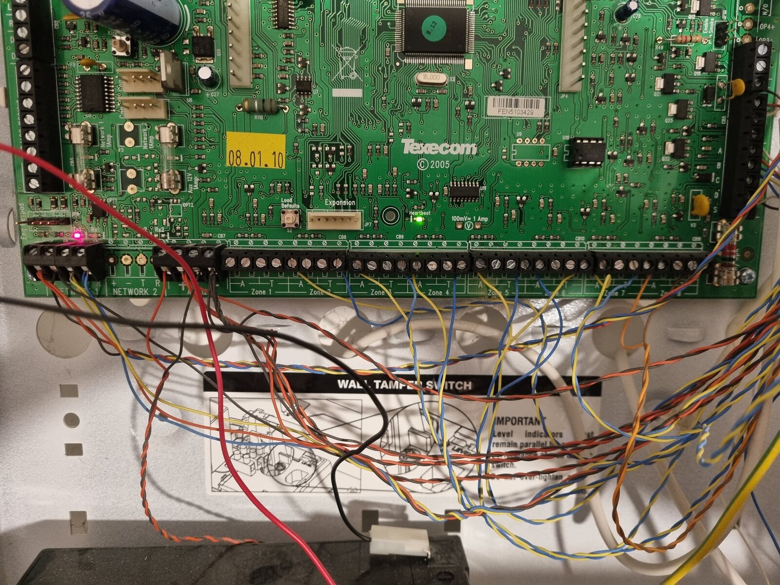

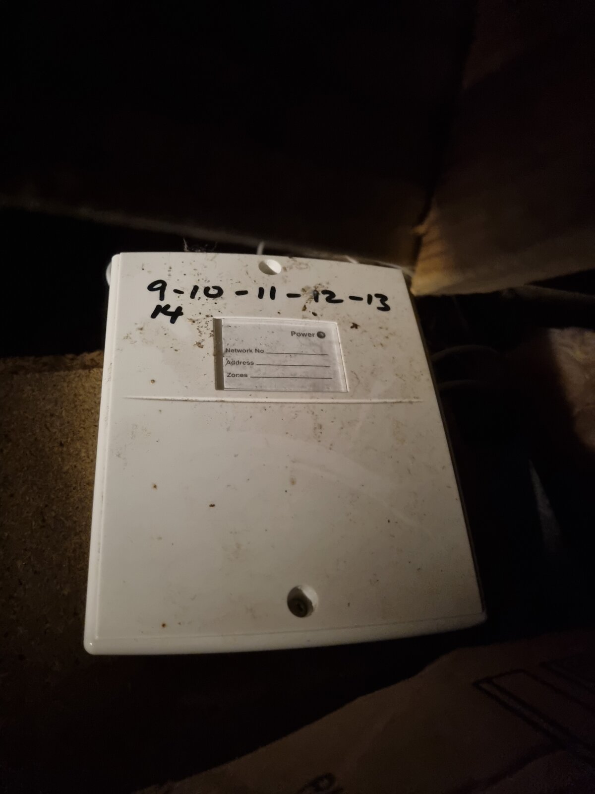

Are you sure it’s not somewhere else ? Loft ? Post picture of pcb or press menu 4 on keypad …
Pic attached.
I'll get to the PCB tomorrow and also take a look in the loft.
Pics of pcb. I found the expander in the loft as you suggested.
