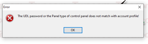

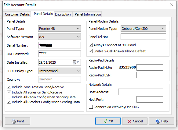

Right, I am trying to connect to my existing panel, Premier 48.
Usb cable connected to com1 on the panel (it has com1 and com2). Drivers installed for the cable and configured on the laptop as com1.
In Wintex I have created an account, selected Premier 48, software version 8.x (as per my keypad), UDL password I have used the engineers code, left everything else as default. When I try to connect using PC-Com(Com1) I get the error The UDL password or the panel type of control panel does not match with account profile!
When I then go to Edit Account > Panel Details I can see it has populated the Serial Number so there is communication. I have tried password 1234 but get the same.
I have no idea if the original alarm fitter used Wintex.
Any suggestions here?
Ta

Hi, thought I would post an update.
New alarm box fitted, was pretty straightforward on the cabling front, copy and paste.
I was able to reference the old Wintex profile to set up the new profile, so bulk of the heavy lifting was already done. I did hit little issues one after the other but was able to resolve them as I went along with the help of past posts on here mainly.
