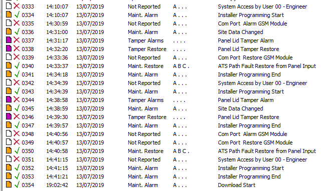

Here's the log. You'll see that I tried it twice. There's also a GSM alarm because I had to remove the antenna lead.
Only zone A, and nothing active.
Thinking back, when I have previously opened the panel it gave single intermittent beeps.

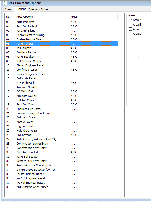

The tamper alarm doesn't appear to be assigned to an area. The only thin k I can think of are any areas assigned to panel tamper in area options? I am suspecting there isnt
Think you have hit the nail on the head ...I was thing along the lines when panel tamper is set for more than one area ...with one of those areas set ...

I checked the options and panel tamper was set to Area ABC, so I changed that to A only. Now when I open the panel it just gives a brief tweet every 30 seconds, which I can stop by screwing down the tamper switch.
This is what I remember from when I replaced the battery a couple of years ago. I don't know how the setting changed, but it did.
This is the log now...

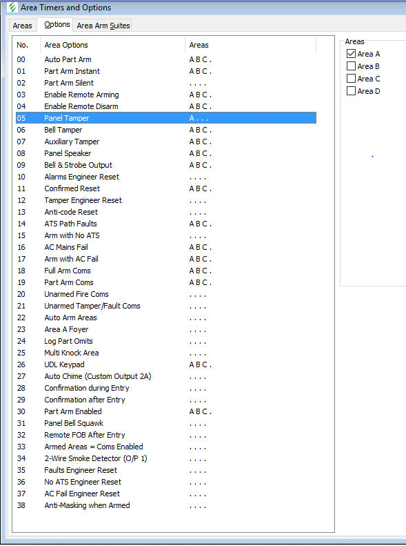

Looking at the options, many are set to Area ABC. But I am only using Area A with some zones set to part arm.
Should I change them all to A only?

If you generate a new default profile, that should tell you what is default A.
As you have no other areas having just A would be fine.
Strange how it logged the panel tamper as no area, yet assigned to all areas.
If the engineer or user was also assigned to all areas you should have been able to silence the alarm.
