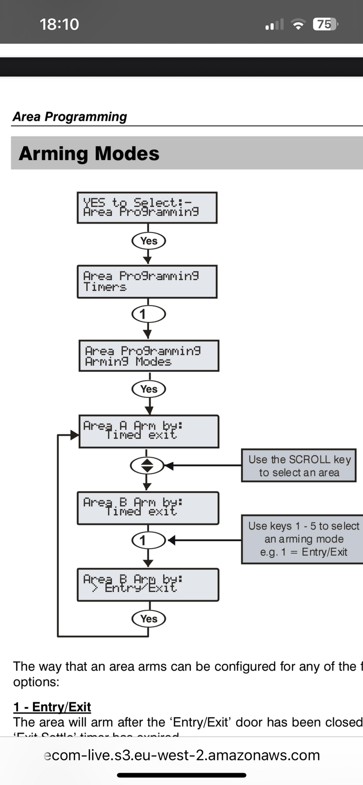

Hi, I have installed the Texecom Premier Elite system and not able to arm. I get the following message ‘Area in Exit > A’
The set up is basic and has 4 x PIR’s, 1 x Door Switch & 1 x Panic Switch. The Entry exit Zone is A PIR rather than a door contact.
I’m not seeing a ‘Ready Light’ which I understand has to be on to allow for arming.
The installation used existing cables and PIR’s. I have also conducted a walk test and all checks out.
Any ideas would be very much appreciated.
Many thanks.

Pardon my ignorance - does A refer to zone 1 which in my system is the entry/exit (PIR). What menu function do I access and change to ‘Timed’ ?

All your devices will be area A , go into engineer programming , go to area programming , arming modes , area A arm by …default is exit ….change to timed …
