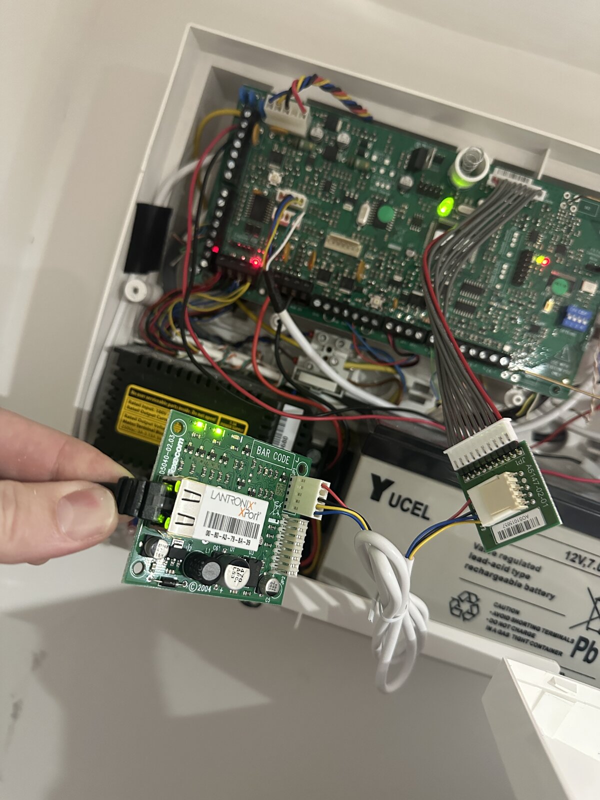

I have added a ComIP+ to the ribbon cable attached to the digital modem output to give me another port and attached a ComIP to it and wired into network.

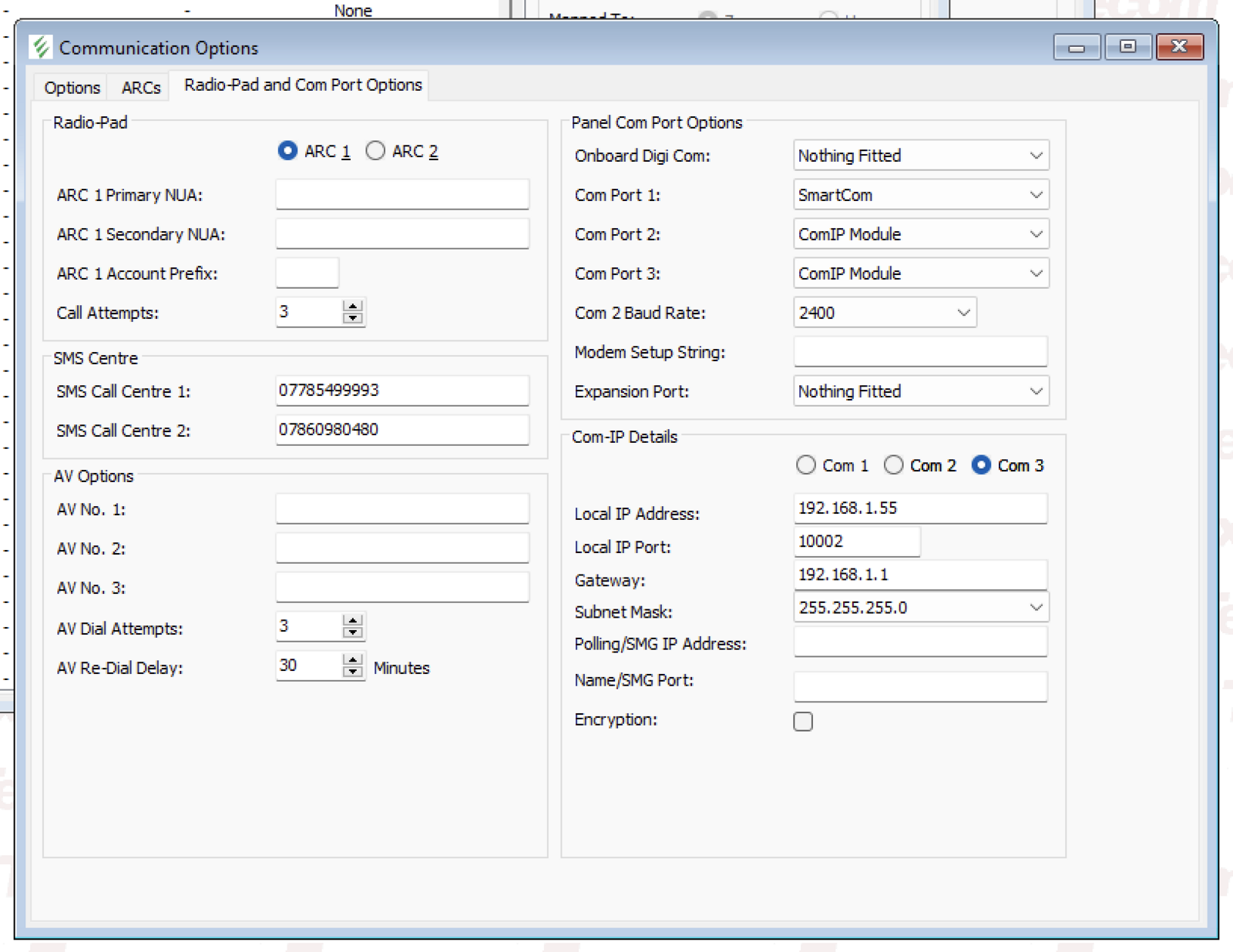

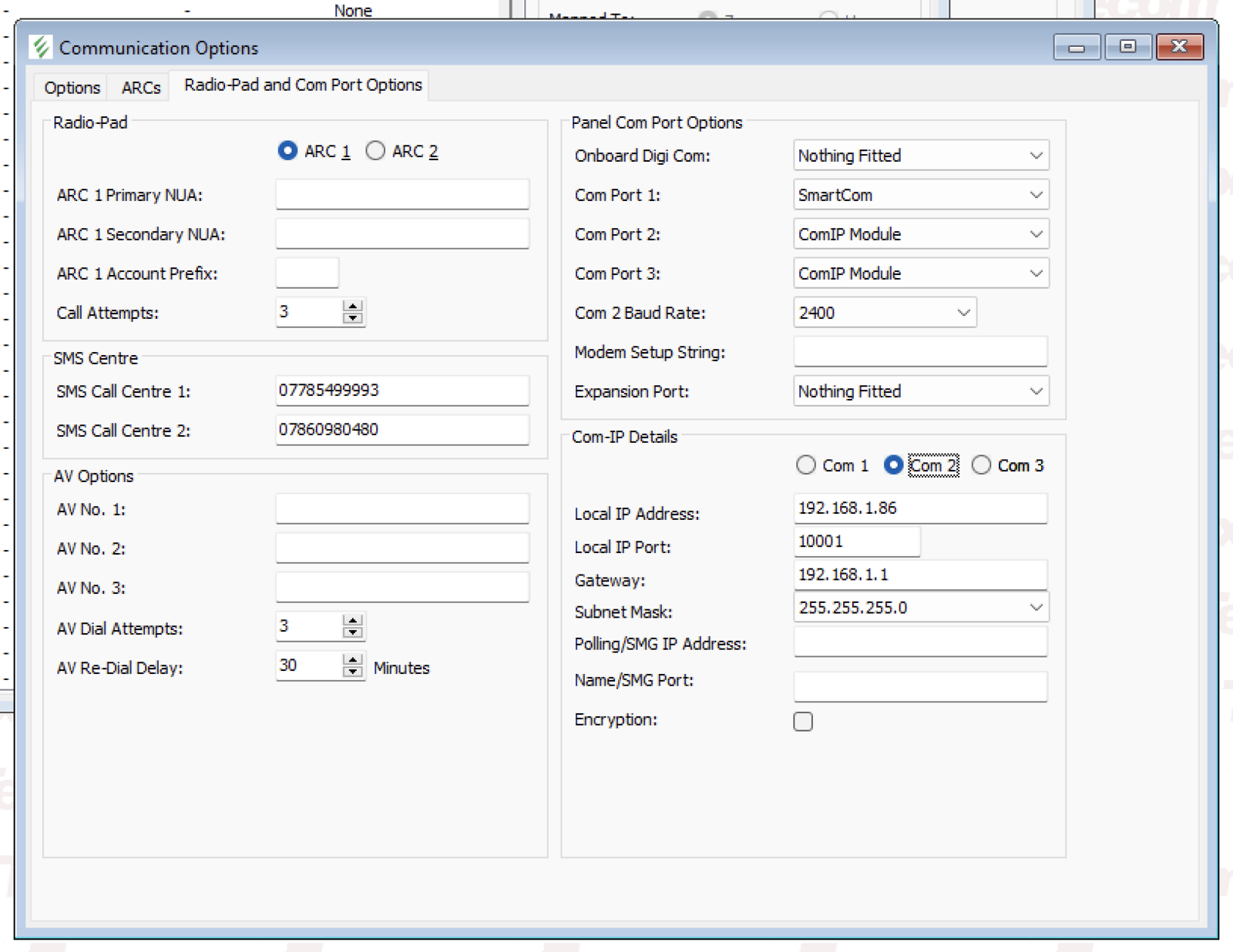

I appreciate you help. I have attached a couple of images of Wintex settings and the physical connections. I do think it is odd that the Com-IP is not getting an IP address automatically. I have assigned one but still think it suggests an issue. Thanks

I dont see the arc settings for the smart com and it appears that the baud rate for com 2 hasn't been set higher for the comip, other than that nothing jumping out at me.
Smart com is working fine and com 1 and com 2, both plugged into the smart com seem to be fine. I can make adjustments if you think necessary.

The baud rate can only be adjusted on com2

So I think the issue is with the comic not getting an ip address. I have a pretty large unified set up and it is showing up but not with any address assigned. I have tried assigning manually to the Mac of the device but it still doesn't take the ip address. My unified system knows it is plugged in and what it is but there is no network connection. Very odd. I haven't experienced anything like that before. Until I can sort that I guess other troubleshooti9ng is pointless. Any suggestions where to start with getting this to show up on the network - does it need to be initialised somehow?
lantronix device installer is where i would start as that will look for its devices and you can log into the lantronix device and change settings but ts been a long time since i have used the device installer and the Texecom login for the device.
Okay - I solved it - the issue was with the ComIP. I had to reboot the panel - turn off ac and pull the battery to get it to recognise and imitate the ComIP properly. The advice came from ChatGPT and worked! Nothing else was changed.
