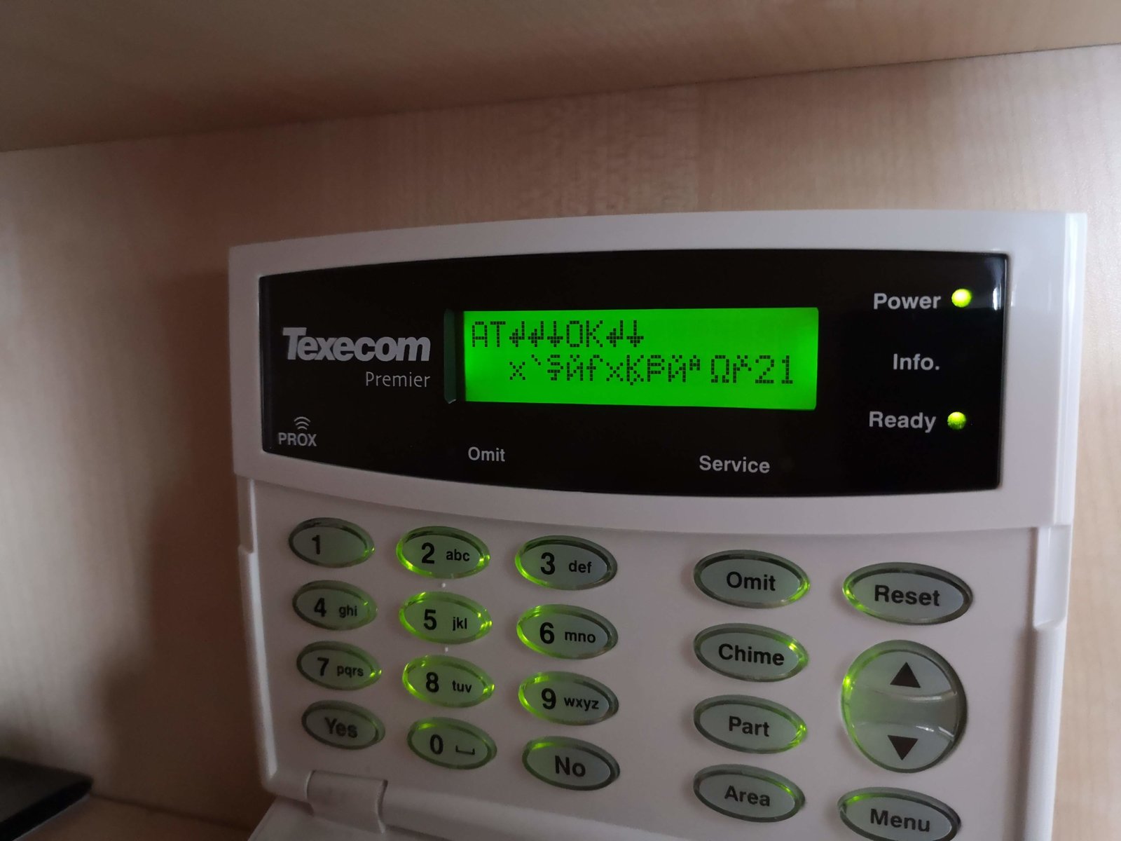

I logged in to my panel from PC to set the time and change the clock adjustment, when sending back the config to panel it stopped 75% through and said connection to panel has been lost.
Now the keypads show the whole config has been lost (e.g. normal message is blank, integration with Control4 has gone). I've got 2 ComIPs, one for Control4 home automation and one for connecting in Wintex.
So now I've got to try and connect to re-upload the config but some screens are just showing gibberish?

If you go to comport 2 in com port setup: press0 then rest what do you see.
Com2 (ComIP), press 0, see this:
on the PCB the middle LED seems to be constantly on, the ones on either side flash
on the socket, one light is on constant, other flashing
the order of the lights indicate whats going on, if you press reset, the display should clear and then go through a sequence before stopping indicating the state
the ip module is not showing a fault, however it did show no carrier which is related to not being able to see on the network.

some good news!
it looked like the sequence of events after assigning the comip an IP address, both of the comips were assigned the same ip by the panel (i must have at some point tried setting both com ports to have a comip)
which explains why when i disconnected and reconnected them, i could ping the ip only for a short time before both came online with the same ip, and everything broke
so i connected the crestron one to the network, assigned it the right ip via lantronix app, then connected the other one. i can now connect to the panel in wintex, but the home automation integration is not working.
