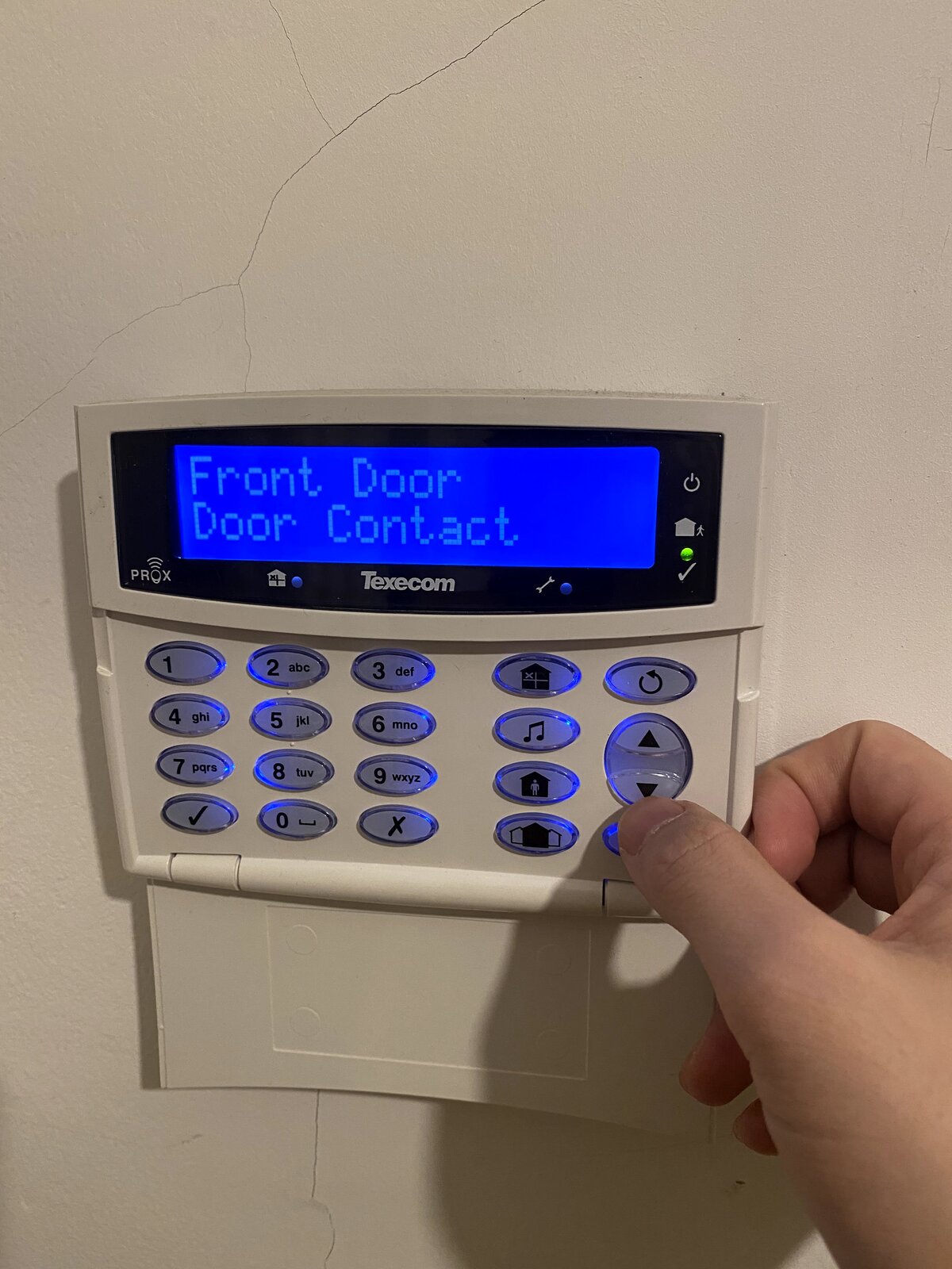

This evening, the alarm starts beeping - whilst I was in the house and the alarm wasnt armed. When I checked the alarm it showed system alerts - showed an alert from the sensor in my master bedroom. I went t have a look, nothing. I went back downstairs to arm/disarm the keypad to reset and clear the alarm. I doesn't let me reset. The error message I'm getting is:
"Supervision Flt:
Zone 009
Front Door
Door Contact"

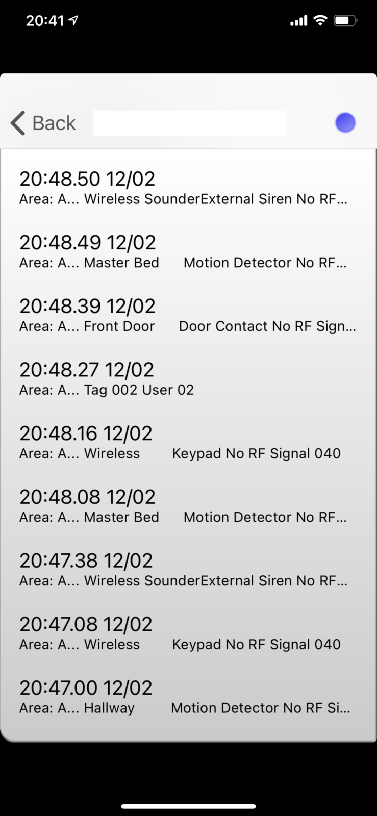

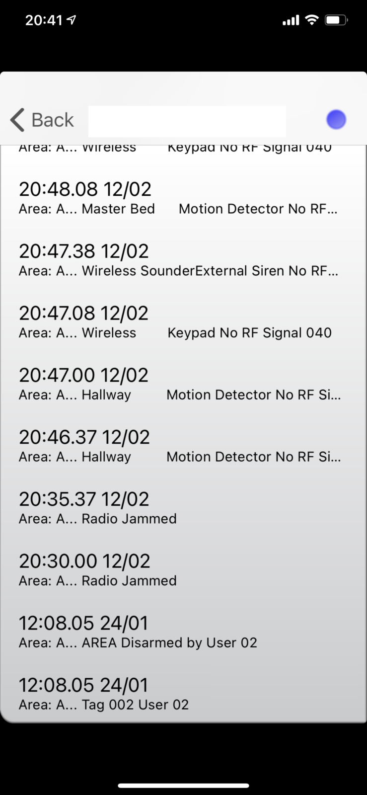

I've also checked the logs - there's a bunch of log entries in the last hour:
20:47.38 Area: A... MasterBed Motion Detector No RF Signal
20:47.38 Area: A... Wireless SounderExternal Siren No No RF Signal
20:47.08 Area: A... Wireless Keypad No RF Signal 040
20:46.37 Area: A... Hallway Motion Detector No RF Signal
20:35.37 Area: A.... Radio Jammed
I've attached some photos/screenshots for reference.

My initial thoughts are:
1. Something happened early with actually did jam the RF signal - I need to reset this somehow?
2. All of the sensors + alarm batteries have all failed at the same time? (I have not changed had the batteries since I installed the alarm system around 3 years ago - see below).

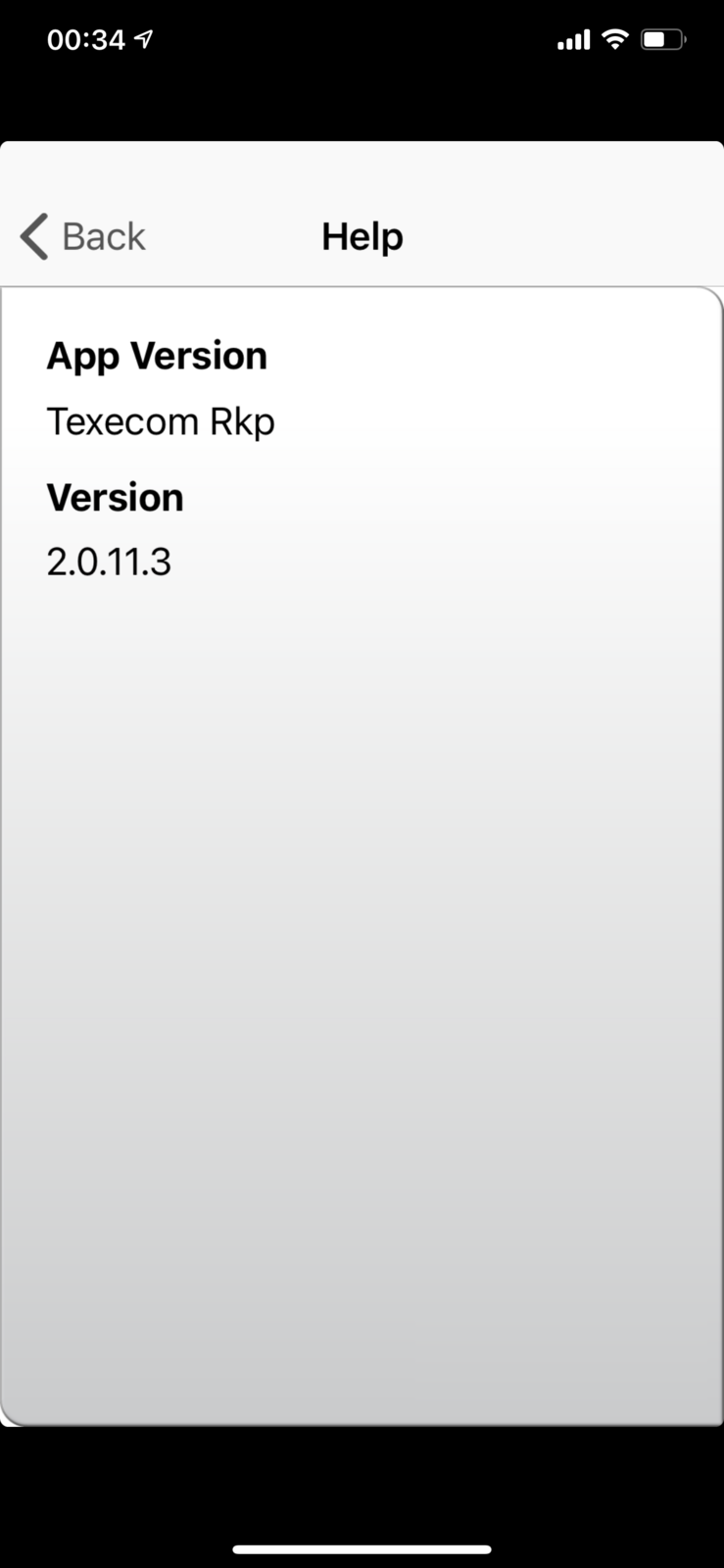

Hi, is there a dummies guide somewhere to replacing the batteries (including what type and how not to make the alarm go off)?
I took a photo (below) of the version of the system and APP.
thanks.

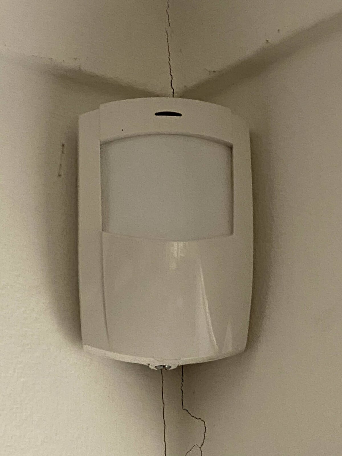

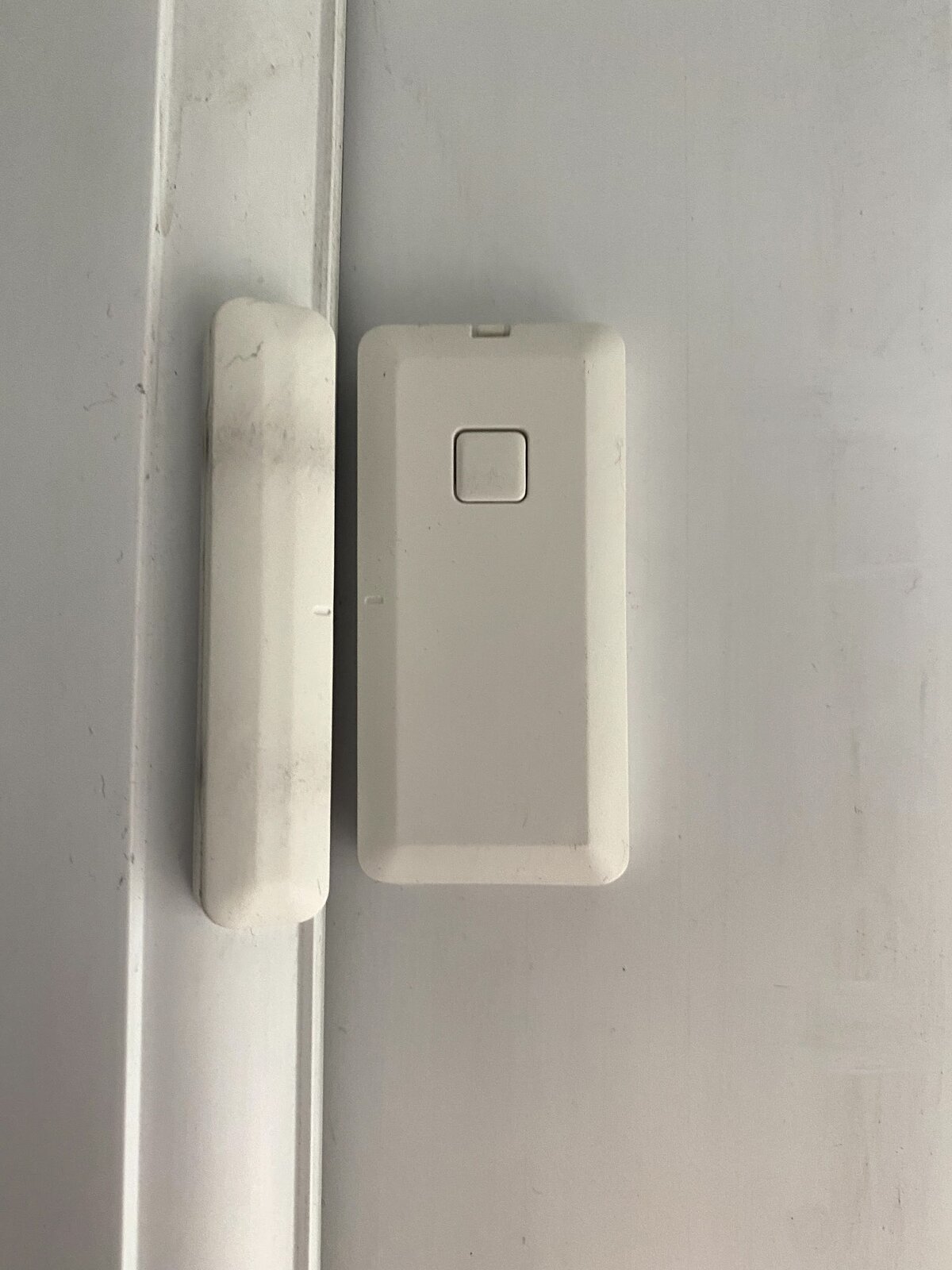

I have one front door sensor: IMG_4214.jpg
and three motion sensors: IMG_4215.jpg
From googling and comparing the names on your calculator page, I think its a Premier Elite Micro Contact-W *Uses 1 x CR2450; and three Premier Compact PW-W
*Uses 1 x CR123A.
Please let me know if you think I've got it wrong. Otherwise, I'll go ahead any order some batteries online.

Hi, just providing an update (in case anyone else searches this thread for help).
The UDL Code (in the APP) was also the Engineer Code. Once I put in the code into the Keypad, the screen displayed "YES to Select:- Zone Setup". This indicates its in Engineer Mode. Once in Engineer Mode you can fiddle with the sensors and the alarm will NOT go off. I believe there is a time out function, but to be safe I exited Engineer Mode and re-entered after replacing each battery to be safe.
Using a small Philips head screwdriver, I unclipped the Door Sensor and replaced the battery. CR2450.
Using a small crosshead screwdriver, I unscrewed the single screw for the Motion Sensors and replaced those batteries. CR123A.
All done within 3 minutes. Super quick, super easy.

Currently you are using a comip or comwifi module, the Texecom Connect App, that is now available requires a smart com.
ATS faults are more common on the old app as you cant connect to the panel while its sending a message out and vice versa, plus extra features are available on the Texecom Connect. I advise looking at the Texecom website for you to decide if it is for you or not.
It will require a Smart Com and some programming.
