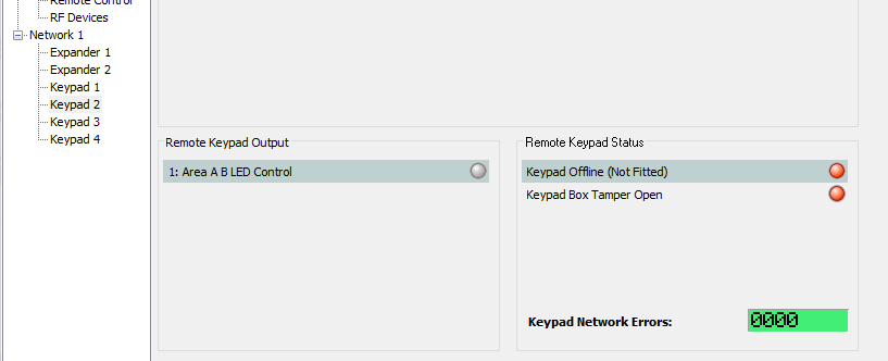

Looking at the diagnostics on Wintex, it gives me the impression the keypad isn’t recognised. Screenshot attached.

That's bit confusing as you screenshoot displaying Keypad 2 - Not fitted
I would start with check of correct cabling of keypad

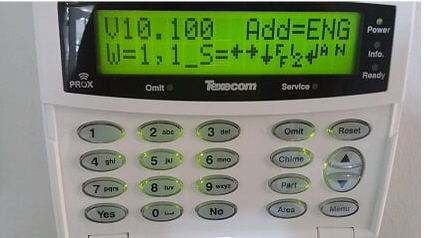

In day mode press Yes and menu on the keypad
Add=XXX what address is the keypad assigned to?

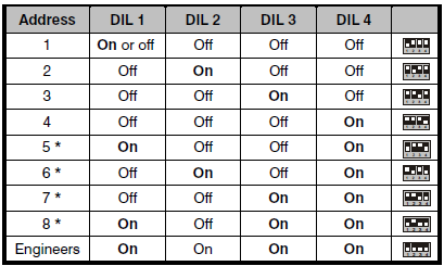

What is probably most confusing is address 1 is dip 1 on or off, the rest all off.

Tried the Yes & Menu. Below.
Eh?? That cant be right!!
The manual is wrong then, or I interpreted it differently....
It looks like on is off and off is on!!
anyway, that's fixed it, so thanks for your help guys, I really appreciate it!!
on the dil switches off is 1234 side, 'ON' is along the top
the manual is not good pictorial on this one, they are supplied all off address 1.
