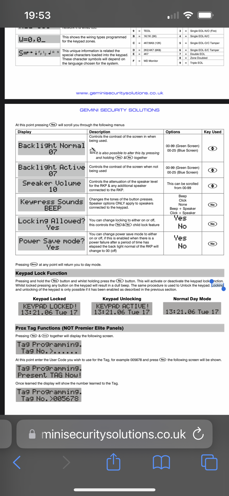

Hi all,
I have a Texecom Premier Elite 48 with a mix of LCDP and LCDLP keypads. Is it possible to configure the keypad to not beep when you're pressing the buttons? We have one keypad on the landing so we can part set the downstairs overnight, and the beeping when I disarm it in the morning often wakes the children up.
I've looked in the installer manual and the volume adjustment is mentioned in there under Engineer Utils > Adjust Volumes, but that doesn't seem to do anything useful.
Thanks!
As per picture

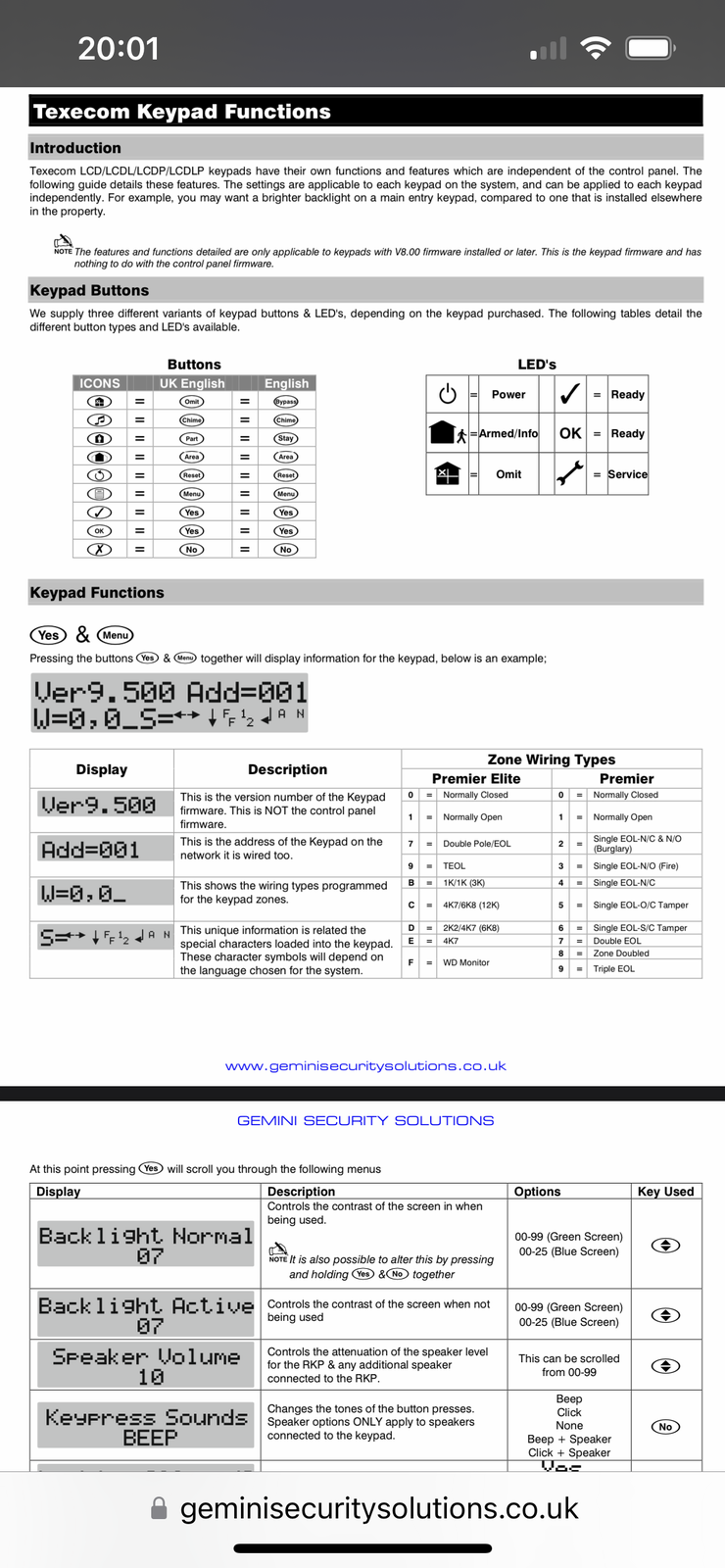

Thank @sparkymarka. How do I get there? I can't find any mention of it in the installation manual or master user guide.
Google ….Texecom premier keypad menu settings or below
  • Thanks
Reactions: dty
‘kin ace! Thank you! I’ve had the system for a few years now and have gone into all sorts of dark corners including wiring home made things into various digital outputs, and this is the first I’ve heard about keypads having a local menu! Thank you!!!
