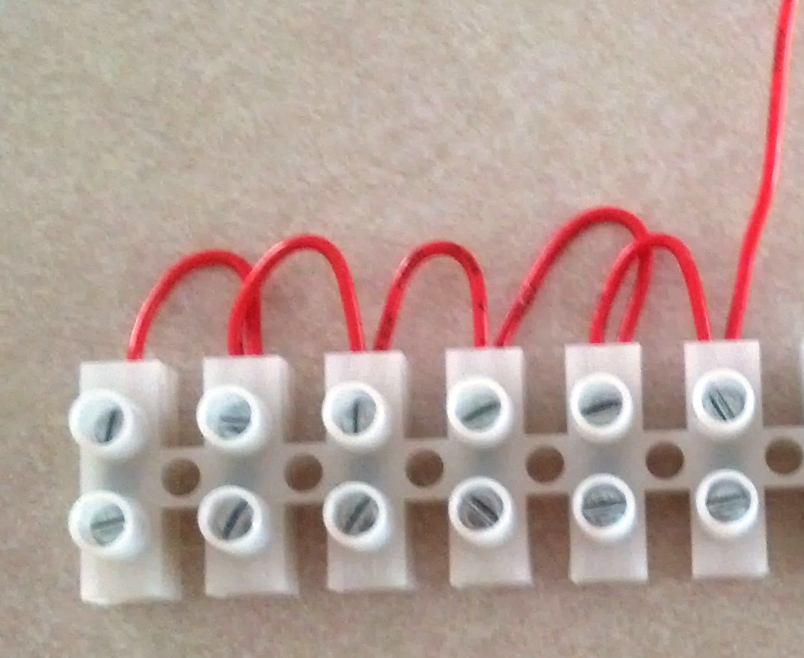

I'm fitting one of these with around 10 PIR's. If ive understood correctly, that's 10 cables to get into the 12v terminal. Can I use a lighting junction box for this or is there another recommended technique?

You can use additional terminal blocks if you like, but you will have to daisy chain all of the terminals (picture is generic off the internet).
I get PCBs made to expand the power terminals as you can't fit 8 wires into a PCB terminal block once they have ferrules on them.

wouldn't it be easier to use a junction box and place all of these wires into one of it's chunky terminals?
Yeah it would... but you don’t have too, you should get 10 individual cores into each terminal. Strip them all back & twist tightly together then snip off the rough & you should be left with a single solid core as such which should fit nicely into the individual power terminal, do the same for the pos & neg. If you have a Elite 48 your get two sets of power terminals.
Make sure your not exceeding the max current output! You may need an additional power supply if not.
