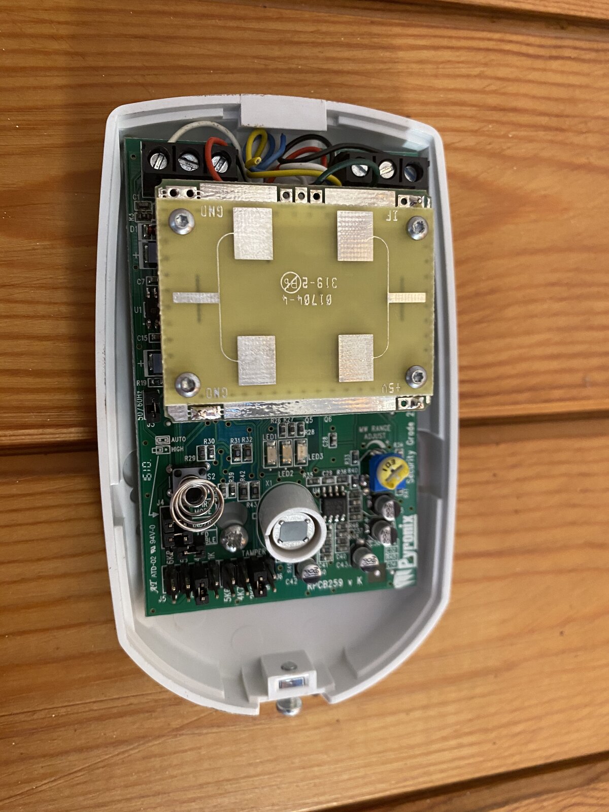

I can’t set my alarm because it says ones of the zones is active.
I don’t want to have to manually bypass it every time I set the alarm. Is there a way to permanently remove/ bypass it? I have the engineers codes etc.
I’m assuming the PIR is faulty but it’s in a low risk area so happy to do without.
All help appreciated.
Thanks.
This is the sensor I have.

Engineering ....zone set Yes up scroll to zone e.g 3 ( will probably be a guard zone ) press no scroll up till it says not used , yes , menu , menu , reset log off eng yes
