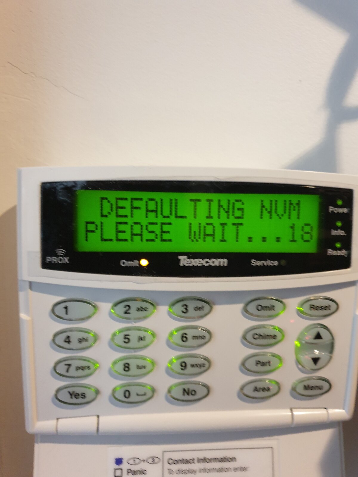

Hi,
I am a fairly able DIY-er (we built our own house), and sign-off requires a fire alarm (Grade LD2).
I have bought what I believe to be a competent wired system (Texecom Elite 88 with wired Texecom fire sensors, keypad and sounders), and have wired it according to instructions (as far as I know).

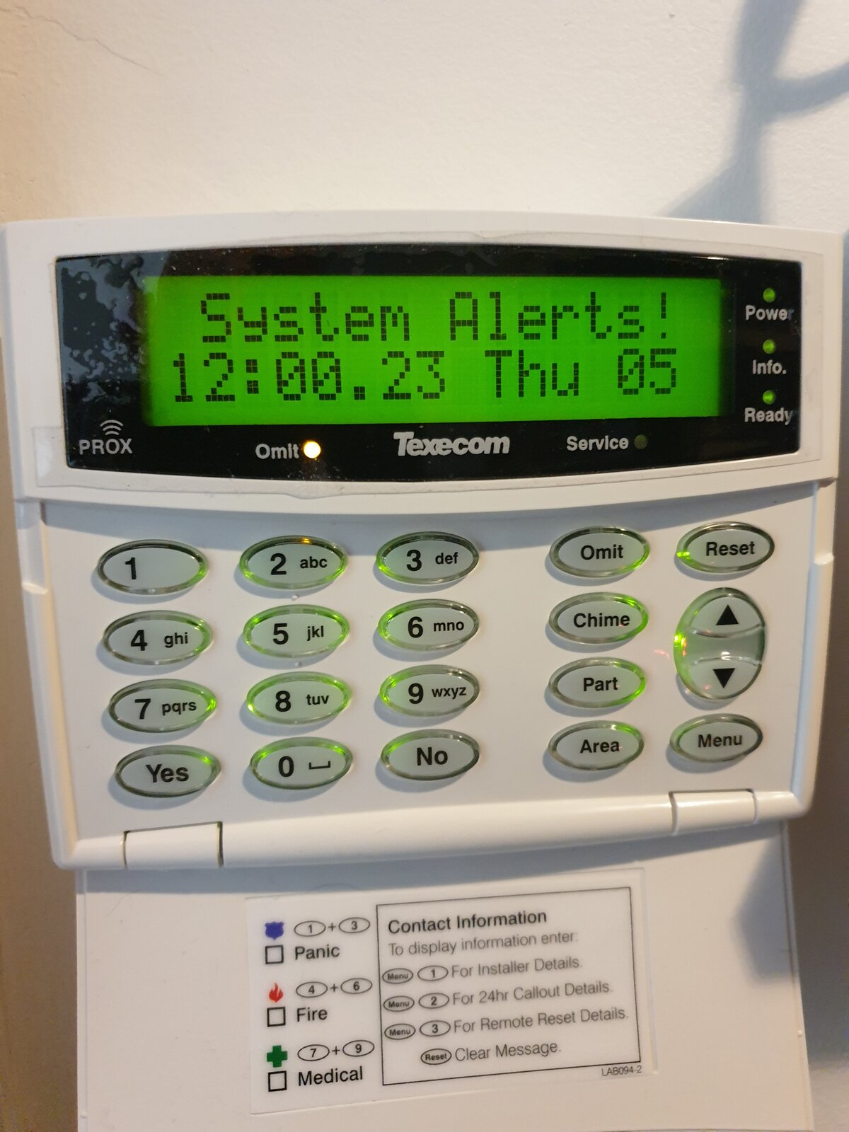

I am stuck at the comissioning stage, because turning it on (connect battery; hold factory defaults and hit battery jumpstart). Heartbeat light works; I get "System Alerts!" from the keypad (set up as an Engineering keypad, Address 10, all switches on). Lid tamper is jumpered.
Here is the problem - I can't clear the System Alerts or get the system to respond by entering the default engineers code.
I assume since I am seeing the messages on the display, that the keypad is wired correctly.
I have read that you should be able to enter the default engineers code (1234) to clear the alerts. I have also tried combinations of the engineers code and master user code (5678), but I can't get past this to start programming the panel from the keypad. I get beeps from pushing the buttons, but nothing changes the display.
See the images of the keypad below - Info, Display and Omit are flashing. Currently, only the keypad is installed on the Network 1 port.
I have exhausted all the help I can find online (including this forum) - I must be doing something simple wrong. Help!

as for codes, enter repeatedly until system enters menus, first enter of correct code scrolls through alerts second should get you into the menus

The problem turned out to be a side-effect of the wiring - the entire house uses structured wiring based around CAT-6a cabling (and the alarm wiring was installed along with everything else during construction).
In wiring the network, I used a coulour mapping that meant brown/white and green/white carried the network signal (in this case, to the keypad). The lighting in the network cupboard is poor, and the difference between brown/white and green/white is subtle in that light - I got them crossed, and it was difficult to spot without buzzing through the wires - which I did this morning, and discovered the error.
So of course, the keypad is powered, but has no usable connection to the panel. Swapped the wires, and it's all working according to spec.
