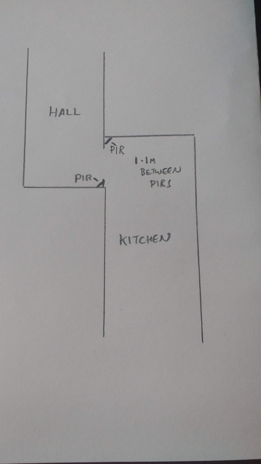

Hi
Excuse the awful sketch but it should give you some idea where the sensors are located.
All walls are stud partition
Cheers

The DT's are too close, if you remove one the other should clear.
you shouldn't need DT's everywhere, so you may be able to replace one with a QD.
