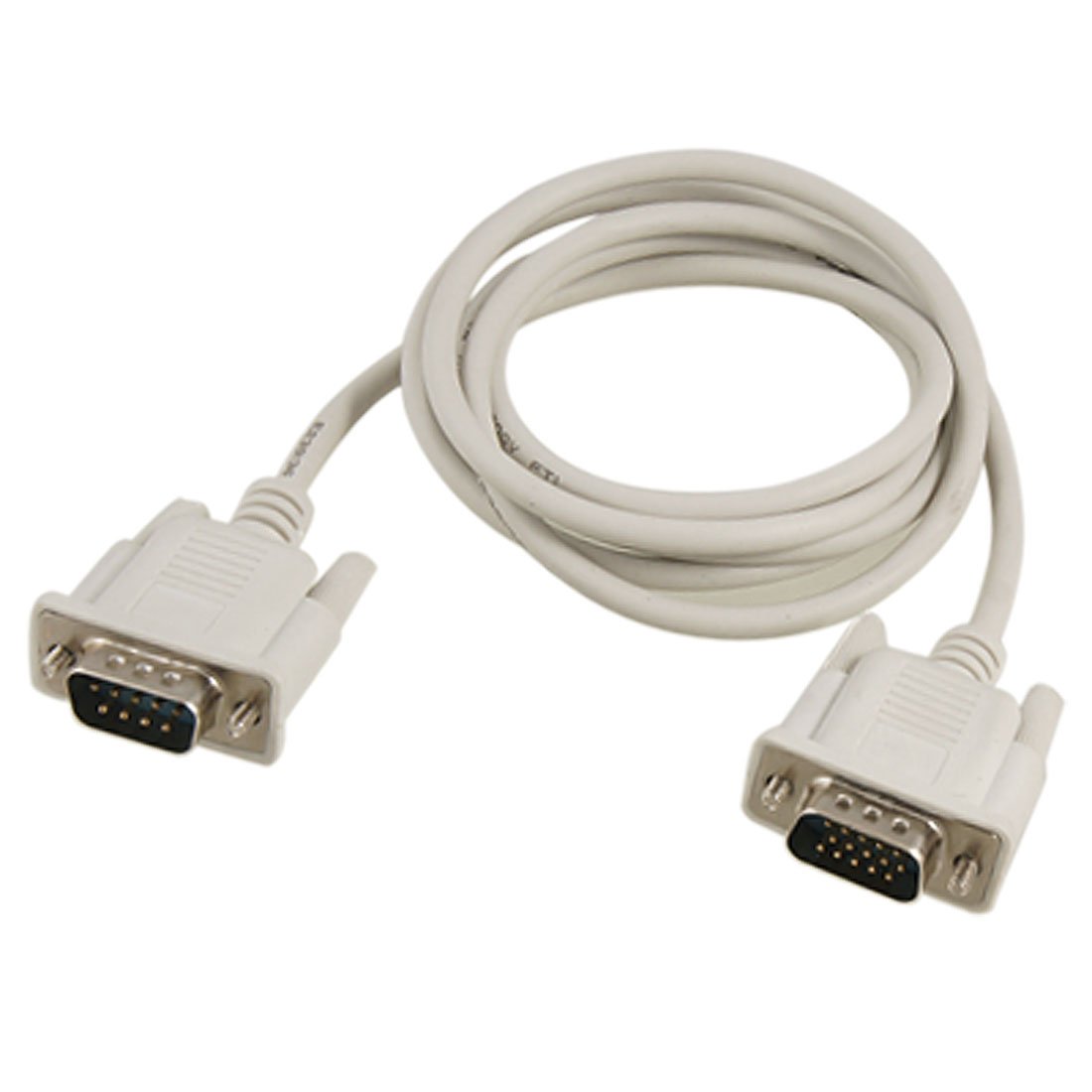

I've ordered a Texecom RS232 PC-COM cable to link my laptop (running Wintex) to my Texecom Premier Elite 24 panel (I have a bit of a mammoth thread on that subject).
This cable has a 9 pin female end (the laptop end) but the port on the laptop (in fact any laptop in the house) is a female 15 pin VGA.
Has anybody successfully managed to just use an adaptor (VGA to RS232 male-male) to connect the cable up?
Something like this:
There are also RS232 top USB adaptors...
The other option would be to try and return it and replace with the more costly USB COM cable, but I'm hoping I don't have to use that.
I'm fairly sure an adaptor would be fine, but you never know...especially as this isn't an ordinary RS232 cable.

The cable you've ordered looks like an SVGA to VGA cable for an old monitor. The 15 way D-Type on your laptop is for video. Most laptops don't offer an external RS232 port anymore, so you'll need to get the RS232 (9 way D-Type) to USB adapter. Be careful, as many of the cheap Ebay offerings do not work with Windows 7 onwards.
Thanks galaxyguy - not sure if you referring to the pic I posted (which is the adaptor), but just in case here's the cable I've got:
Aye - the port on the laptop is the 15 pin female VGA I would connect to an external moinitor and the connector on the texecom is 9 pin female.
So would you suggest the 9pin (male) to USB adaptor would be preferable to the 9 pin (male) to 15 pin (male) as per the the image in my original post?

Yes, get the USB adapter. I believe the Texecom lead is basically a level converter, converting TTL to RS232. You'd then need to convert RS232 to USB with the Male to USB adapter.

The VGA port on a PC or laptop is not a COM port, and can't be used as such.
You need a USBS to serial converter, which allows serial kit to be connected to a USB port, but you would be better getting the USB COM cable.
