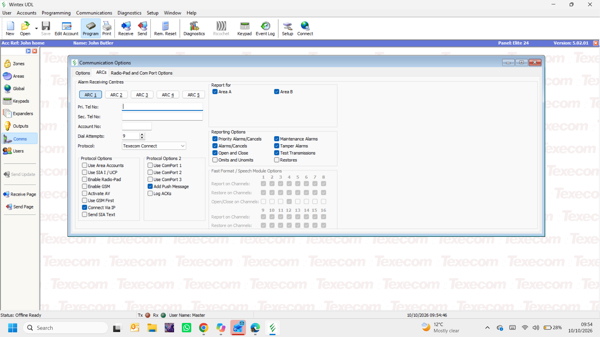

Check that the IP address in Digi Options, Arc 1 is set to 127.0.0.251

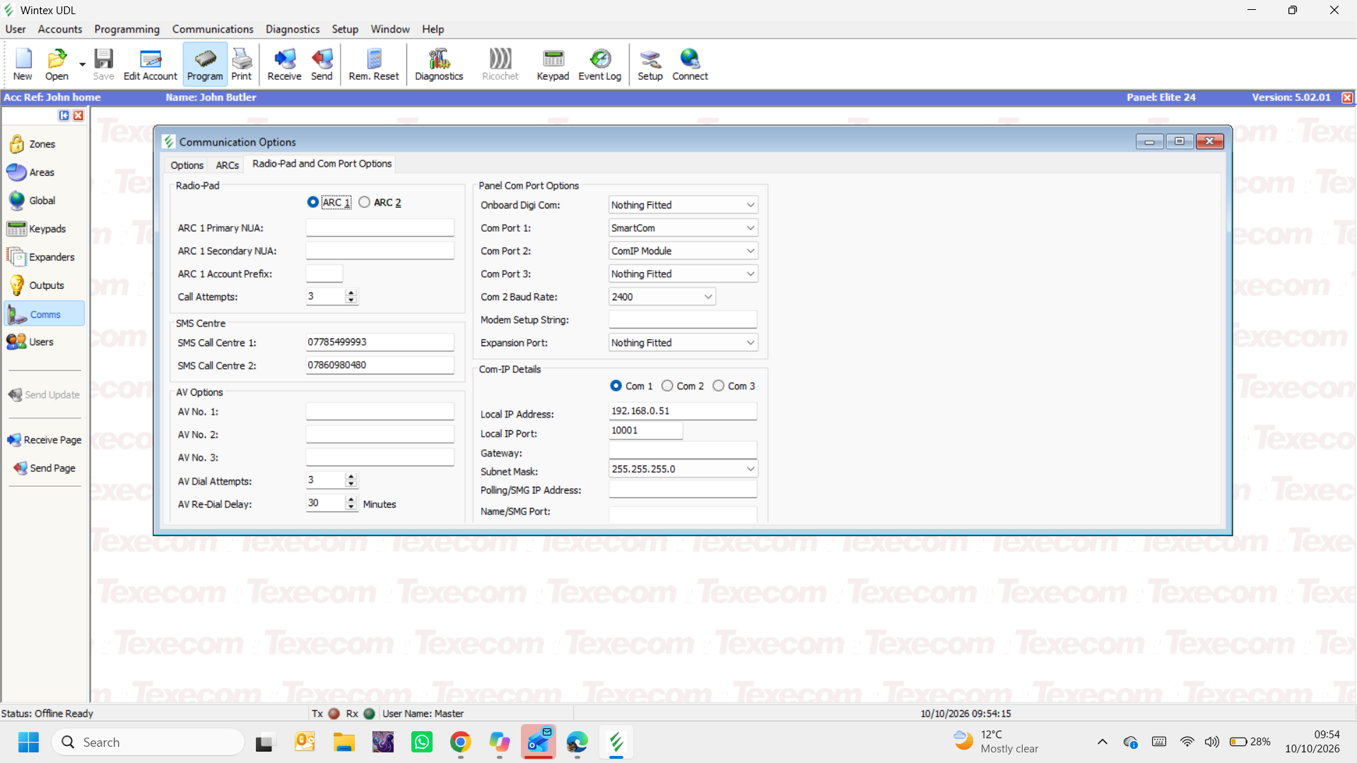

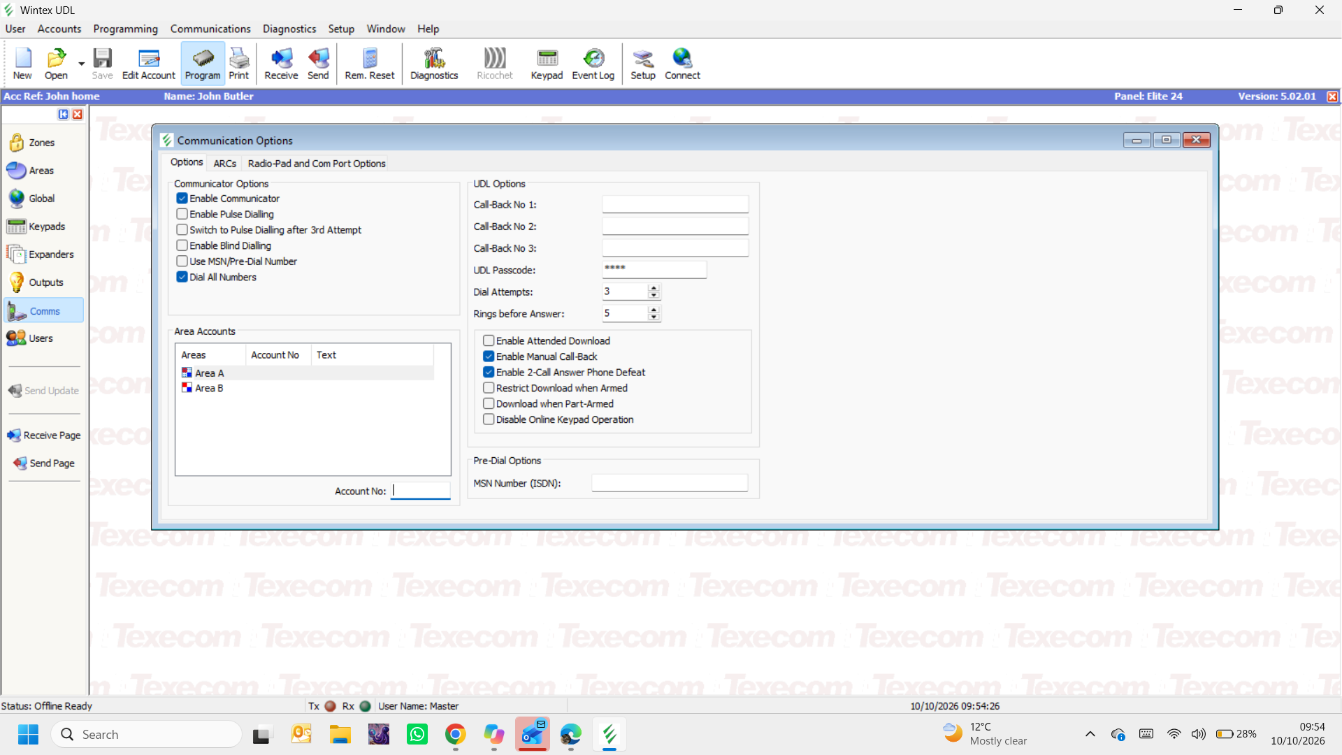

As I have not got a lot of experience DIY installed the panel 20 years ago and added smartcom later and it was working ,enclosed screen shots If you can please tell me if they are correct

just un-program it and reprogram it back up.
If still having an issue power cycle the panel.

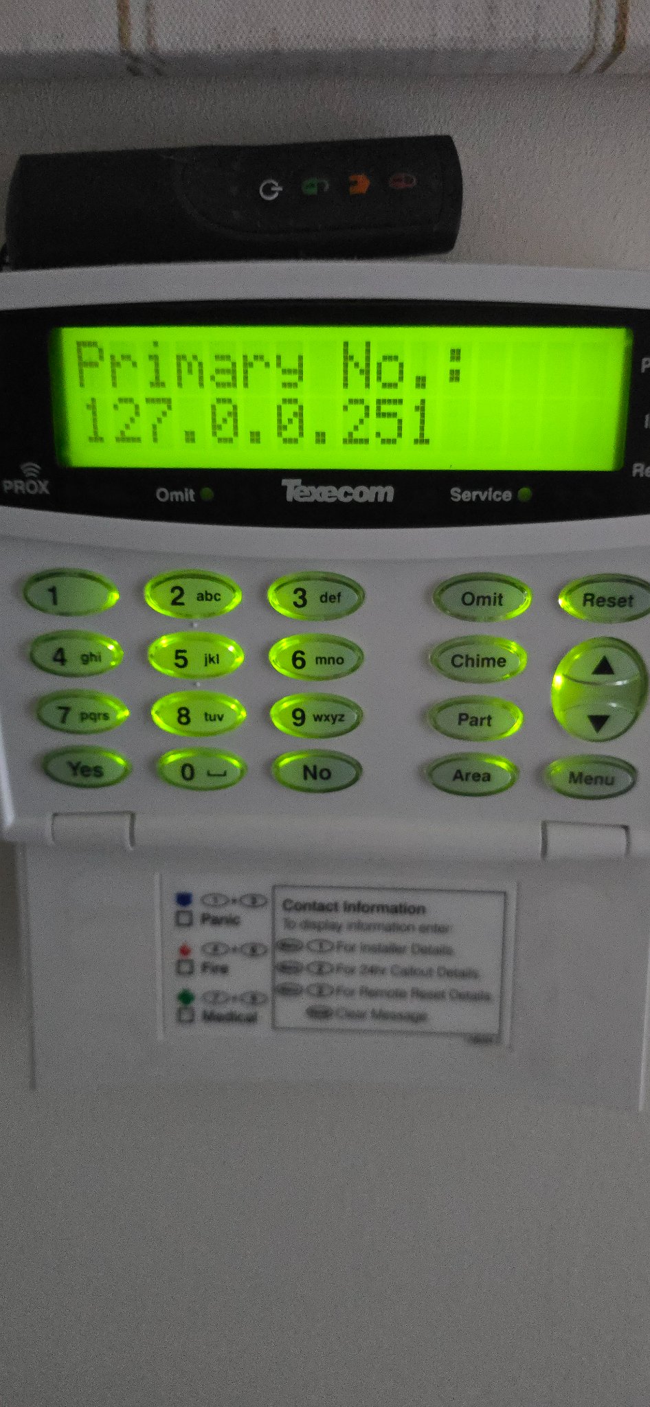

Primary number should be 127.0.0.251

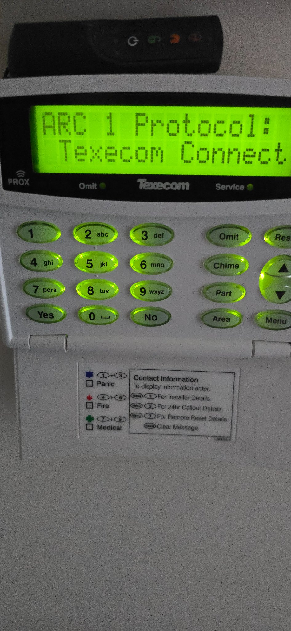

Thanks I set it to 127.0.0.51 it still wont generate an app code
127.0.0.51 or 127.0.0.251
I am only guessing but the latter IP address looks like a loopback address.
As Secureiam, just reverse all programming for the Smartcom, and then start from scratch, that should auto populate ARC settings etc etc as required.
Sorry typo 127.0.0.251 is what I set at.I have reset the smartcom and now it wont connect at all to wintex using ethernet. I think its too old as it is an early version ,What's the cost to have an up to date texecom panel fitted with new sounder and programmed ,I have 7 working zones in the GU14 area

elite panel v5 is fine with the smart com, is it connected via wifi or via ethernet.
the smart com needs to V2 or higher.
The generating of the pp code, just needs things to be done in sequence and should be fine, hence power cycle of the panel if programmed correctly should resolve.

Thanks sort of got it up and running by rebooting the panel but the app is asking me for installer ID which i dont have
