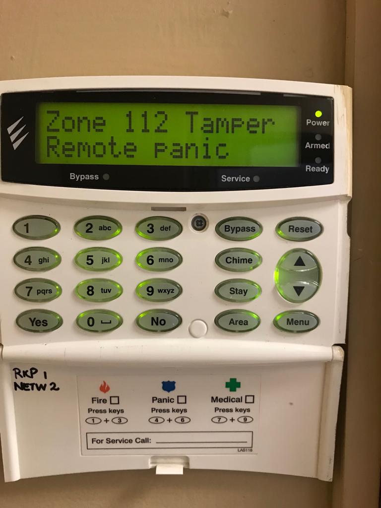

Any advice on how to reset "Tamper Remote Panic" on Texecom Premier 168 keypad?
that's say zone 112 sp need to find the device and check its tamper is secured.
if tamper is user resettable, enter user code until you get in user menu then pres reset until it goes back to day mode.
if its engineer resettable then you need to enrter engineering then press reset until you get to day mode.
