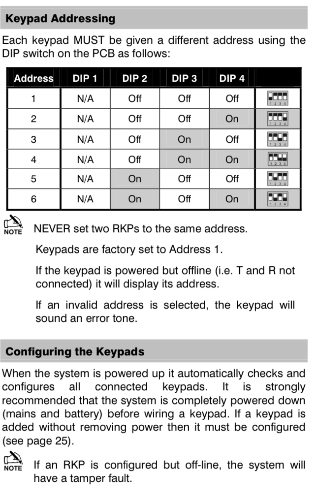

I take it you have a keypad downstairs as well, make sure the DIP switches are set to different addresses from each other.
This applies to the Veritas Excel, not sure what panel you have
As above more than likely they both have address 1 …
check the dill switch on the old keypad you took off and set the new one the same ….
