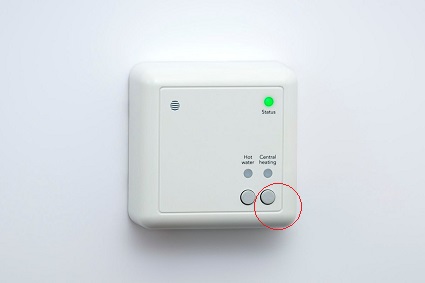

As you have described it and, ericmark says the wiring would sound to be correct.
If you operate the CH manually from the receiver using the push button....
..... does the central heating switch on and off? If it does, the wiring is correct.
If it doesn't, as a test, can you put the old room thermostat back in circuit exactly as it was and set it to its maximum temperature and to be 'on' what happens now?
