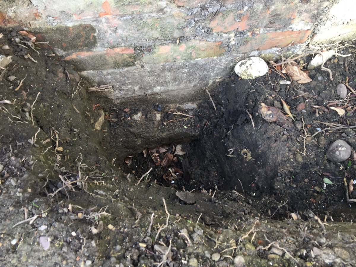

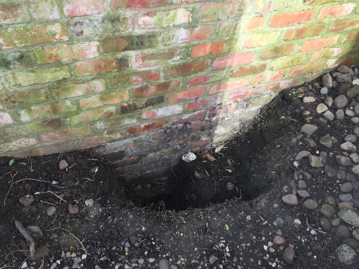

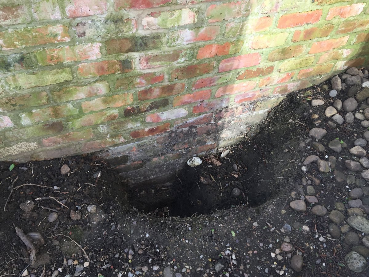

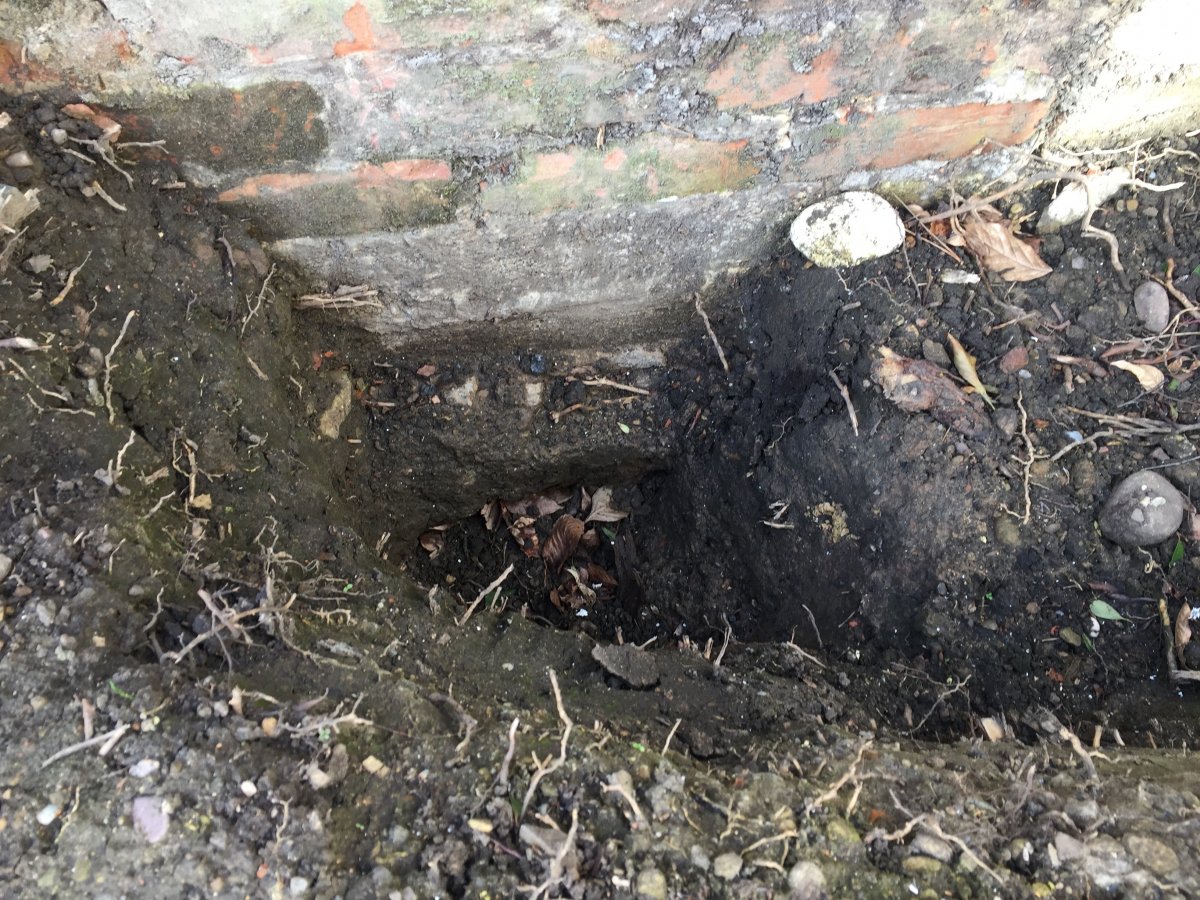

I have a pic of the trial pit which shows the footings for the wall. Only a shallow concrete strip for the wall.
So i need to dig out all the foundations and leave this section till last. Try and time it so i dig it out the day before the concrete comes.

700mm is rather shallow for an extension foundation. What is the ground like? From the photos it still looks like topsoil.
We are on a sandy soil according to BC. The wall has this 150mm concrete foundation and then it is built up in the brickwork to ground height. From the bottom of the foundation to ground it is 800mm. Concrete footing maybe 200mm deep i suppose.
I just hope i don't have to go lower than the foundation.
Surely that was the whole point of digging the trial hole. To discover the depth of the neighbour's foundation and to see what the ground was like to see how deep your foundation will have to go? Is it a firm sandy sub-soil? It looks very black and top soily to me.
Just hoping that your foundation will be no more than 800mm is rather short sighted. As the american military say....Fail to plan.....Plan to fail.
