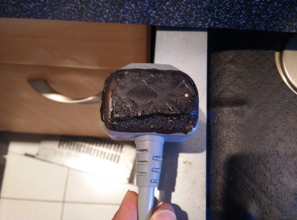

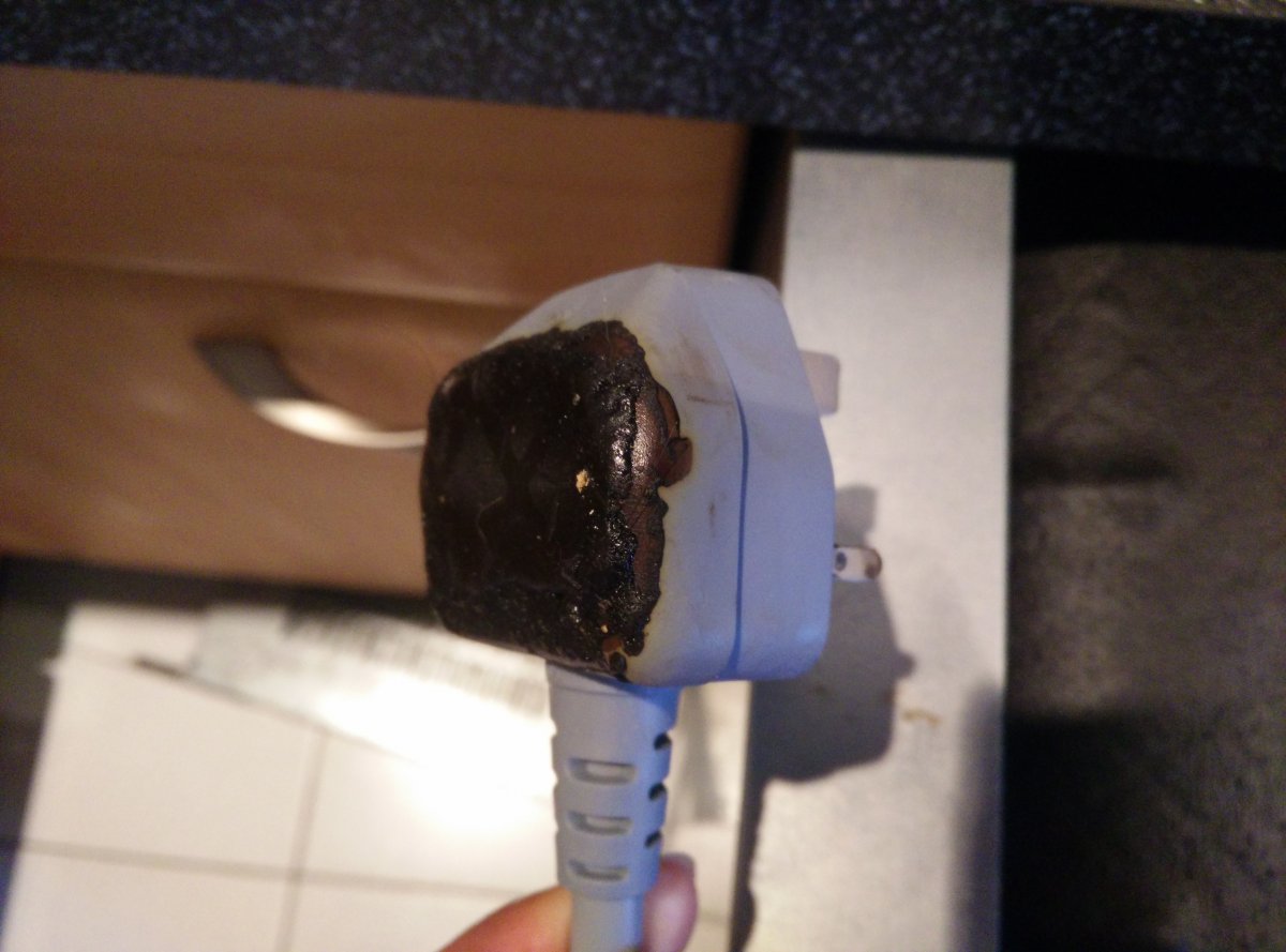

In fact, the dishwasher has a soft, tarry black plastic layer on the back to absorb noise. It is slightly sticky. It softens when the dishwasher heats up and fills with hot water and steam. If the dishwasher is pushed hard back against anything, for a long period, the sticky surface will flow onto the object and stick to it.
Scape the sticky black residue off the plug, and tape a barrier material to the back of the dishwasher. I used baking parchment as it was handy in the kitchen and has a non-stick coating. You can use a bit of white spirit to clean up the plug if you want, but it will probably be stained now.

It sounds as nothing has melted, the black bitumen? pad on the back of dishwashers gets all sticky when they warm up and anything against it becomes stuck.

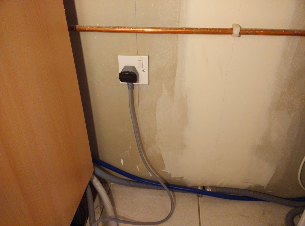

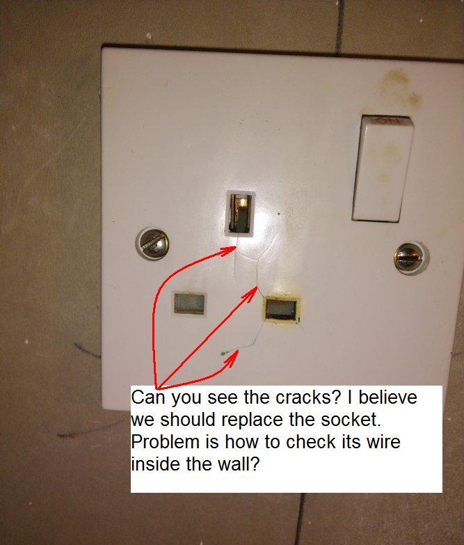

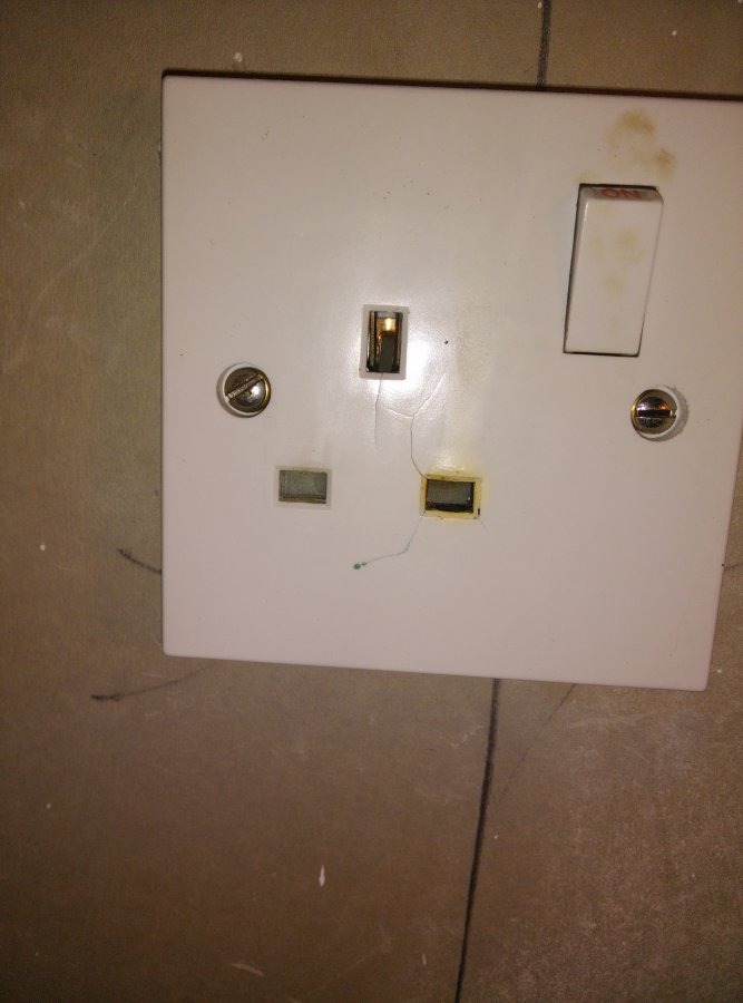

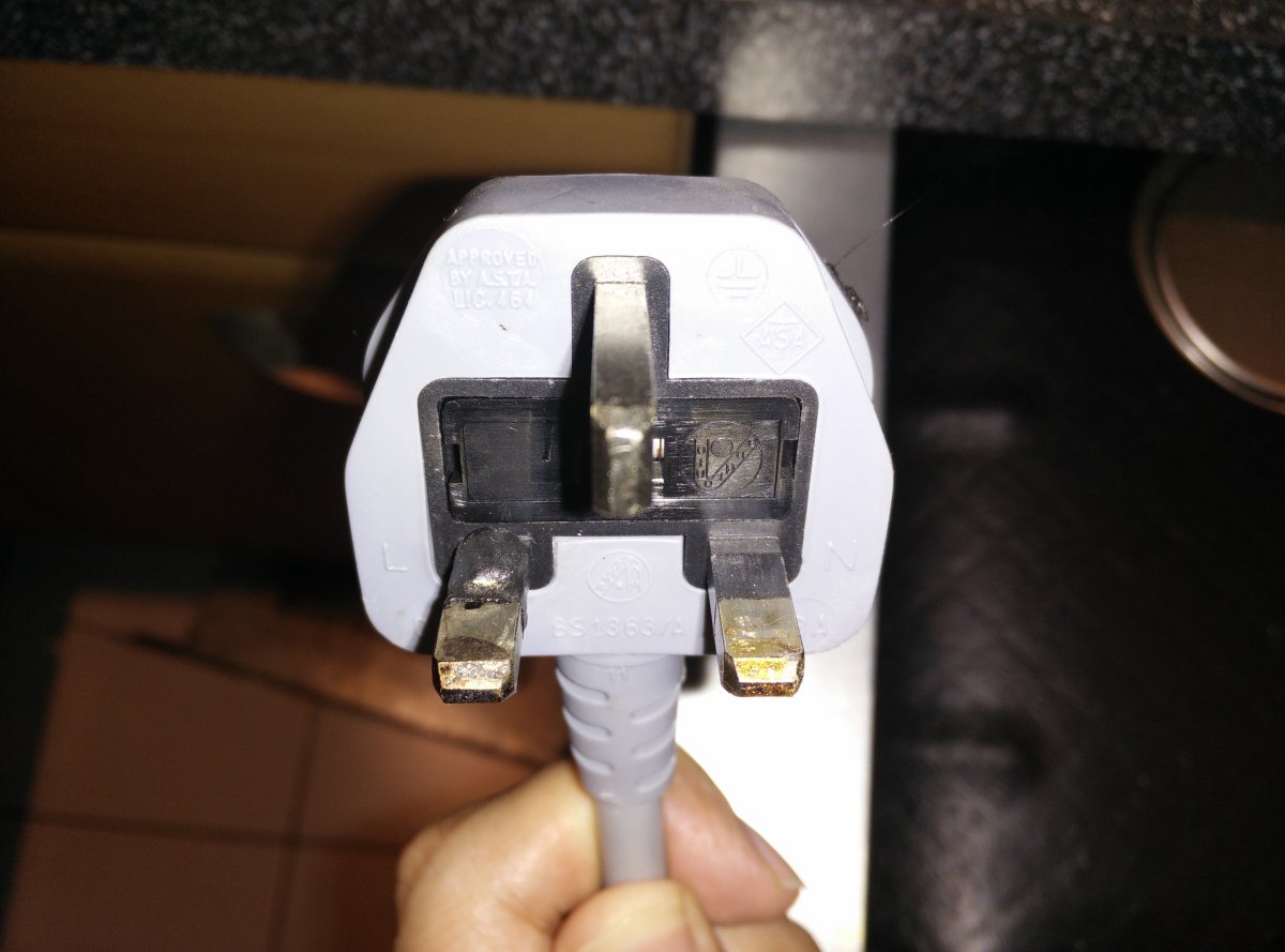

After closer inspection, while the bitumen did indeed melt onto the plug, it seems there was some damage to the plug and socket itself. I have attached some photos - let me know what you think?
I think the socket will need replacing - I will probably get a professional to do this.

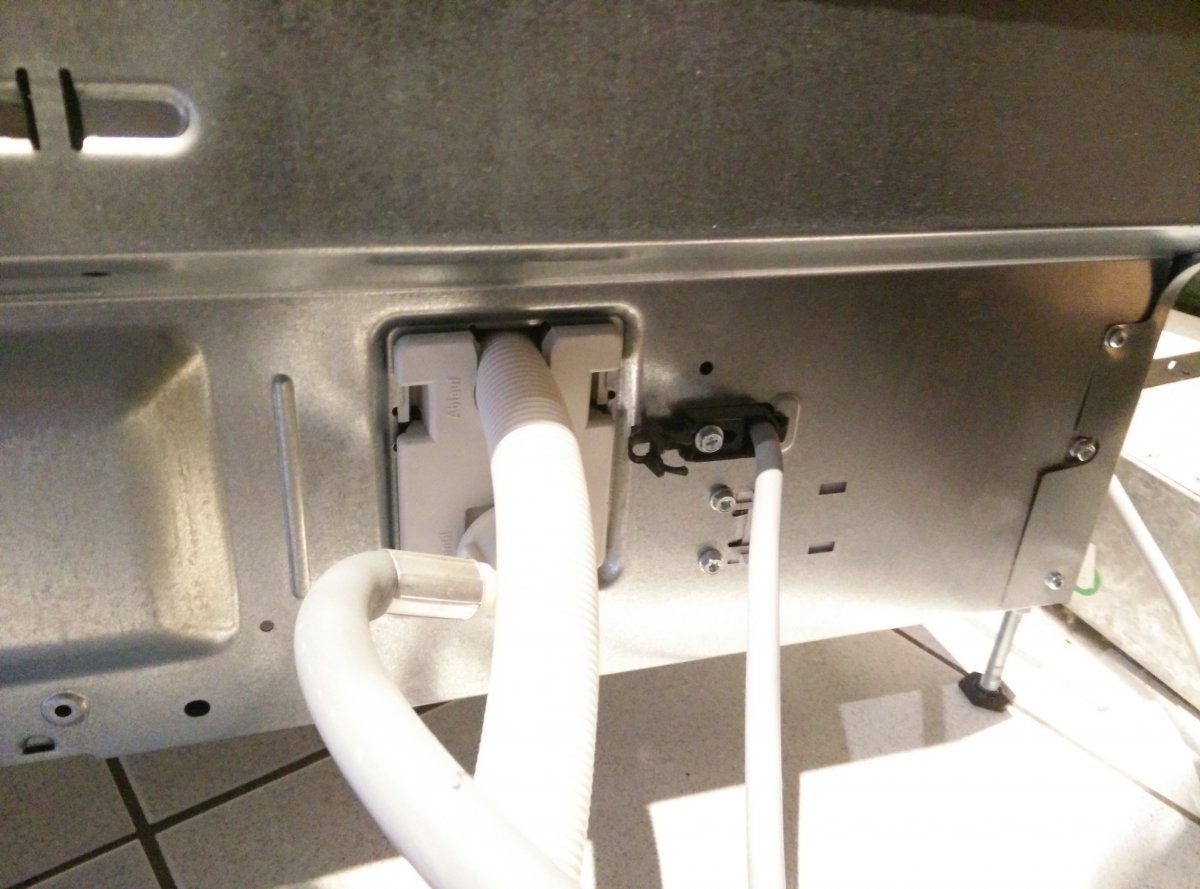

The plug and the wire are fused and I cant seem to find an easy way into the washing machine in order to replace it - its a Diplomat ADP8322. Does anyone know if this is an easy job or am I better off getting a new dish washer?

you can cut the plug off the flex, and fit a new plug. no need to rummage around the connector block in the appliance (hopefully it has some kind of protection from water in case of leaks).
You are right, there is evidence of heat browning around the live pin on the socket. This is probably due to a poor connection in either the plug or the socket. Moulded plugs are supposed to be assembled to a proper standard in the factory, and this would be unusual in a European product. "Diplomat" was an own-brand from one of the kitchen companies, and they sourced their products from wherever they are cheapest, and glue the name-badge on. Some spare parts are still available.
There may also be a brown stain around the socket switch, this is very abnormal, and if the switch has been overheating, is pretty sure to be due to poor quality manufacture. Examine the switches and sockets for your washing machine, tumble-drier and cooker/oven, as these are also heavy load appliances.
When you remove the old socket, examine the wires carefully. If there is evidence of heat discolouration of the copper, the heat will have softened it, and the discoloured part has to be nipped off so that bright undamaged copper is used. If this leaves you with insufficient length to connect to the new socket, call a qualified electrician who can make a permanent repair. DIY tools are not adequate.
use a new plug and socket from a major UK manufacturer such as Crabtree or MK. You will see some cheap ones on sale that may not be as good.

I would like to denote some details in two photographs posted above.
Thank you.
1. Will you suggest we to call an electrical engineer to check the socket's connecting wire inside the wall and replace the socket?
2. Do you think to replace the cable and the plug is quite easy? We seem fail to find where is the junction box of the dishwasher.
