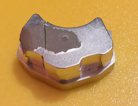

Super magnets that could take out a finger:

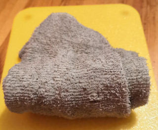

Wrap magnets in rag to control power and reduce impact damage:
