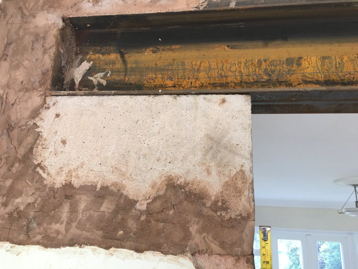

Under the padstone I have 37 MM. of mortar? Is it bad practice? Picture attached

Not ideal - the thinner the mortar the better. Doesn't necessarily mean it will fail, though.

No, 37mm is bad practice. It should be packed with something such as tile, slate or steel. Or better still, the brickwork built up properly.
I've seen some pretty hefty, make-up muck spreading when setting out a building on dodgy (out of level) foundations, so no, it is unlikely to fail. Especially as there is plenty of bearing. It is frowned upon by those naïve blokes who have letters after their name.

I should be OK to get this through a certification from building control?
There was some slate to back the mortar not the mortar.
The pad stone is large and its 2.4metres opening.

Strictly speaking, there shouldn't be any mortar between the padstone and the underside of the steel.
But that's just being anal - the inspector is unlikely to fail it (at least the ones we use wouldn't)
