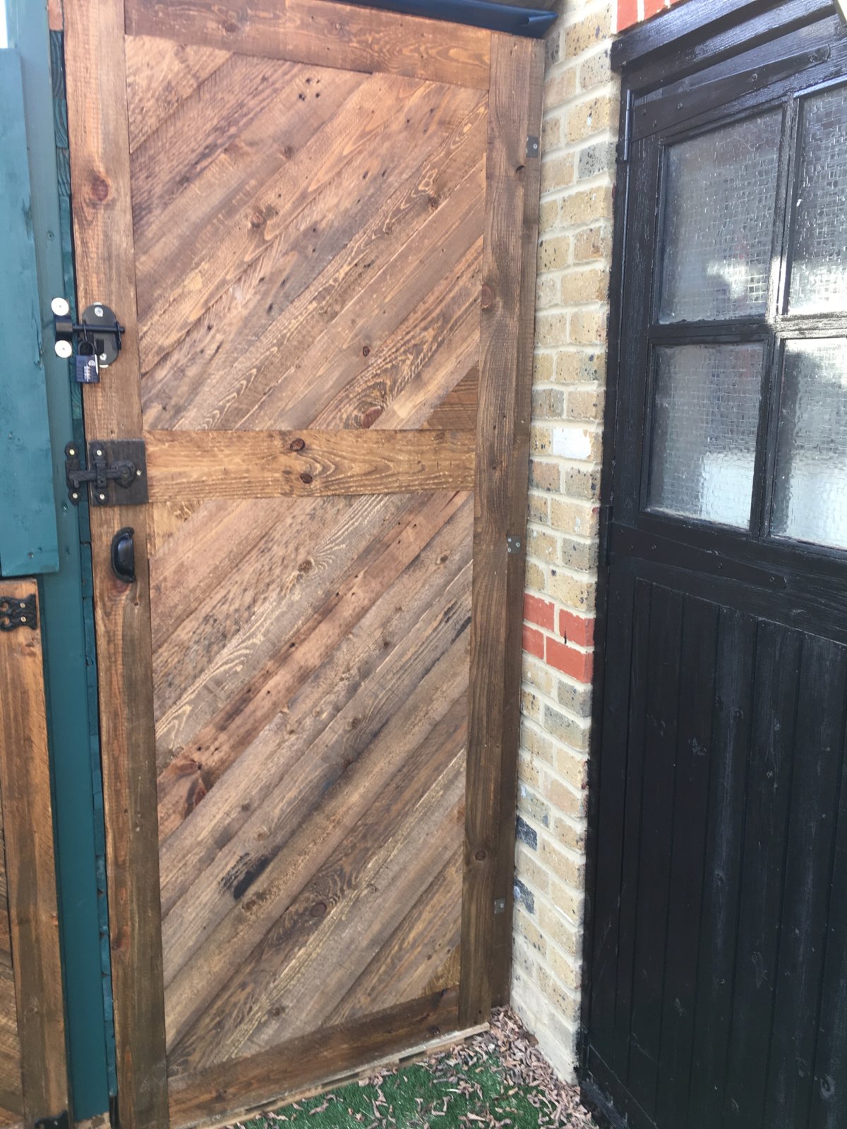

952966B0-DD6D-4880-A50C-81EDE4A7B53E.jpeg Couple of offcuts of 12mm ply and a free pallet or two for mine .
