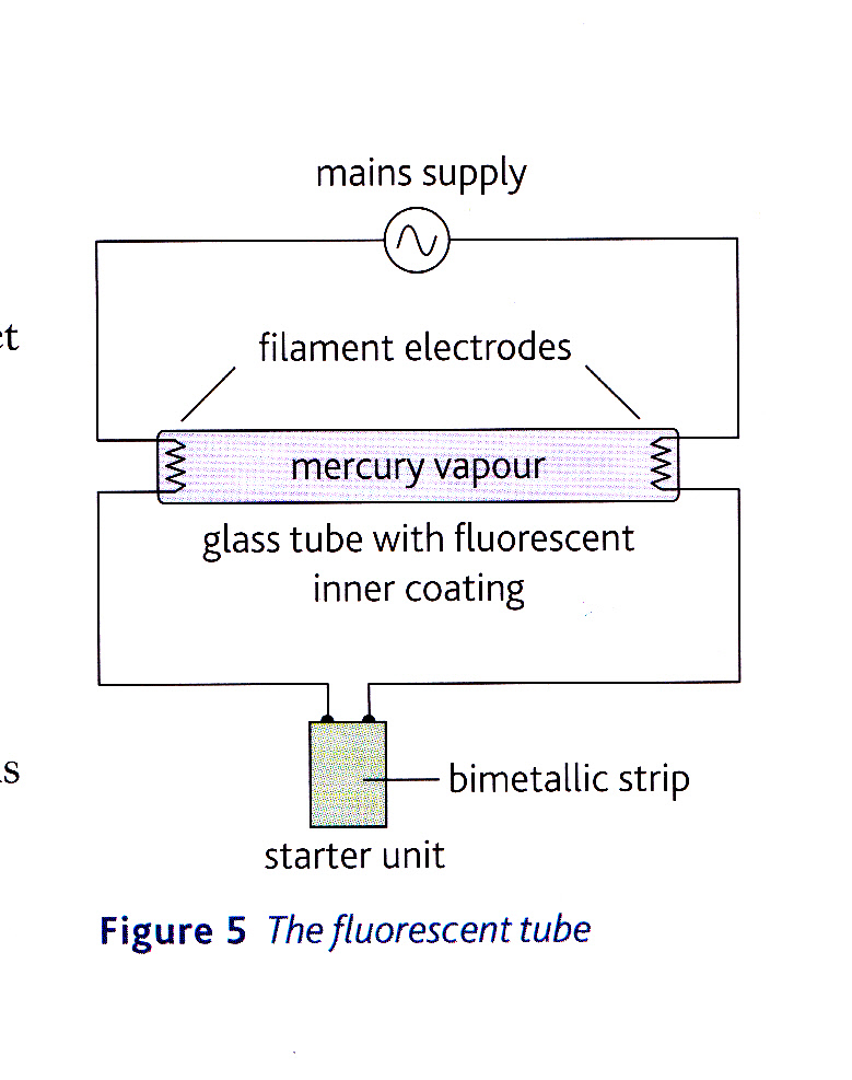

Taken from 'A' level text book, is there any way it can work without a ballast?
I suspect they have left a rectangle out of the diagram that represents the ballast.
I would think it would burn out the heaters, but if it did strike, then there is no current limiting, so yes could very likely go bang. One has to ask how some thing like this arrives in a text book? Don't they have any proof readers?
I installed some PL fittings in a pub it must be 15+ years ago and they contained no control gear. Still to this day have not seen this type of fitting again, nor understood how it worked.
We installed several fittings would have been 70's which were in service for a long time, certainly well into 90's or possibly 00's which looked exactly like this. A 2 part box just big enough for a starter and connector and a pair of super slim arms for the tube holders about 3" below the ceiling. Instructions warrned about the heat and not to mount on papered ceilings and a massive warning about polystyrene tiles. No I never did know how they worked until we refurbed, it turned out the red and black wires [L&N] were around 40Ω each. I only recall changing tubes once and that was because one got broken and the improved light level made us realise how they had deteriated.

Yep, I have come across resistive 'ballasts' before. They were very wasteful of power, so replaced with much more efficient inductive ballasts. There is nothing in the diagram, which suggests it uses restive ballasts.
