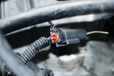

I have included an image of the connector. I have clipped the electrical wire that was connected to the starter.
The part that appears to separate from the connector is the visible part with the red and white wire entering it.
It looks ragged because I have been trying to get it appart with pliers. There was a plastic harness over the
visible end of the connector. That is what is some what torn up.
On top of this the body of the connector was attached to a metal braket. That has a clip that protrudes inside
a slot in the connector. I broke of the bracket trying to get the connector separated from it. I have seen a lot of
these connectors. This is by far the most difficult to figure out.
For sure, these things can be a right pain - sometimes things are more difficult due to corrosion ingress or electrical overheating.
Still, it's not the end of the world, I'd try looking for a similar connector elsewhere on the vehicle which is possibly easier to investigate or slide a thin blade screwdriver between the top of the lighter grey socket and the black plug.
There's every chance the electrical connection won't be compromised but you can always solder a bullet connector on in place of the original.
Good luck with it!
John :)

Usually there will be a release tab to press to enable it to be parted, a small screwdriver may be needed now to act as a lever to release it if that tab is broken. May be easier to cut it off and properly crimp some connectors on there.
Id have cut it off within seconds probably :LOL:

It does look like the black tab at the top, needs to be squeezed slightly down towards the wire. Sometimes I find that you need to push the two halves of the connector further INTO each other, ever so slightly, to take the pressure off the plastic barb that's preventing them from coming apart, and THEN press the tongue down and pull at the same time.
Does this look like it's the same animal? I so, you can see the locking barb that needs to be pressed down.
If it won't pull apart.
Very very carefully cut/split the outer casing and peel it back, open.
