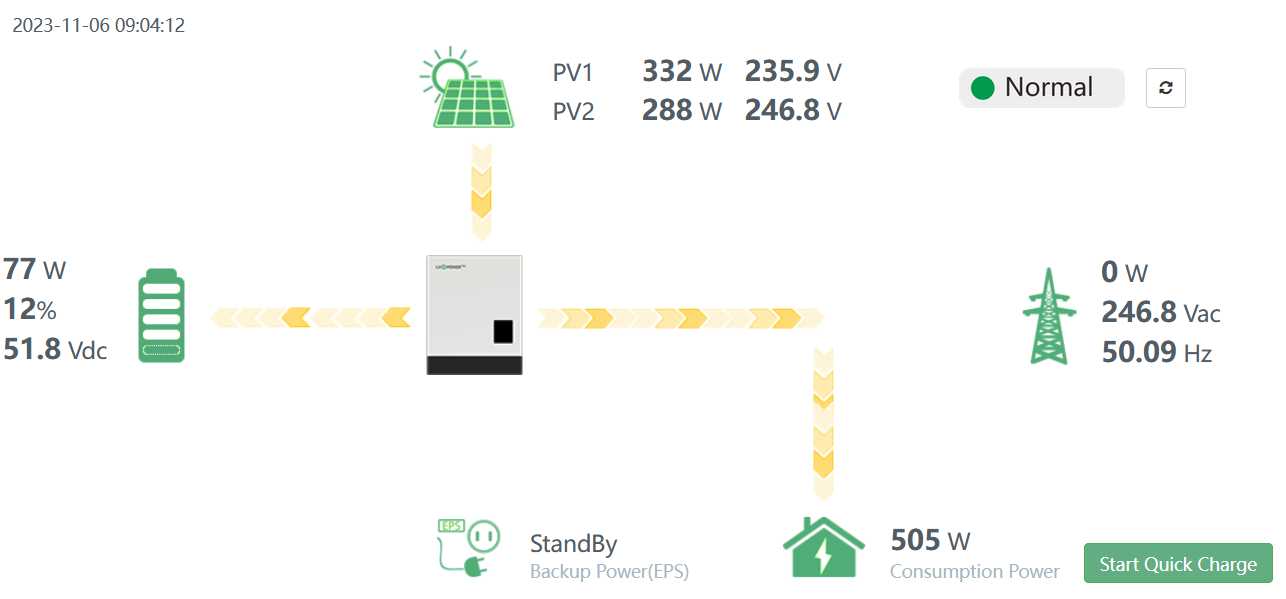

I have I think 14 panels on the roof and this is how there are doing now. The question is how many panels would you need, the ones I
have are split into two banks of 7 so to get around 230 volt it would need a fair few panels. As the day goes on the output increases, worse day this month was 7.5 kWh I found to have hot water before solar was installed in the summer for hand washing only I needed to run the boiler 3 times a week for 30 minutes a time, in the main only ran for 20 minutes but water more like warm to hot.
So 20 kW boiler for an hour to maintain the water temperature over a week. So would consider you need about 3 kWh a day. so 1/3 of the power I got on the worst day, best day this month 10 kWh so 1/4 so would need 3 to 4 panels in winter. I am in mid wales. 240 volt / 7 x 3 = 100 volt, a 3 kw immersion at 100 volt is around 500 watt, so yes it does seem about right, but seems rather an expensive project, not sure how the thermostat will work with DC and I am looking at November, I got 481.6 kWh last month so averaged 15.5 kWh per day so three panels around 3.3 kW per day, not had solar before that to be able to give figures.
