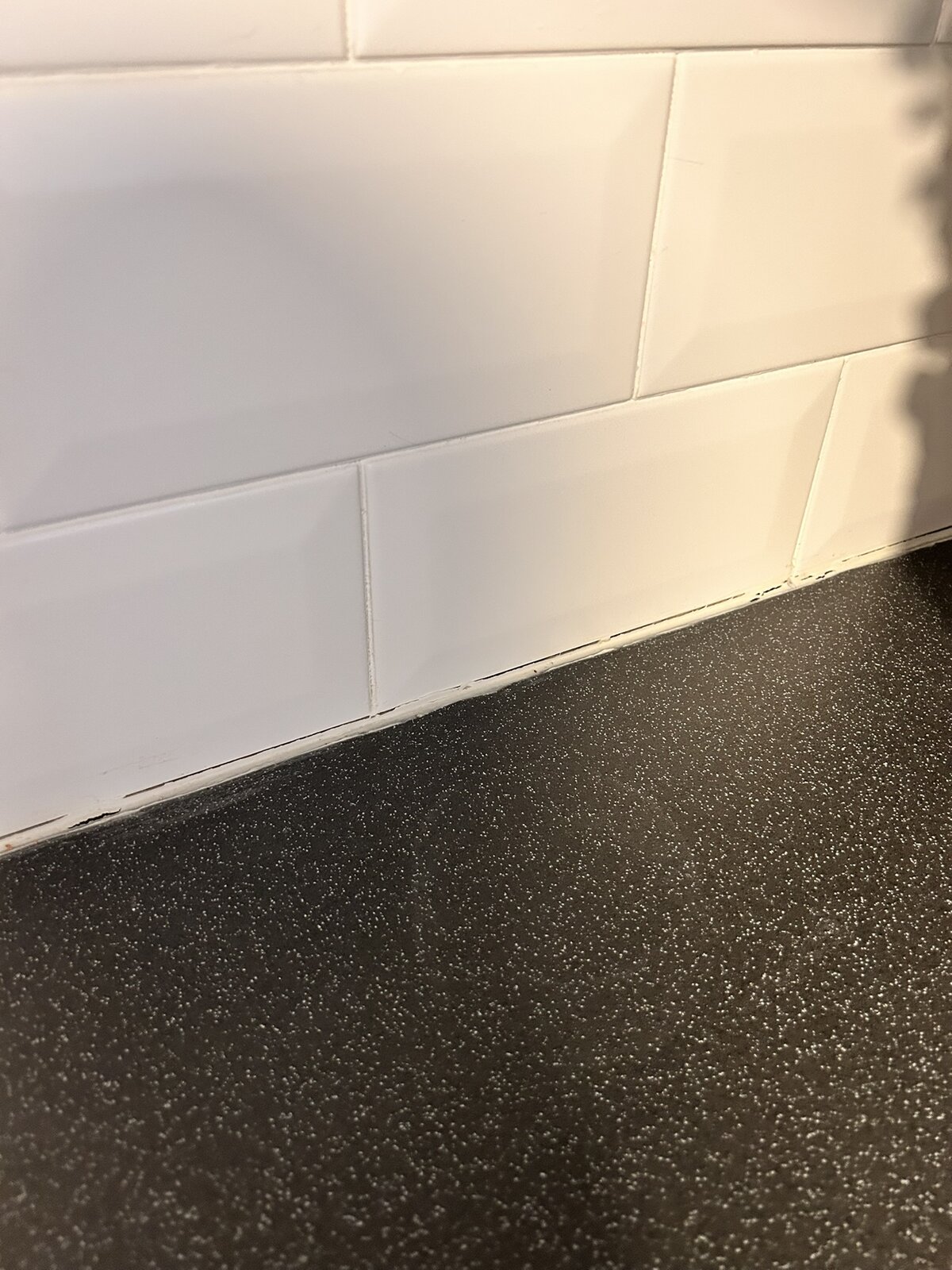

Hello, so around 6 months ago I re-tiled our kitchen. The tiles go down to just above the existing worktop as they had done before, so there was a gap to fill which varies from about 2mm to 4mm at the most. I looked online for ideas and decided on using standard white kitchen sealant to do the job. It looked great at first and for a while, but has now started to "pull apart". This is along most of the length now, apart from a couple of areas which are still OK. I'm going to remove it all soon as it looks very unsightly but I don't know what to replace it with. Should I try sealant again but using a much larger bead, or something else like small plastic trim? I'm not really sure why this has happened as I don't think the worktop has moved (and certainly not the tiles :LOL:) Any ideas welcomed. Thank you

You have to make sure the surfaces are really clean before applying. Get rid of any grease/dirt etc....plenty of good vids on youtube about that.
Use silicone again, but use a much bigger bead to allow it to adhere better to the tiles and the worktop. The bead you used looks too small.
Use a profile tool to get a nice finish.
What's the difference between kitchen sealant and bathroom sealant? I'm not sure, but you want a high flexibility one so it doesn't end up looking like your first effort.
As above, you need a bigger bead, and a shaped tool ! When shaping your profile, with those bevelled ' metro' type tiles you have to take care to make sure you get more of it on the tile than than the worktop.
And it's not ' difference between kitchen sealant and bathroom sealant' you need to know - it's the difference between ' sealant' and ' silicone' :- two entirely different things. Make sure it's Silicone you use; it's softer and more flexible than most sealants.
Yes, it doesn't look like he's used silicone first time around. If the existing sealant is stable it could be argued that it's doing a good job filling the void and it will be easier just to leave it there. The size of bead you want will be enough to cover at least 5mm above the bottom of the tiles, so it will be quite a large bead.
When you're running the profile tool along, watch out for the gaps between the tiles and try to move smoothly past them, otherwise you will get indentations in your silicone.
Thank you all for the advice, much appreciated! I’m going to try again using the silicone and the techniques above

Just wanted to pass on, don't have a photo to hand, but I replaced the join as advised then tidied up with a sharp blade and it looks amazing :-D No sign of any movement either. Thanks everyone
