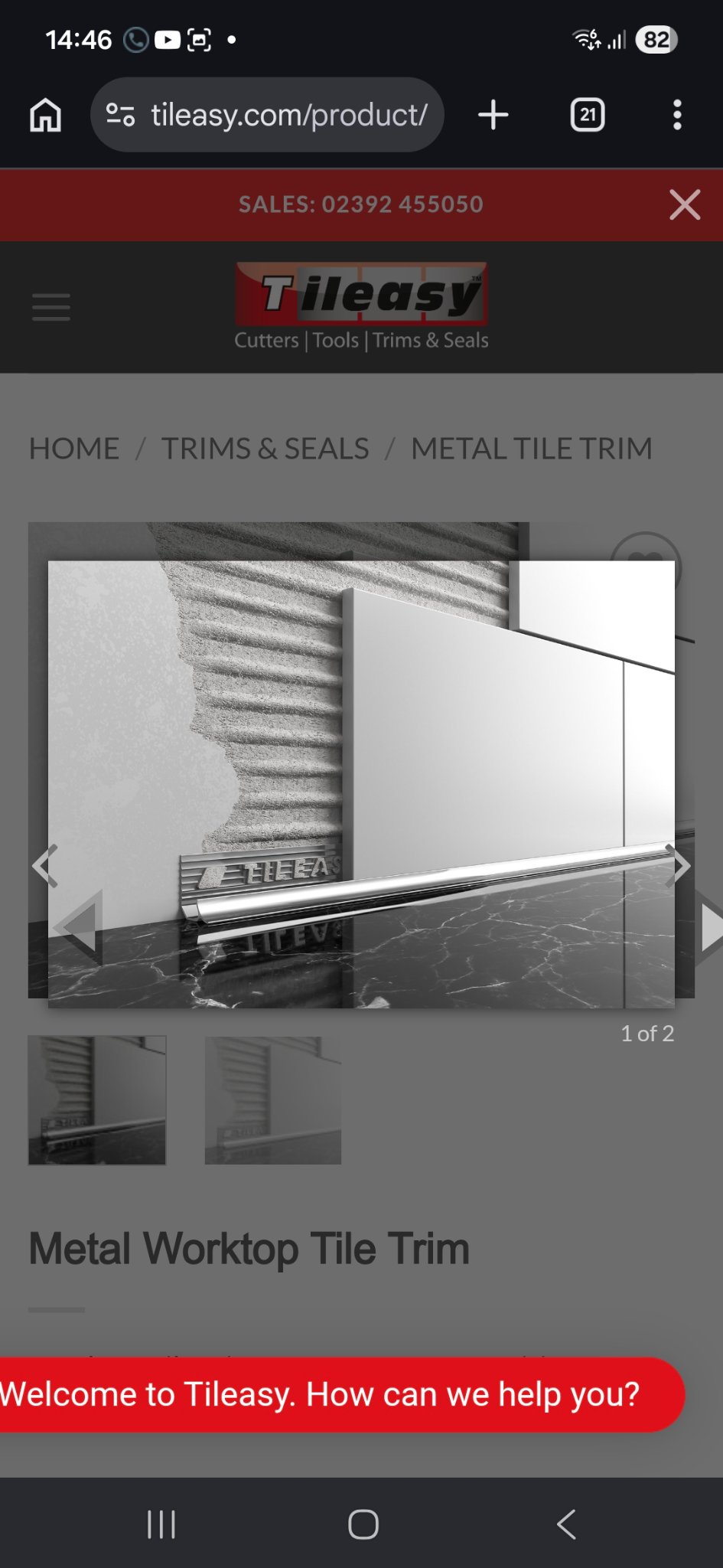

Getting above kitchen worktops re tiled.
There was a tile trim.along worktop. Upon removing tiles there is a 15mm gap at back of worktop which is what trim was for.
I cannot find these trims. Anyone know where to get thrm or another way of doinv it to cover the gap ?

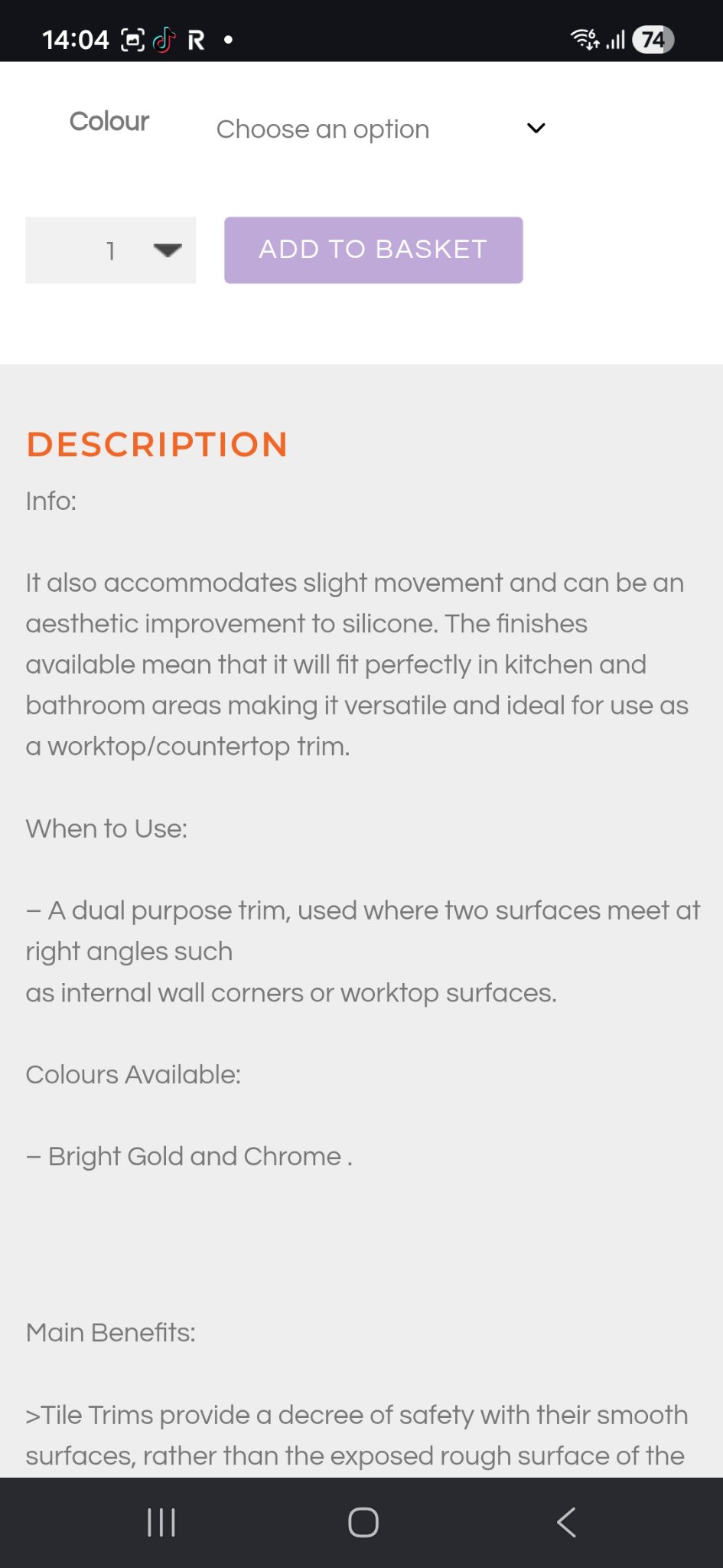

This would work and match the crome l trime I have. This site doesbt show prices amd these seem hard to find anywhere else.
Anyone know a website what sells them for delivery ?

You do not silicone with the trim it seals it.

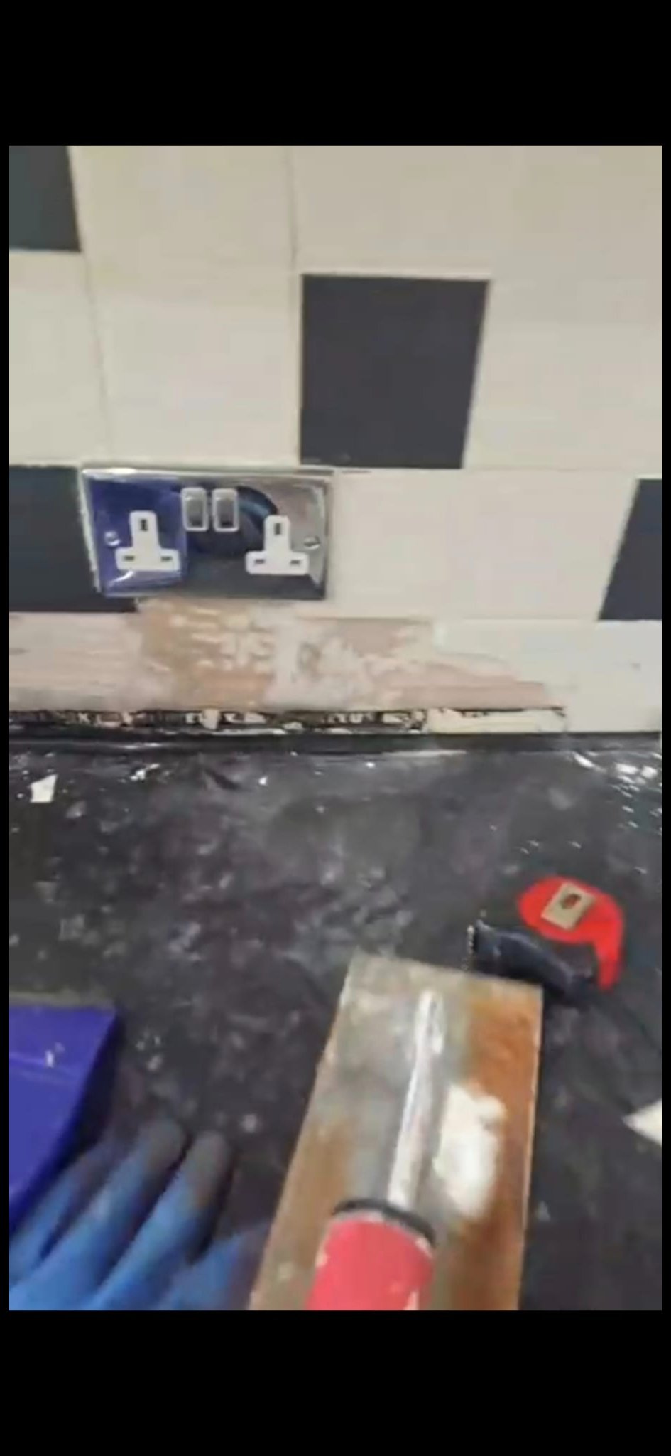

Tiles are metro . Worried about the finish using cardboard to build out that much. Still would need to get bigger trim for sides I think
The trims won’t seal it :- I’m assuming there’s a sink somewhere in the worktop that will need silicone on the bottom row of tiles behind the taps ?
With an 8mm notched trowel ( condensing to 5 or 6mm after you have pressed in) + a 7mm tile, you are only a couple of mm short ( thickness of a silicone bead ).
You could even take that up with some small “ dabs “ on the back of the tiles at the biggest gap. It’s hard to advise without knowing how plumb your wall is.
However, given the fact that it is Metros you are fitting, I’d be inclined to fix the wall properly before you start- either thin plasterboard or 6mm Hardie.
With respect, a ‘newbie’ tiler will never be able to pull off a 200x100 metro brick effect wall on a substrate that is not plumb or straight ( i.e. not curved on the horizontal plane) without highly visible Lippage.
Had same problem recently, also with metros. As suggested by others, I used 6mm jackoboard, the foam type, easy to cut.
Stick to the wall with tile adhesive and notched trowel, to take out any deviation.
Get a straight edge against it to ensure it's all flat. It's worth taking the time to fiddle with it to get it right.
