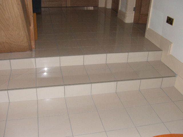

We have a step down in the downstairs loo - I have tiled the floor.
Any ideas how to tile the step - i.e. how to finish off the step edge ?
Plastic corner ? will this not wear and discolour ?
some sort of tile corner ?
or can you get floor tiles with a finished end ?
Any ideas ?

... I did the step using B&Q aluminium tile edging. Used a square edge profile to increase visibility of the step edge. Kept the tile flush with the strip edge (rather than push the tile into the edging strip) so there is no raised edge. Stuffed tile cement / grout into the edging strip to strengthen it.
