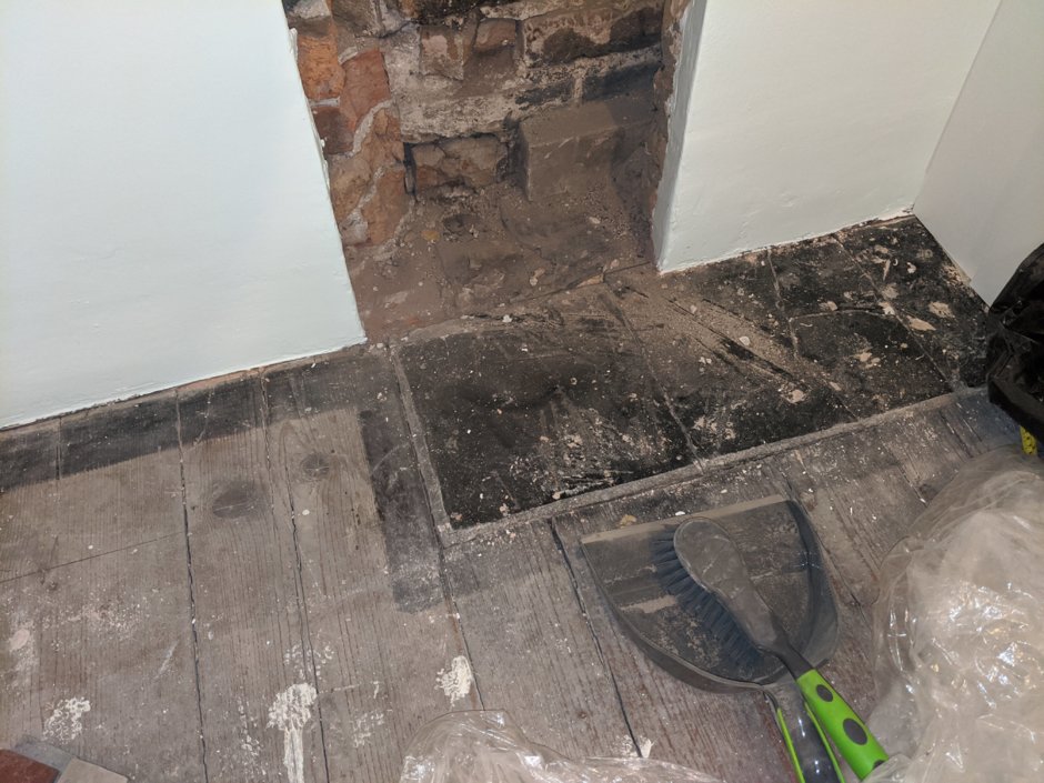

Hello,
Looking to do a bit of tiling but am a bit stuck where to start.
The area we are looking to tiling is part floorboard, stone and brick and I am not sure on the best option for it.
My ideas:
- Backerboard on the floorboard and then tile adhesive to level across all 3 surfaces
- Self leveling compound across all 3 surfaces and then tiling on top
- Use decoupling material across all 3 surfaces and then tile on top
What would be the best or am I missing the mark completely?
I've uploaded an image of the surfaces I want to cover, obviously need a bit of cleaning beforehand!
Thanks @foxhole how would you attach the board to the stone on the right? Bricks are in the fireplace area, intending to tile that section too as it will not be a functional fireplace.
