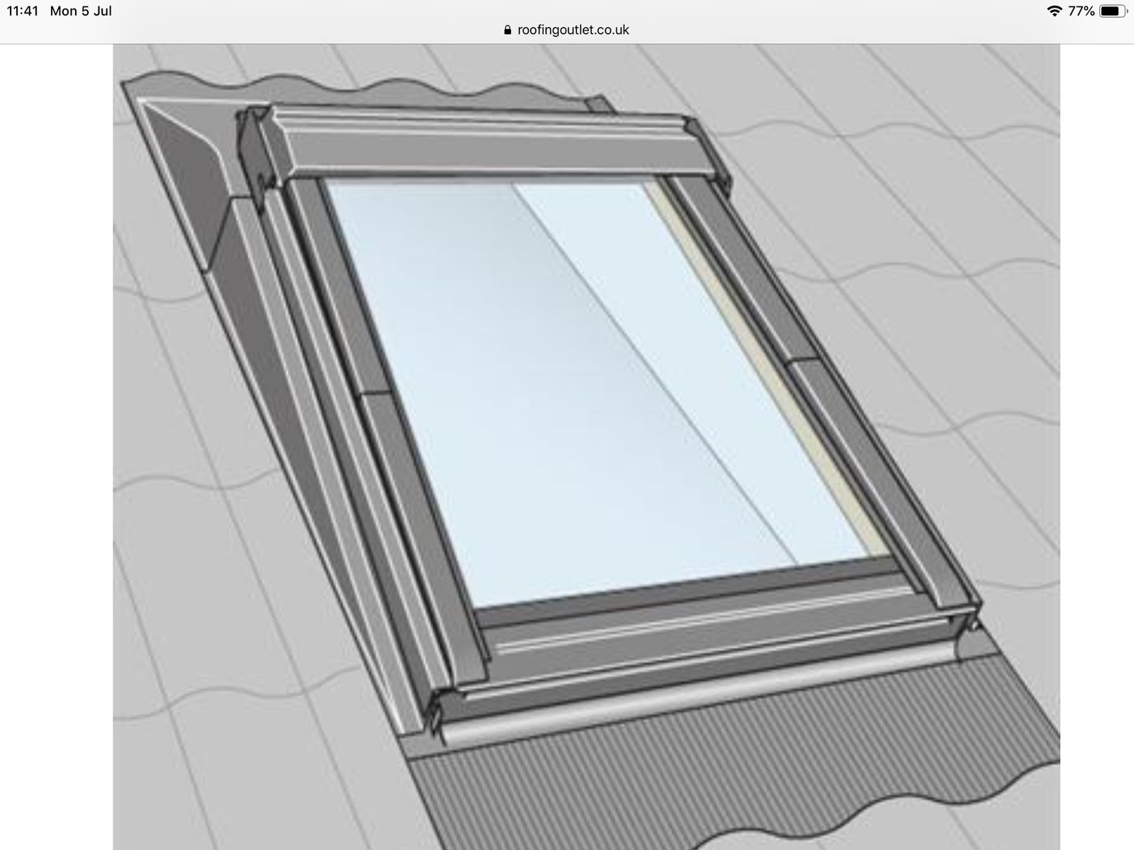

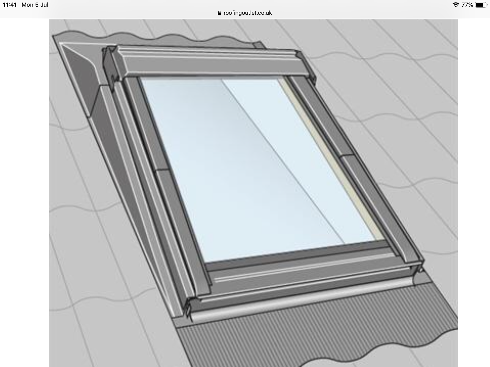

tiling around two velux windows look messy, is it done correctly?

Should there be a small flashing under each tile rather than a single long one under all 3 tiles?

These look like Marley Modern roof tiles which have a minimum-pitch requirement of 17.5 degrees.
A standard Velux installation can go as low as 15 degrees but it’s not recommended.
You need to contact the Architect/Specifier, rather than blame the trades, because I think he has recommended the wrong model and wrong flashing kit for this solution. If I were specifying this job, I would have chosen this solution...
