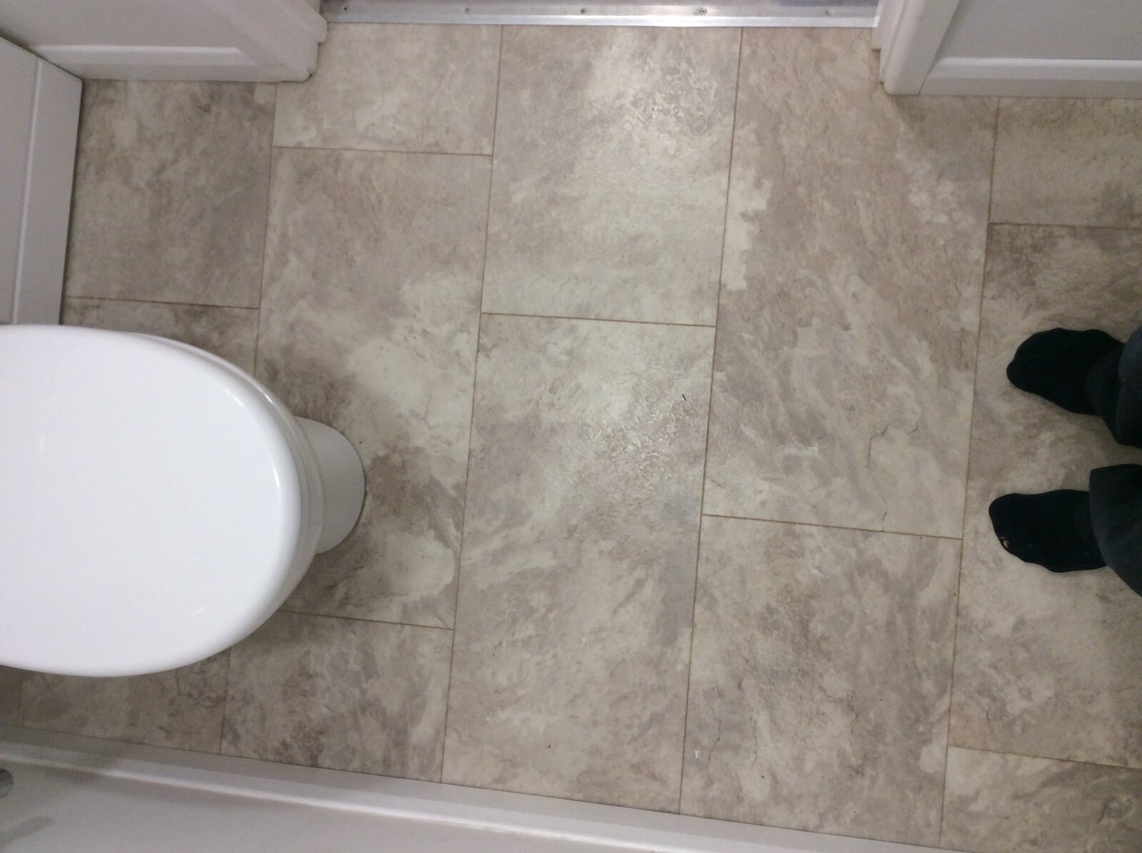

I am tiling my downstairs toilet. Tiles will be laid on concrete floor. I am looking some guidance regarding tile pattern. The pattern that fits the best at this area in my opinion is this one:
What do you guys think of this pattern? Can you give my any advice or guidance on how to do it 1st time and do it right? Thanks.
Your solution would be the easiest, but not the best looking.
You could go the other way, horizontally in the picture and see how you go for cuts.
I tried going the other way and I did not really like how it looks cause the 3 line of tiles would have to be cut almost in half an it looked a bit odd and not symmetrical. If I would try to make it symmetrical horizontalally it would even look worse as tiles would have to be cut on both sides...
theyr’e the wrong tiles for the room . i’d cut them so the join is in the middle.
more waste but hardly a huge waste.

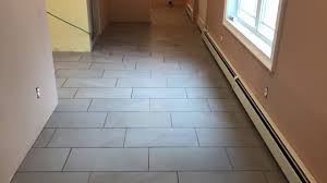

Not unlike my 1/3rd split suggestion, and your pic is better than my stock photo
