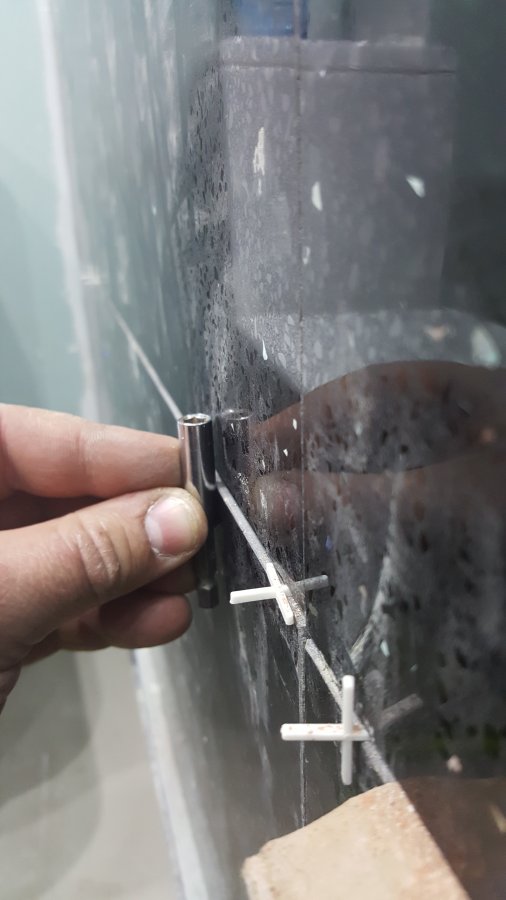

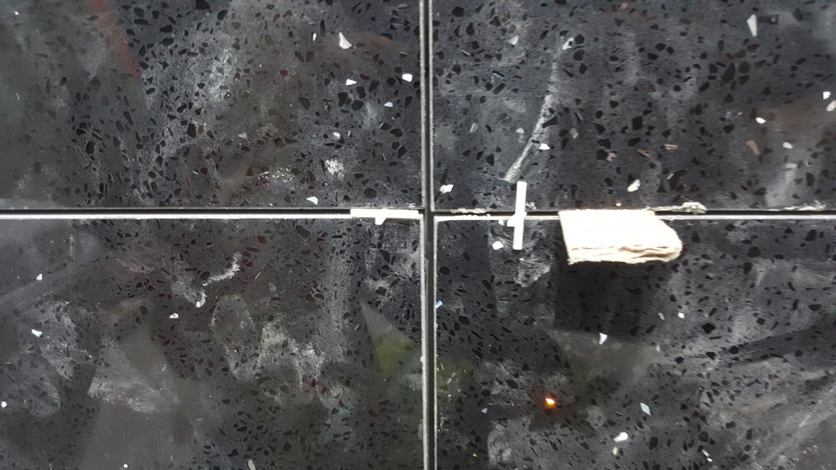

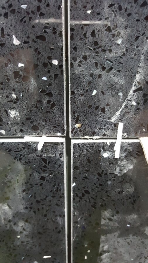

I have a workers in bathroom. They ask for 2850 for preparing, tiling, and install bath shower and basin. Bathroom size 2x2.3m . I pay for all materials.
They put already about 4 sqm.
Please see pictures and and say what do you thing about it?
I took photo the worst tiles but there many of them which looks similar.
How large are the tilesm and how level was the wall to start with. Big tiles are more difficult to get right, but the last picture shows that they aren't even getting the veritcal lines even, unless it's an adjustment from the other end of course. But that sounds like a high figure for just labour.
Tiles are 300x600mm. They prepared floor and and walls to get perfect level. New plaster boards leveled floor and new celling.
Titles spacers are 1.5mm. That on picture has about 3mm.
No excuses for such a bad job, for the price you are paying this is absolutely insulting, I wouldn't even get any cowboys to do such like workmanship even for free, as it would bugger up my expensive tiles.
Just tell them to do it right or if they can't then leave, as they will end up ruining your material. Don't accept any excuses if they say your walls are not straight, it is their job to do it right, don't pay them anything, if they get stroppy or threatening you can always call the police.

A mate of mine is having his bathroom refitted with new floor and wall tiles, taking the bath tub out and instead having a shower fitted, new pan, new sink, all for A GRAND for labour, and \i have already seen the work, its a lot better than yours!
I think Mike has made a very good point, so little add there, except to suggest I would have laid the tiles in a brick bond pattern, and on a tile that size and edge shape, the spacers should be at least 3mm to get a good grout line. 1.5mm (and less for the one on it's side, and the grout will be flat in some places, and dipped in others.
If they're carefull, the should get the tiles off safely, and they, or someone else preferably, can start again.
I agree Doggit, larger size tiles look better when laid in brick work pattern. on many modern tiles they tend not to have any gaps and they seem like joined against each other without a gap, hence no grouting required, I am not sure if they actually do fill any grout.
I've seen it where it appears that there's no grout, but you need very consistant sized tiles for that, and you'd need some way of sealng them in a bathroom, otherwise the higher moisture level would creep through the gaps.
