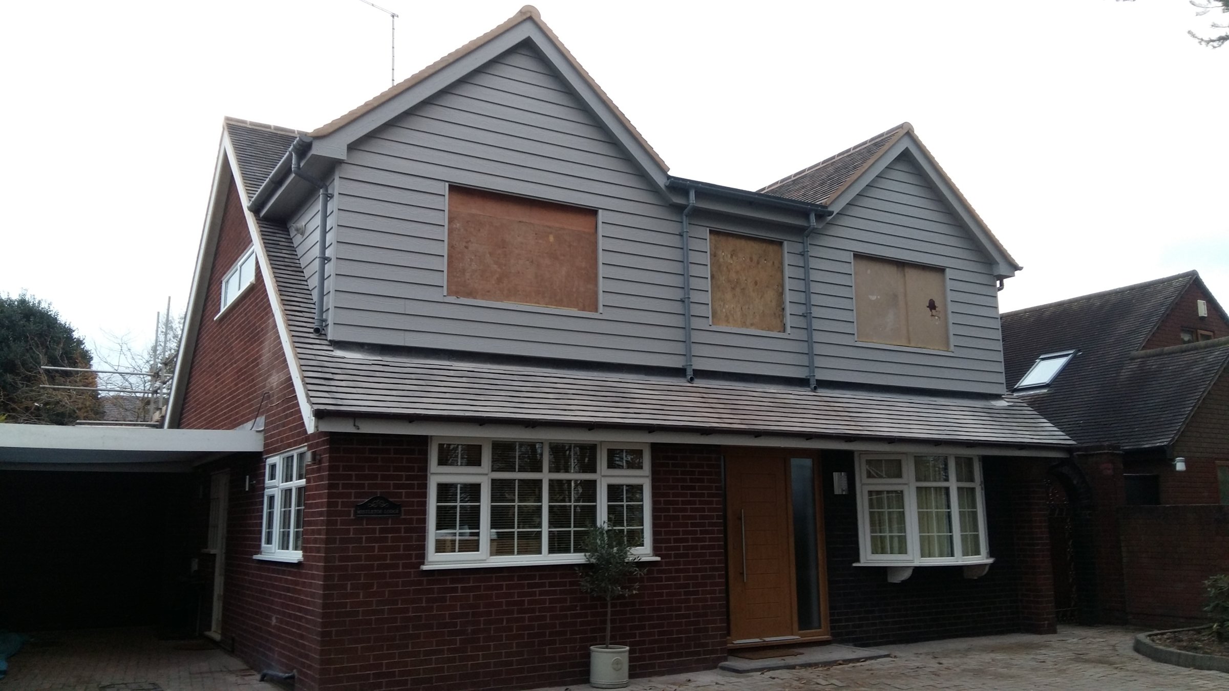

Not the battens, the cladding was overlapped, similar to the op‘s image.
Oh ok I get you, I guess it wouldn’t be 44mm though as that would assume no overlap with feather edge boards. Probably more like 30-35mm depending on size of overlap but still heafty battens.

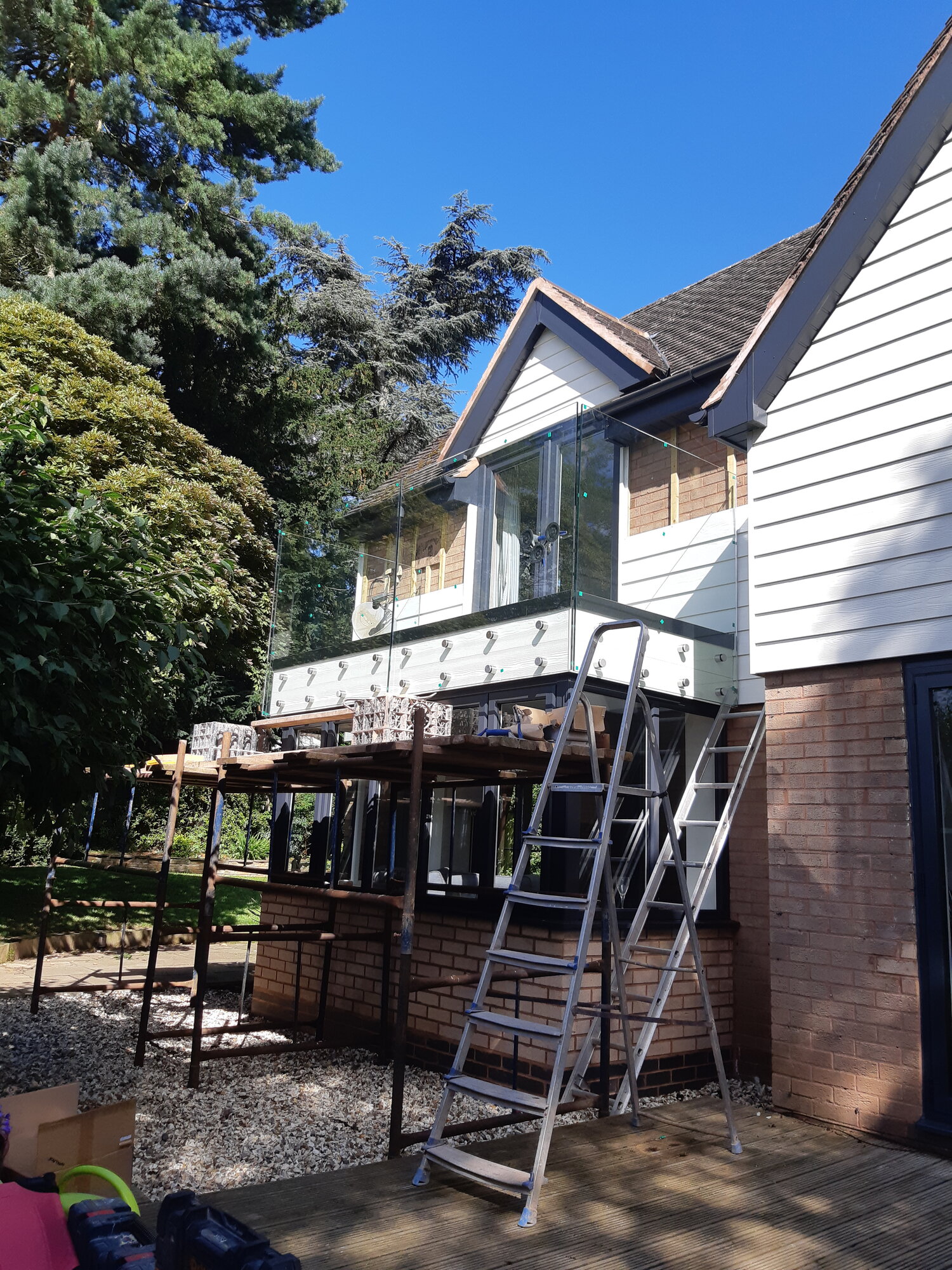

FWIW mine was just planks, not feather edged. The planks are fairly heavy and with a fair few on the wall 15/16 tall, and they are wide 250mm.
Haven't used Cedral, but have used cembrit weatherboard plank https://www.cembrit.co.uk/cladding-panels/wood-look/plank which is available in a range of colours. My local merchant (cwberry leyland) stocks a good few colours and has trims to match. It's easy to put up and very DIYable provided you buy or hire a guillotine and gecko gauges. The manufacturers provide very detailed installation guides. For cutting odd angles etc, I find a wet tile cutter works quite well. It has a tendency to very quickly blunt saw blades.
You can nail it, but cembrit supply special screws which are recommended. Merchant told me their cembrit rep said there had been a big problem on a local estate where nails had worked out over time through thermal movement. The screws are self-drilling but I find it is quicker and easier to push a 3mm pilot in first rather than spinning the screw until it bites. https://www.cwberry.com/Building-Ma.../Cembrit-Zytex-Screws-for-Timber_02252811.htm
I'd recommend a few spots of mastic on the overlaps to stop it rattling in the wind when installing it.
Agree, good brushing down with a stiff bristled brush (e.g. https://www.toolstation.com/stiff-general-purpose-brush/p97606 and/or https://www.toolstation.com/industrial-stiff-yard-broom-with-handle/p29500). Make sure any bare timber is back to solid wood.
The treatment - ideally ought to be proper 'Creosote', very difficult to find nowadays or a mix of creosote and Bitchumastic. You need a liquid to soak into the timber. Modern wood preservatives just don't last as long.
