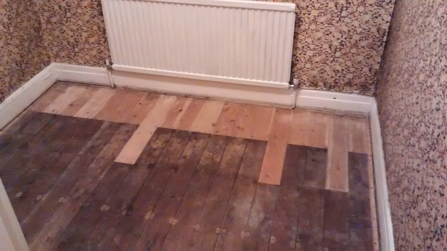

Here's a photo of the small room - the darker boards appear to be the same as those in the bedroom.
Is there damp/mould bottom of the wall right-hand side corner? The wall paper looks dark (maybe just photo)
You can hire a belt sander and sand the floorboards, quite quick, it's been a long time since I did one, but you could sand it in a day.
If it's ground floor, you could add insulation underneath... if you can be arsed to lift the boards:eek:.
Presume the boards may have been renewed due to rot?!, you could do with taking a peek underneath.

Yeah, house has mould issues, but I think all is condensation mould. Looks like there was a leak of sorts in that room pictured, as the skirting on the left is swollen. But, I peaked through a small gap in the floorboards and all looks (and smells) dry underneath now. The house is 1930s solid wall construction. I think that this room was closed up for ages, as was the WC, and maybe our bedroom too.

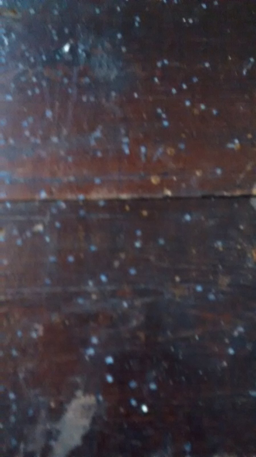

OK, carpet out, bleached, scrubbed, bleached, mopped, dried. Smells fresher, but still some hint if mould, could be wallpaper. But what are these blue marks? Mould, paint, bleach stains of something else? Might just live with it the way it is, after stripping the wallpaper and decorating..... Although, it would be a good time to put in insulation...., but wife not happy about sleeping in the dining room!
