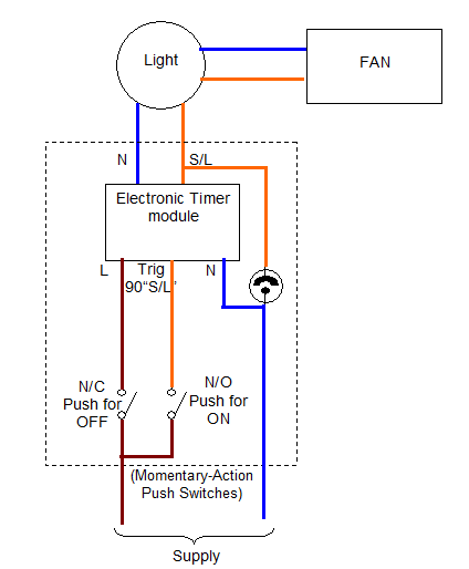

My first reaction was to think very laterally, but in a way that would probably require some re-wiring, and certainly modification of a fan, and some 'bespoke' components! - but, for what it's worth ....
If it is (or could be) a timer fan, then (assuming that it's timer module could cope with the small additional load of an LED light), then one could 'modify' it such that the light was supplied by the output of the timer module. Triggering the timer would then result in both light and fan coming on for the period of time determined by the timer module.
That 'triggering' could be done by a momentary action press switch supplying power to the S/L of the fan. Again, it's the 'switching off' that might be a problem. I haven't yet experimented to see, but it's quite possible that momentarily interrupting the permanent live to the fan timer will put it into it[s 'off state'- and, if that's the case, that could be achieved with a second ('push to break') momentary-action press switch. The two press switches plus a neon could probably be done with grid modules (or with individual components, a blank faceplate and a drill :-) ).
... but I imagine you are hoping for a much simpler solution than that :-)
Kind Regards, John

To get a light on the switch with no neutral, series LED modules are available, it just means 3V is lost for the load.
... My first reaction was to think very laterally, but in a way that would probably require some re-wiring, and certainly modification of a fan, and some 'bespoke' components! - but, for what it's worth ....
When I came to draw it, I realised that if one wanted to have the indicator (neon or whatever) one would need 4C (+E, to be regs-compliant!) cable to the switch box.
However, I then realised that if one put an electronic timer module (maybe even one stolen from, or intended for, a timer fan!) in the switch box, one would only need 2-core (+E !) cable to/from the switch box, and wouldn't need a time fan - something like the below, although I'm sure you would prefer a simpler, essentially off-the-shelf, solution (and no 're-wiring') ....
Kind Regards, John

Fair enough - but as I and others have said, the one of your (or your MIL's!) requirements that is unlikely to be saisfied by any sort of off-the-shelf time-lag switch is the ability to switch off the light/fan before the timed period has ended - hence my suggestions (if you/she really needs that 'Off' facility, which would not seem, to me, to be particularly crucial) :)
Kind Regards, John
