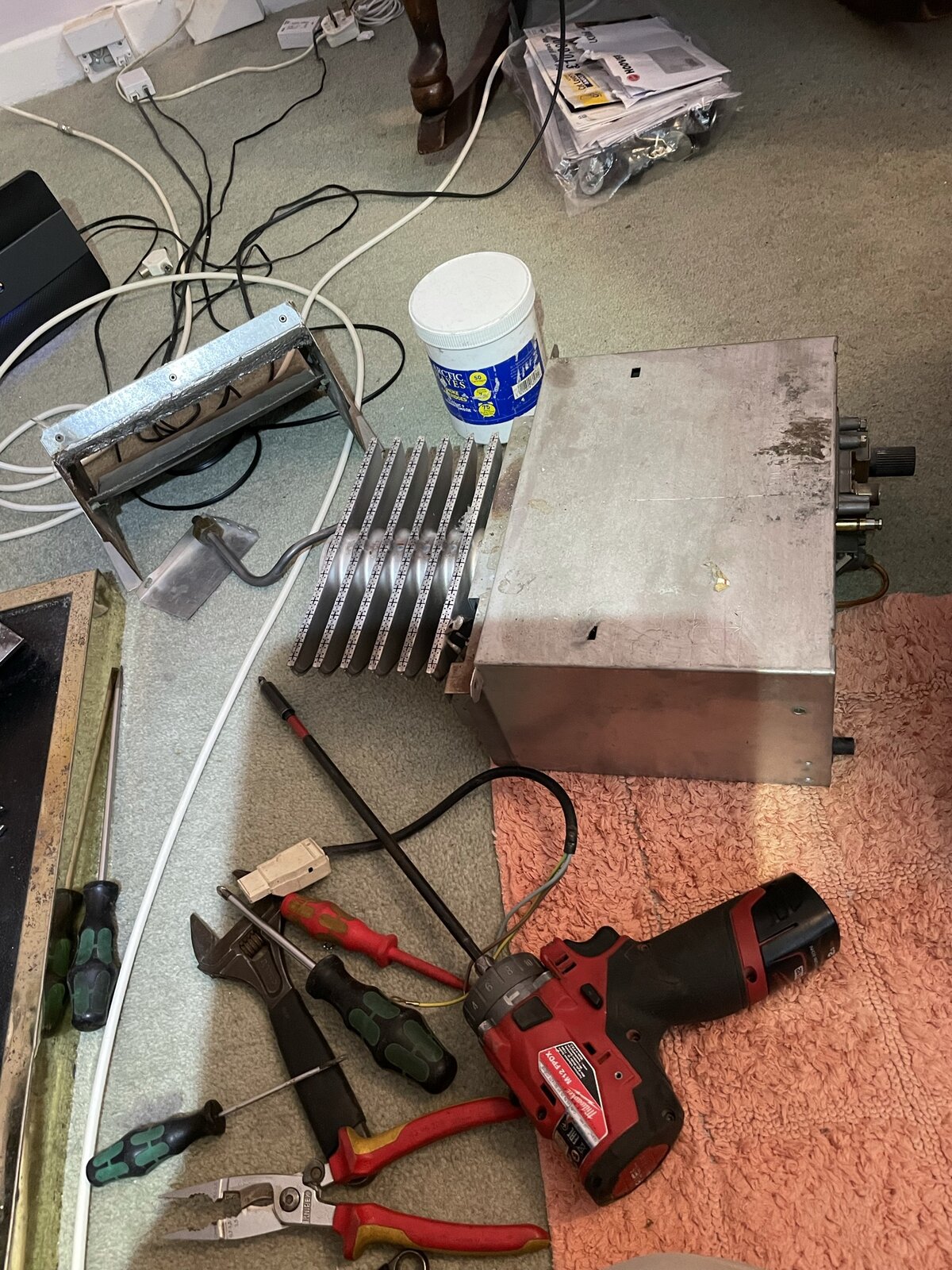

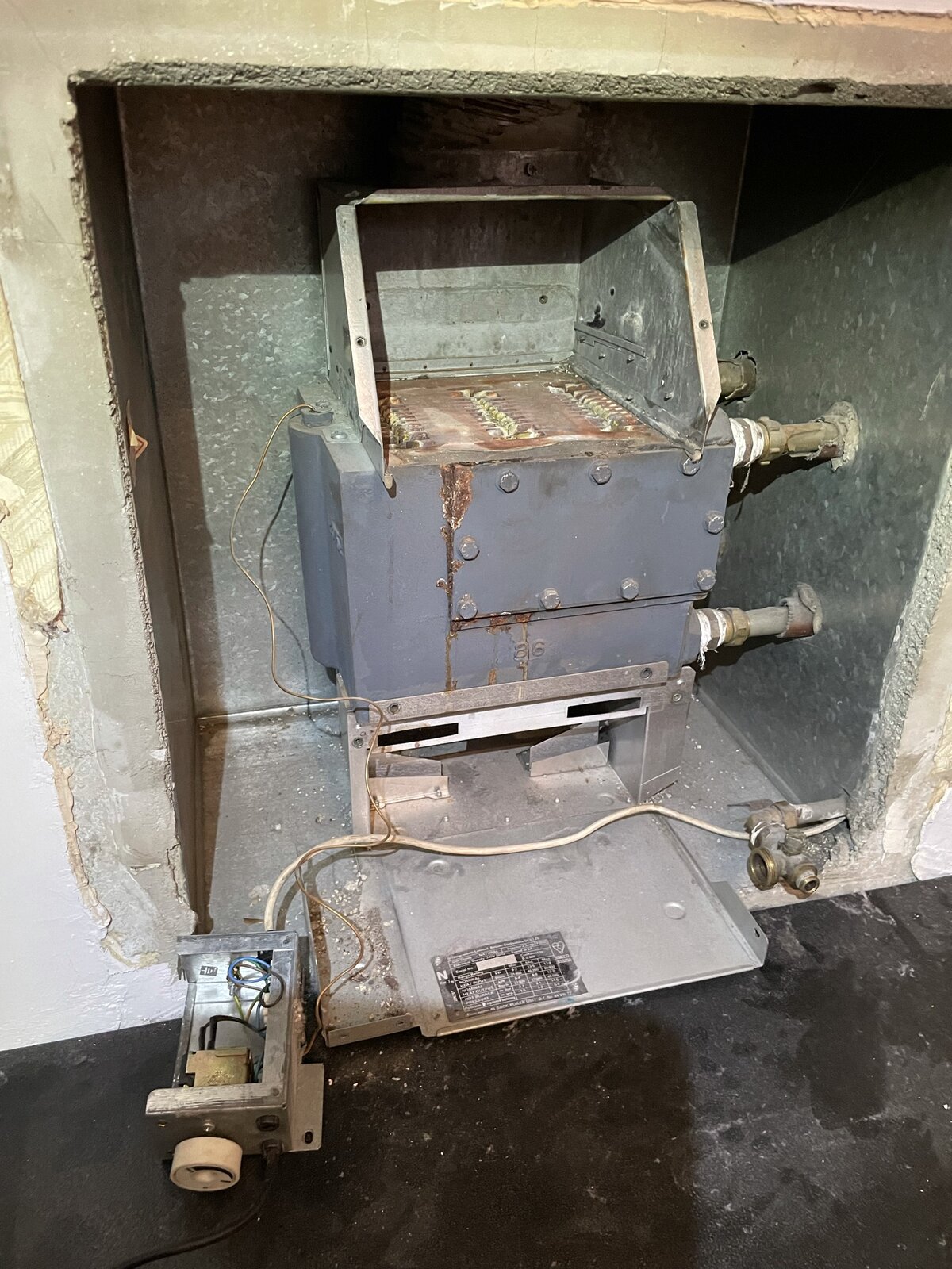

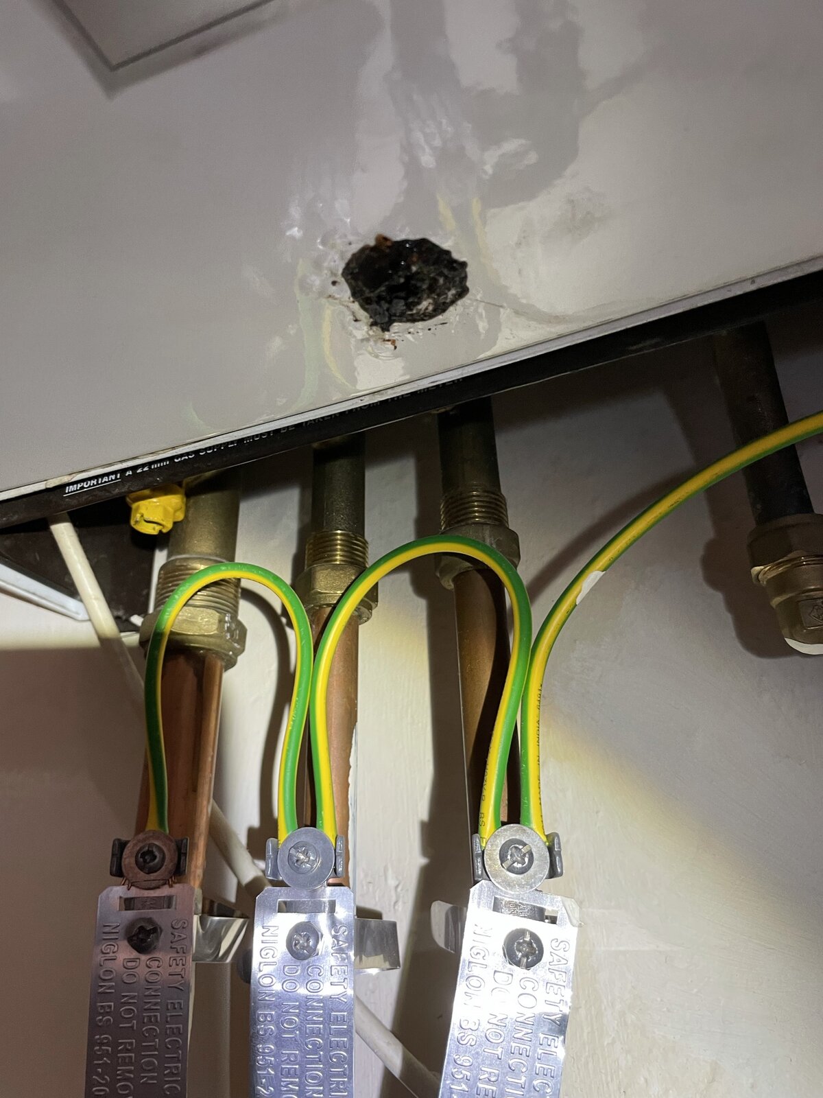

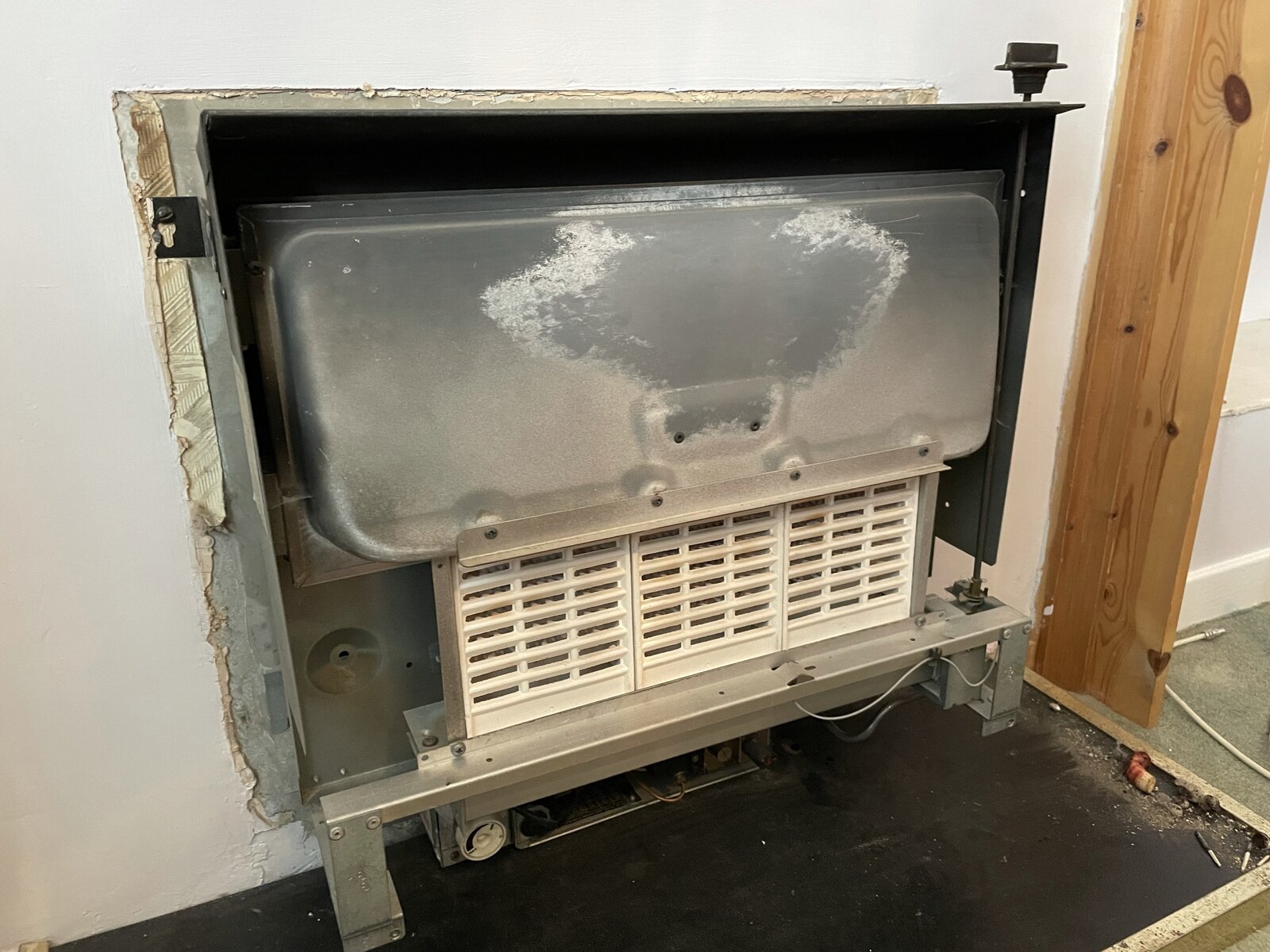

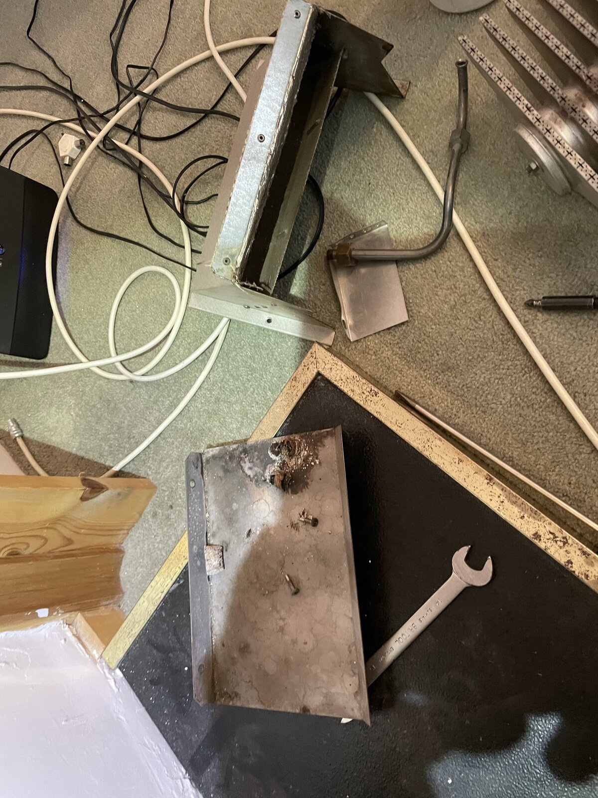

I too service condensing boilers that are easily 15 years old. Examples are ideal icos, Isar, vokeras to name three. Similarly have removed others that are not yet 10 years old ( Alpha, Ariston, Glow worm that was much older though) and that is me being mostly a repairer and sometimes a boiler changer. Yet have boiler that are at times older than 30 years ( Flowmatic, Potterton Netaheat etc).
Here are some examples
