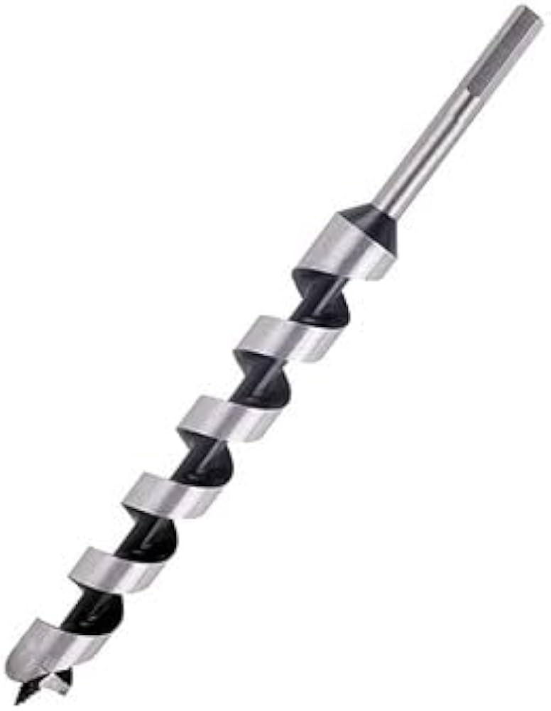

Yes it’s set in postcrete. I managed to use wood drill bit that’s 300mm long and just keep drilling and shaving it down have got to about 380mm deep so far. Need to get a long drill bit currently use the one pictured below that looks like a spade at the tip. I’ve come across long drill bits that are just like a round drills with threads as pictured below too. The new longer bit I should I get the spade look one or the round one?

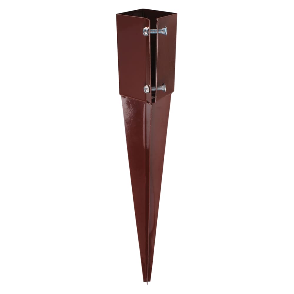

Since the original post is still ok plan is to cut the remaining rot off and still have enough length to use the following pictured metal anchor instead. Plan is to mostly dig out most of the old post so the metal anchor goes mostly in freely then maybe just the final little bit hammer it in just to keep it in and then because it’s thin there’s a lot of space around it to postcrete around the anchor itself.
That won’t work. I doubt if even the type that is intended to be set in concrete would work.
You can buy extensions for spade drills.

Those metal spikes are not good IMHO. Better off digging the whole thin out and either replace the post or better still go for a concrete post.
