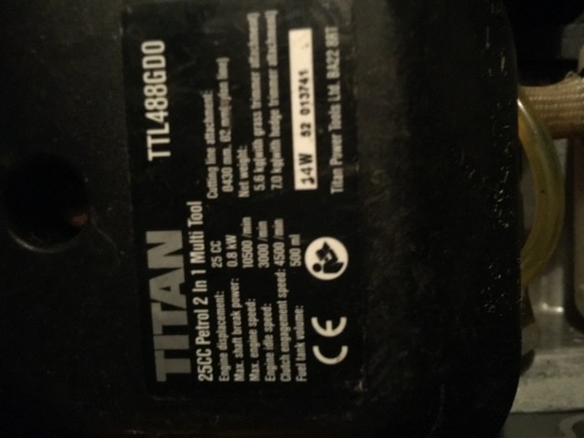

Evening,

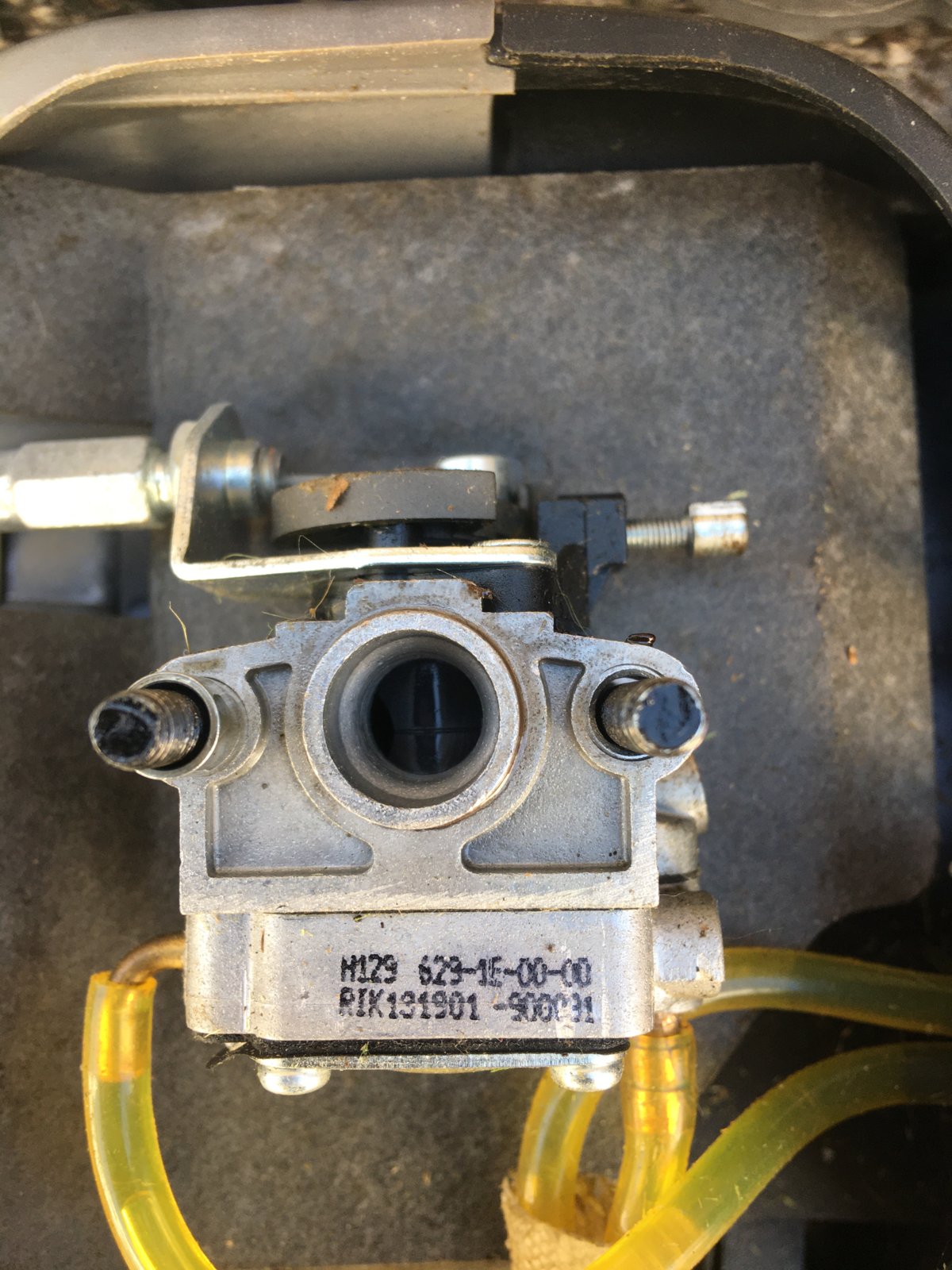

I purchased a like new condition Titan multi tool last year model TTL488GDO.
Its been perfect in its use so far but today I spent some time to keep adjusting the mixture.
The carb fitted has two adjustment screws of which are circular with a little pip in one place so the tool can only fit in one place.
I would turn this screw left until the engine changed it’s fine then I would turn it right and do the same and put the screw in the middle.
This then would run fine but after say 5 minutes it would start chugging/ big down etc and I would need to do it again.
After doing it say 3 times in an hour I turned the screw all the way in then back it out 1 1/2 turns and try there etc.
This above was done after it had warmed up etc.
I don’t understand why I was having to keep doing it so I thought maybe another carb would be the answer ?
Could you take a look at these photos of a carb and advise the possibility of adjusting mixture or is it fixed etc without adjustment.

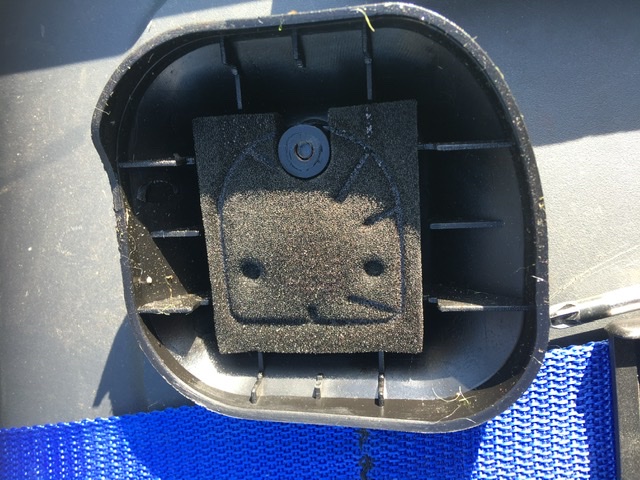

Air filter say 3x3 is new buy might have some oil on it so it will be cleaned.

Don't panic if the air cleaner shows oil deposits - two strokes work in this way and do spit a little bit of the fuel back into the carb.
If its a foam type, just the tiniest oil residue is right.
John :)

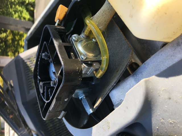

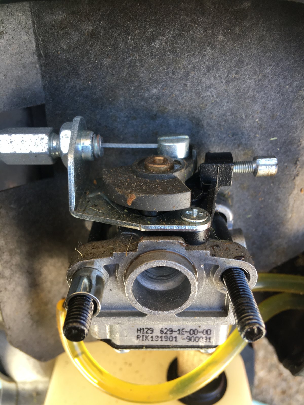

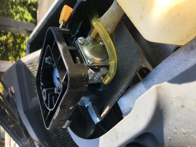

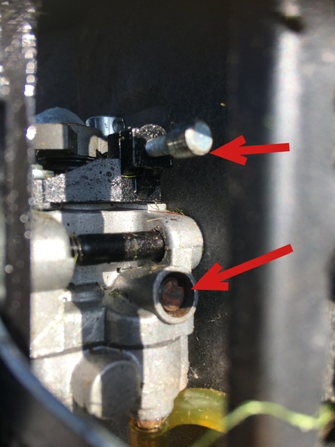

Some photos for you.
Now need to go use it.
Two screws arrowed.
Top touches throttle lever / cable.
Bottom is PAC Man for mixture.
Can you advise how I should set up this mixture correctly.
I assume once cleaned and set up I should be good to go without having to play with it like yesterday.

I have a feeling that the pacman screw is only for the slow running or pilot mixture.....if I recall correctly, this carb has a needle which is attached to the throttle body and that is more or less set.
I'll try to explain. Look down the open carb choke, air filter out. Can you see a round cylinder with a hole in it that turns when you open the throttle? That is the throttle body and there is a needle attached to it which meters fuel out of a jet beneath. The position of that needle is adjustable from the top but its very rarely needed and may need yet another special screwdriver.
Run the engine at a fast tickover, and turn the pacman screw ever so slightly one way or another. The engine should speed up when you turn it in....this weakens the mixture, so turn it back out again until the engine just starts to slow a little....that should now be set.
Another pic of the carburettor where the throttle cable turns the plastic quadrant could help.
John :)

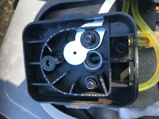

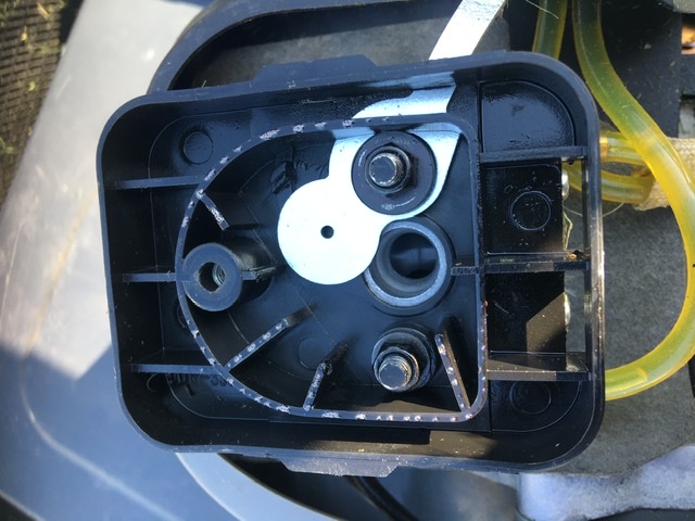

The item is how you say with that cylinder
Body that when throttle operated it rotates thus seeing the cut out appear.
See extra photos.

Yes, at the bottom of that cylinder could be a needle that pokes into a hollow drilling, restricting the fuel supply (designs differ).
On some carbs, that plastic plate the throttle cable pulls on actually rises, pulling the needle higher from the jet.
John :)
