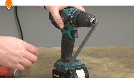

Hello, Can anyone give me a bit of advice?
I have a TITAN cordless electric drill TTP451DDH. It works well – I’m really pleased with it — but the chuck is coming loose: the front end wobbles from side to side by about 3 mm.
I think this is not a uniique problem, so has anyone come across it before?
Any suggestions about how to fix it please?
There will be philips or allen headed bolt down the middle of the chuck, it needs tightening up.
I'd take it out and threadlock it first mind.
Can you see a screw head inside the chuck?
If so, tighten it, but be warned, they are usually 'left hand thread' so you have to turn it the wrong way to the way you'd think!
edit: pipped to it by Keith, good point by him, if it comes undone again, use Loctite.
Don't just tighten down the centre screw, as you're only locking it against the right hand thread of the chuck arbor, and if the cuck isn't completely seated, you're still likely to get wobble or vibration and eventually working the assembly loose again.
Remove the screw completely first, re-seat the chuck, then re-insert and tighten the screw. You might also want to use some loctite 222.
Best way to ensure the chuck is seated correctly is take something like an M10 allen key, lock it up inside the chuck as you would a drill bit for leverage then turn it onto the drill arbor clockwise, then lock in the centre screw counter clockwise (left hand thread)
Thanks Keith, RS and Sammy. Yes, there is a Phillips screw in there. Taking your advice about left-hand thread, I tried with all my might to shift it - either way, but it was stuck completely fast. Unfortunately it is fixed so tight that I stripped the slot in the head, so I'm no closer to a fix :(
The Titan range is supplied by Screwfix, whose Support is rubbish. All I could get out of them was this:
"Unfortunately, the manufacturers of this product (who are based overseas) are not able to supply us with spare parts." There was no advice on what to do...
Fancy selling a range of tools for which there are no spare parts! I wonder what else in the Screwfix range has no spares?
Grrr... :mad:
I've locked a drill up in a bench vise, locked an Allen key into the chuck and forced it until the locking screw sheared off before now.
Just remove what's left with some mole grips replace the screw with the same machine screw and you're golden.

Thanks, but if it's a left-hand thread, I don't have any of those!
If the screw is locked in so tight that the cross-head is stripped, how will a mole wrench get it out?
What could I try...?
You can buy chuck screws on ebay- typically about £3 but they seem to vary from 4 to 6mm
