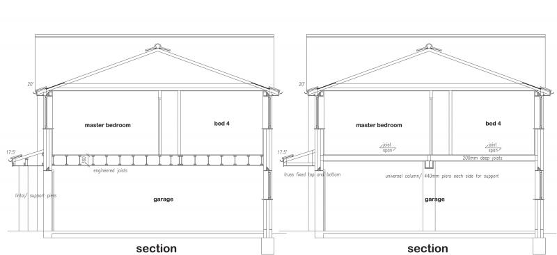

I plan to have a double garage extension made that was 6metre in length with rooms above. I then changed to a 7metre extension as I had the room and I'm told I need to use TJI joists now because of the additional span and this will mean slightly lower ceiling height in garage..
Is this anything to worry about and will it incur more cost.. It was mentioned I could have a pillar, but not rally keen on a pillar stuck in the centre of the garage..

Could I not put a rsj through centre and use normal/smaller joists
Based on a 6mt span, you would have to put in minimum 300mm deep I-joists. Even at that, I wouldnt recomend it, you are going to get spring in the floor once all the furniture is up there.
What is the actual dimensions of your extension ? Can the span not be turned around the other way ?
Otherwise your suggestion of an RSJ to split the span would be a far better option

360mm Deep joists would be at 300mm centres, using the steico brand they only just pass on design. 96% stressed.

Heres an example of joist layout spanning 7 metre.
Also one with engineered column.. not sure if it would be better to change the double garage door to two singles and run the steel beam opposite direction to one shown between doors and split joists, although the beam would cause a low point down to 2 metre, not sure if this would cause me issues, not sure on best solution really... what would others do for the large span..
The beam could be position within the floor void, so you are not loosing so much headroom. The joists then can be supported in top hung hangers off the steel beam.
or....
Get some holes drilled into the web, fit a timber into the web each side, bolt the timber sandwich together trough the web, then use regular jiffys face fixed into the web timbers.
The only niggle within the above solutions is if the steel beam is deeper than the joists. It would not be a great problem but the beam would poke through the ceiling in the garage. You would then fix a batten to the ceiling each side of and parallel with the beam then double board this section of ceiling.
