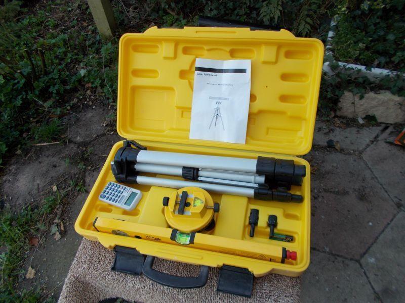

Don't know if this is allowed but I do have a laser level for sale at the moment as surplus, ebay price of £29 not sold due to a timewaster, so if you wanted it for less than this, say £25 I would be happy.
Laser level complete kit (161675999916)
Regards Old_Robin

Thanks Old-Robin, Im probably going to get a self leveling jobbie though, sorry
Yes. This is not self-levelling and hence is only as accurate as a bubble in a sight glass (Spirit level) which with the best will in the world is not that accurate over 5 - 10 metres or more. I use water level on foundations/first courses as I am OCD about it. :) Robin
