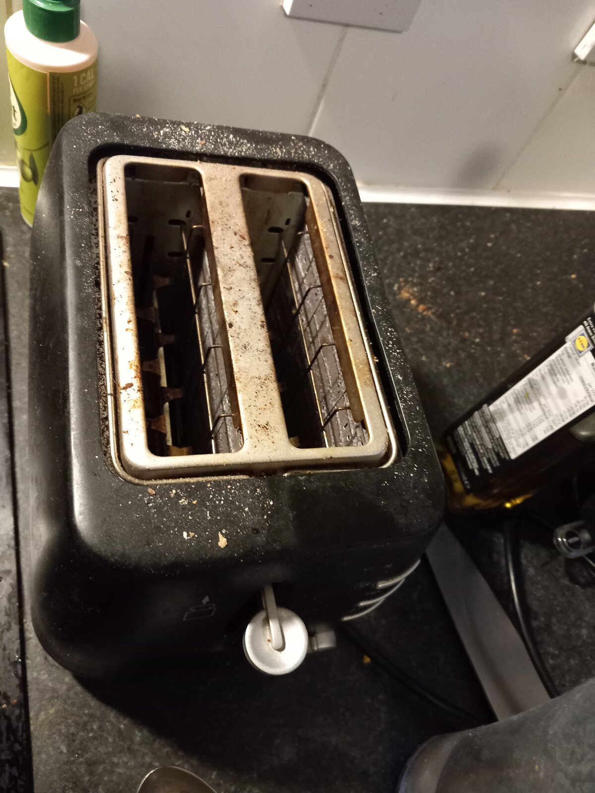

Changed fuse but still not working. Any reasons?

I don't know if it still applies these days, but originally the wire elements used to be 110v each, connected in series so any failure shut down everything.
Does the thing latch on when the handle is depressed?

No, pings back up.

Disassemble it and check the continuity of the heating element with a multimeter. You may even see a break in the wire without testing. Theoretically, replacement wires would be available from china. But people will warn you china parts might cause your toaster to catch fire.
Of all of the questionable advice that I have seen you post thus far, this is surely the most dangerous and irresponsible.
Care to tell the OP which which wires to buy?
Additionally, you might need to tell him which £11+ set of triangular screwdrivers to purchase to fix his £10 toaster.
