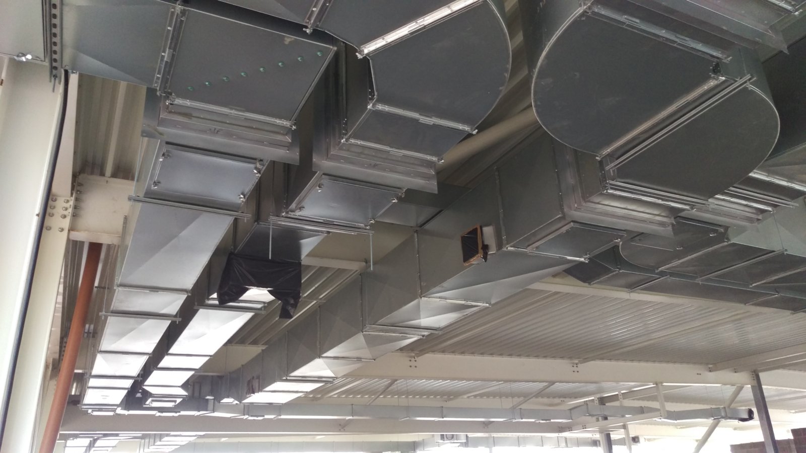

So what. There's a world of difference between a professional installation in a new build with corrugated steel and where the loadings have been quantified by a structural or ductwork engineer and a DIY installation in an existing kitchen wall made-up of unknown plasterboard materials. The point was that it's the PLASTERBOARD which is likely to fail
Calm down mate, no one's trying to take your glory. Just pointing out it's not the toggle that won't take the weight. You should have worded your original statement more inline with this.
