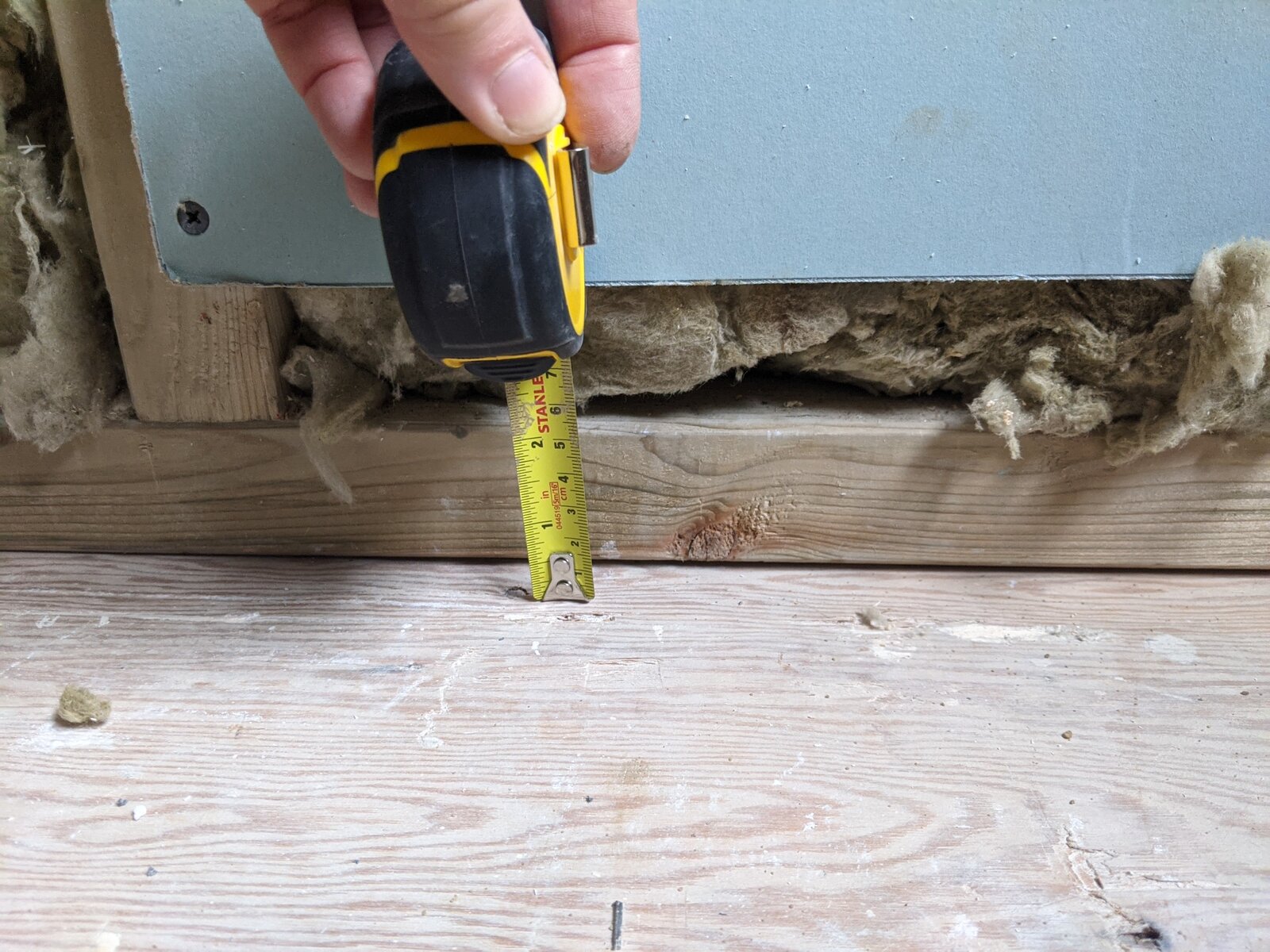

I have another potential issue now too (!) I know I should leave a bit of a gap at the bottom of the plasterboard on the stud partition wall so it doesn't get damp if the floor does. By the time I've got all the layers on the floor (underfloor heating, tiles etc) I'll be halfway up the 2x4 I used for the sole plate. If I then leave a gap, the insulation in the middle of the wall will be exposed! Or rather, not exposed but only covered by the skirting board. What to do??
