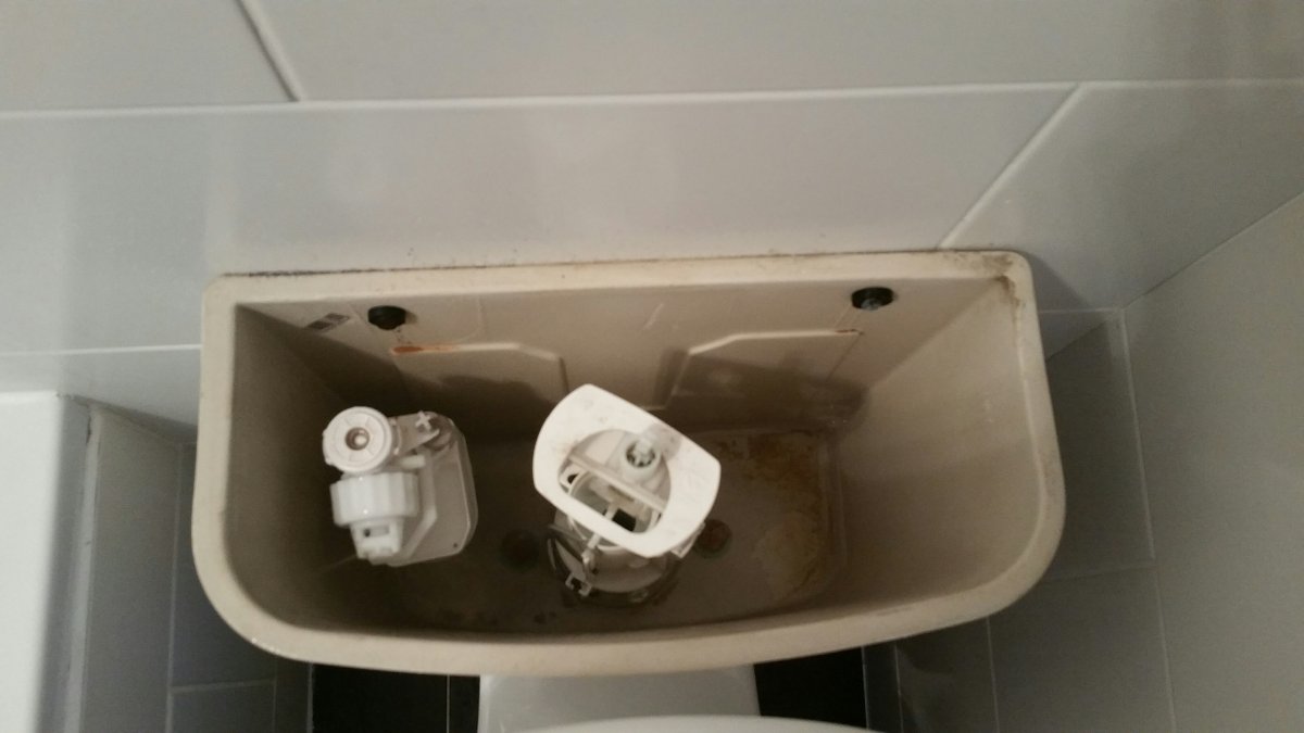

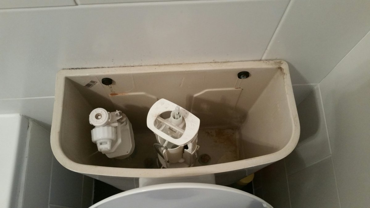

Push button toilet been playing up.
Cistern to fill up but seem very slowly. Once full, I am able to flush properly.
Watch videos on you tube, but not sure where where to start really.
I have attached picture of the cistern open.
Any tips on where to start and what to check please?
Many thanks,
Float valve is knackered. Either fit a new washer (but the SIAMP ones aren't the most reliable things in the world) or chuck the whole lot out and fit this
On the contrary, SIAMP are most reliable.........they're guaranteed to split a washer on an annual basis :LOL:

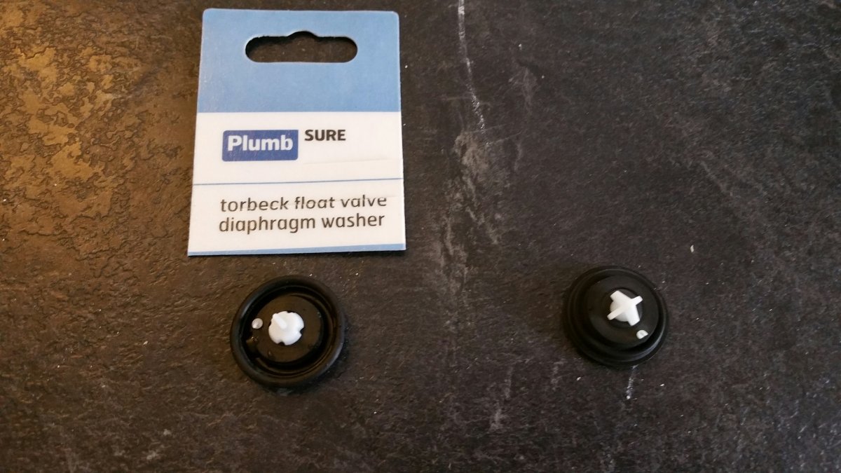

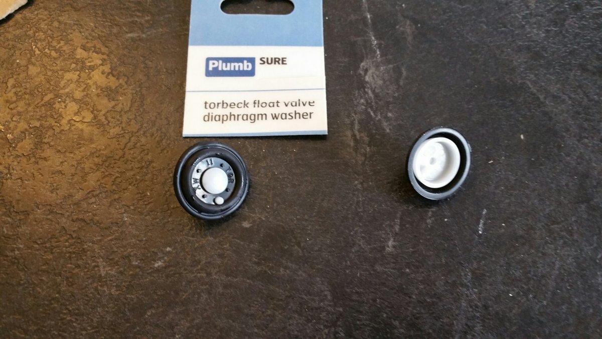

Hi Keego,
As I was watching that Video,
, I realised that the item bought was slightly different.
See picture.
I was not sure which side to put it back last night but with your comment this morning, I try to put the old one back one and realise that the product bought is not suitable - as when putting the old one back on, then it does the pressure things.. water leaking from the broken seal, but when playing with level, it then does stop to fill.
Hurrah!! we are progressing! Shame on B&Q!!!!
Found a trade shop locally,
http://www.plumbers-mate-sales.co.u...phragm-ball-valve-washer---72000172-668-p.asp
Hopefully, I can get it from there.
Otherwise, do you think that item is suitable? as can collect from argos and get pack of 3 for the same price?
http://www.ebay.co.uk/itm/2-5-CISTE...442212?hash=item20df8beaa4:g:vfkAAOSwU9xUQ6Ji
Thanks in advance,
