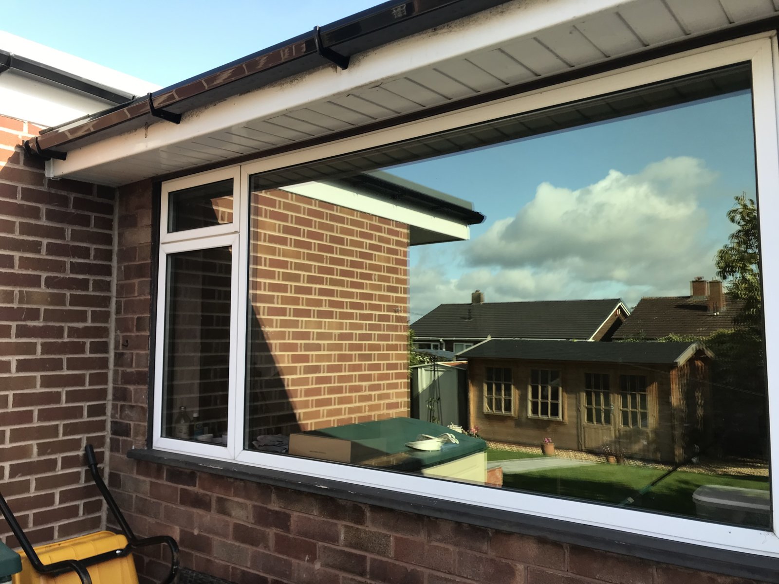

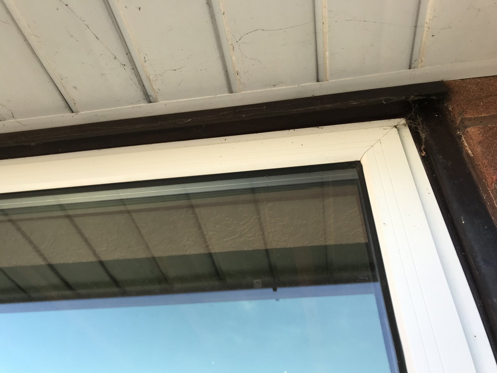

So I am looking to replace bedroom window in our bungalow.
The existing window is aluminium casements in a hardwood frame.
When I was measuring up I discovered that there is nothing above the hardwood frame its just covered by the roof facia. The wall finishes at the same height as the top of the frame.
Can I just replace the window and leave the top of the frame standing alone as it does now?

The sub frame wont be supporting anything -Id be surprised if there was nothing above for it to be screwed to.
There must be some form of lintel or wall plate to take the rafters / ceiling joists.
That doesnt particularly matter for your survey.
Most sub frames are rebated, so is you want to replace with aly, you would need a frame with an odd leg that fits.
I should think there will be a steel lintel over the window at the eaves ,IG profile lintels can be quite shallow.
The internal wall (Thermalite ) has a concrete lintel on bricks (like a pad stone) and the wall plate is over that on a mortar bed.
The ceiling is down in the room so I can poke an iphone over the wall plate into the void above the facia and it looks like it’s just the top of the window frame there.
So it looks like the internal wall is taking all the weight of the roof.
The outside wall isn’t holding anything up and stops for the width of the window.
Can this a valid setup? Should we be worried?

typically a a pitched roof is supported on a wall plate which is fitted to the inner skin -where a window is directly below it would be expected to have a lintel of some sort as the wall plate is designed for fixing the roof timbers to, it isnt designed for supporting any load unsupported.
My guess is the that the sub frame is fixed to the back of the wall plate -either with brackets or a timber batten.
the fact there is nothing directly above the window frame or above the external skin doesnt matter....the fascia is fitted to the rafter plumb cut.
We trap a piece of 4" X 2" (flat) above window openings so that the window fitters have something to fix to and it makes the soffit cradling nice and solid.
Yes. No.
When the extension was built the lintel extended from the internal to the external, it was a Catnic lintel. Also the bungalow across the street has two rows of bricks above their window. These are the reasons I asked about the setup, however, its been explained very well here so thank you to all who helped allay my concern.
