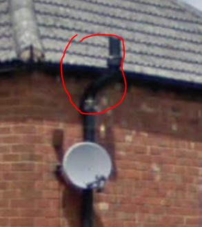

    Not sure of the correct terminology, but yesterday this piece circled fell off..
    I presume it bends around the gutter so that any toilet-related fumes go up into the air and not under the roof into the attic.
    How urgent of a problem is this, or is it not even a problem at all - I had a walk around the block and at least 10 other houses just have the pipe ending under the roof so must have had their S-piece fallen off as well.

    Is it plastic or iron?

    Could be asbestos with those big collars on.
    It’s not urgent. Mine ends at the junction where the toilet joins, it’s on the to do list.

  5. chrisw99
    chrisw99
    Joined:
    5 Apr 2004
    Messages:
    157
    Thanks Received:
    13
    Location:
    Cheshire
    Country:
    It's asbestos cement.

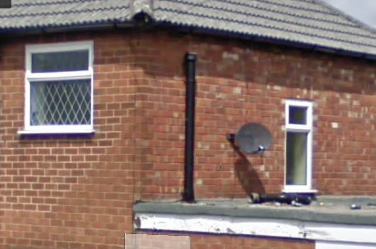

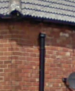

  6. chrisw99
    chrisw99
    Joined:
    5 Apr 2004
    Messages:
    157
    Thanks Received:
    13
    Location:
    Cheshire
    Country:
    Here's a house 5 doors down...
    That was from a streetview image 10 years ago, and it's still like that today, so I guess I don't need to worry. I counted at least 10 other houses like this, so I guess snapping at that joint is a common problem 50 years on...
  7. Nige F
    Nige F
    Joined:
    28 Jun 2005
    Messages:
    20,422
    Thanks Received:
    1,571
    Country:
    2 caveats : 1 they don't hit anyone, 2 no one knows it's asbestos/cement:eek:

  9. chrisw99
    chrisw99
    Joined:
    5 Apr 2004
    Messages:
    157
    Thanks Received:
    13
    Location:
    Cheshire
    Country:
    It's a good job it didn't hit anyone, I could hardly lift the piece that fell off it was that heavy.

  10. Hot&Cold
    Hot&Cold
    Joined:
    16 Jun 2017
    Messages:
    1,539
    Thanks Received:
    272
    Country:
    once had the job of replacing all the asbestos cement soil pipes on a council estate after a few swan neck bends parted company.They were described as an accident waiting to happen (n).
    chrisw99 If there are no foul smells in your loft,it can be left alone (y)

  13. chrisw99
    chrisw99
    Joined:
    5 Apr 2004
    Messages:
    157
    Thanks Received:
    13
    Location:
    Cheshire
    Country:
    Just noticed on the streetview image from 5 doors down, you can actually see the bit of soil pipe that fell off still on the garage roof ...
    So when the regulations say within 3m of a window, is that on the same wall face or does the bathroom window on the front count?
