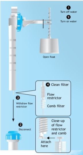

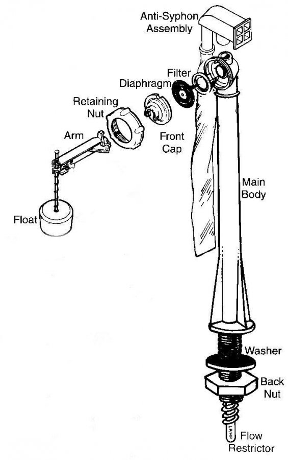

I've found two conflicting images, I think they're of slightly different units, mine is the one with the bag on the back, as per the bottom image, one shows the restrictor with the "pointy end" pointing upwards, the other the opposite way round, please help!

I doubt it matters much, normally those sort of gizmo's have a plain "handle" bit at one end to grip with pointed pliers when removing (unless it falls out! :LOL:) I would put the worm in holding the handle myself.

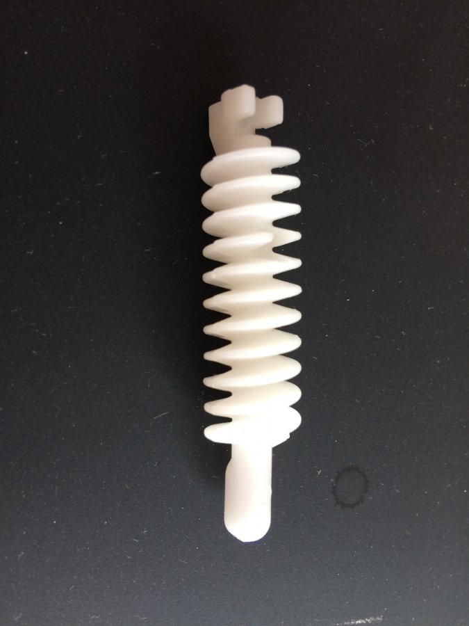

Thanks for the info, just FYI I've just taken a photo of the offending item.
So from what Footprints has said, and from the second diagram I posted, it looks like the pointed/handle end should point downwards (the opposite to the first diagram I posted, but that seems to have some sort of filter comb), but I did wonder if it'd make much difference....
